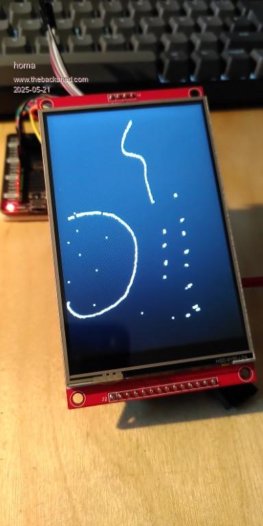

Posted: 06:42pm 20 May 2025
So my display works right away thanks to the tips on J1 and the diode.
However, I have noticed that ghost dots appear when I touch the screen. Circled by me in the picture. But I only painted on the right side of the touch. Except afterwards the circle for marking ;-)
Does anyone else have the same problems?
Matthias
Posts: 3448
Posted: 09:25pm 20 May 2025
Many screens do that with GUI TEST TOUCH, especially when touched near the edges of the screen.
However they give the correct coordinates with Touch(x) and Touch(y) functions.
Adding a delay reduces the number of random dots.
> cls:Do:circle touch(x),touch(y),2,1,,,rgb(white):pause 1:loop
Edited 2025-05-21 09:21 by phil99

Joined: 05/11/2021
Posts: 775
Posted: 04:29pm 21 May 2025
Unfortunately, this is not the solution. The ghost dots appear if you don't press hard enough with the pen. Sliding lightly over it causes many of these dots to appear. With relatively firm pressure, it only happens when releasing (like a key bounce, only with offset).
