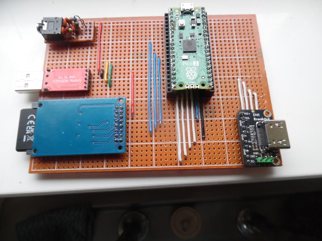

Posts: 2807
Posted: 01:55pm 25 May 2025
  phil99 said
  Quote   strange characters when I type in win to mmcc.
That usually means the baud-rate is wrong. As USB versions use a USB / TTL converter, after a re-flash the Pico will default to 115200 baud. Make sure MMCC is also set to 115200 baud.
You don't get this problem with the non-USB version as then it is a "virtual serial" link, there is no actual TTL being used so the baud-rate doesn't matter.
strange as I got another pico2 usb hdmi but on vero and defaults to 115200.
note it's v6,00.02b0 and I can't find the download.
it has OPTION CPUSPEED (KHz) 315000 but that's not allowed with hdmi now and the same graphic program seems slower on olimex
I had similar problems with usb keyboard and weird chars cos the kb always turned numlock on

Posts: 2807
Posted: 02:55pm 25 May 2025
I'll order new usb to ttl boards... usb c ones
my hdmi usb and vga usb boards are powered from the usb to ttl adapter no probs.
Edited 2025-05-26 01:02 by stanleyella
Posts: 2807
Posted: 04:17pm 25 May 2025
Mick your right I guess but I'm as vero as you are pcb
as not used olimex I think I broke the usb to ttl by using it for powering olimex, forgot it needed own power
point is a new user won't need a soldering iron.
why don't I learn if it's not broke don't "fix" it??
Edited 2025-05-26 03:03 by stanleyella
Posts: 9210
Posted: 04:48pm 25 May 2025
Well, I've done you a vero design now. It even fits into a case. :)
Try just plugging the USB-ttl adapter in by itself. Then check that (a) it's LED lights up and (b) there is 5V between its GND pin and 5V pin. There should also be 3,3V from the internal regulator on the 3V3 pin. If you aren't getting the voltages then look for a "large" SMD packege on the board. It will probably be marked 05 or something like that. It's a fuse. You should see 5V on both ends. If you don't then it's blown. It is possible to replace them but it's hardly worth it. I wouldn't recommend shorting it out as it protects the USB port of your computer...

Posts: 2807
Posted: 06:04pm 25 May 2025
Mick the 3.3v and 5v are not to be used but I've used them no prob so dunno.
on vero I used a hdmi breakout with smd resistors. wiring vga not hard but hdmi. l8r
same hdmi breakout?
Edited 2025-05-26 04:19 by stanleyella
Posts: 9210
Posted: 06:22pm 25 May 2025
You may not be using them but it will show if the chip is getting power and if its regulator is working (in which case it's unlikely to be faulty as it's on the same bit of silicon). The 3V3 output on these is pretty limited. You can't really do a lot with it.
I recognised the Adafruit board. :)
For VGA you connect 6 wires plus GND.
For DVI/HDMI you connect 8 wires plus GND and 5V.
It's hardly a big step. :)
Neither connector is vero friendly.
Incidentally, the fixing centres of the Adafruit board are the same as a D9 socket (or VGA). I did a design where the video socket is mounted upside-down on a little carrier board. That plugs into a row of male headers that go to the HSTX pins. The VGA and the HDMI both have their own resistors on board, so you can just swap the video module, change the firmware and you have a different machine!
