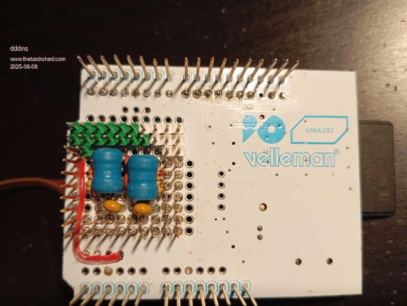

The simple resistor-capacitor PWM filter is actually very poor. It will extract audio, it's true, but the frequency response is poor and at the top end there is virtually no reduction in the 44kHz carrier signal that the PWM uses. That means that it makes a mess if you feed it into a decent audio system - and it's quite possible that it could damage some tweeters. Volhout's filter cuts off sharply at the top end, removing almost all the carrier frequency. It's worth using even if it means buying a few cheap components off ebay or AE.

Thanks Mick for that info, I got the coils and capacitors to build Volhouts version.
Next for me is to get the sdcard and system spi running, as well for i2c and the ds1307..I know poor chip :)

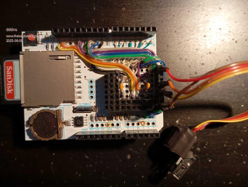

This is my work of today. SDcard, i2c/RTC and audio working:
Up to now I didn't touch the logger shield, it runs with 5V and a level shifter..
And I implemented @Volhout's audio filter:

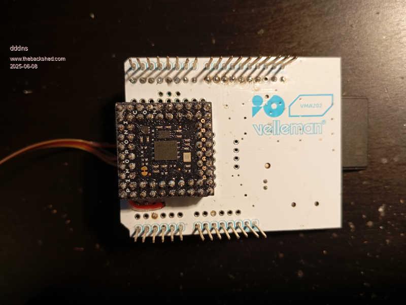

Posts: 6286
Posted: 07:31am 08 Jun 2025
Impressive and compact.
There was just enough room to put the pga.
But this is not doable for the average shedder.

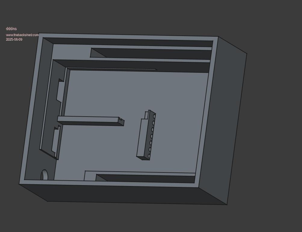

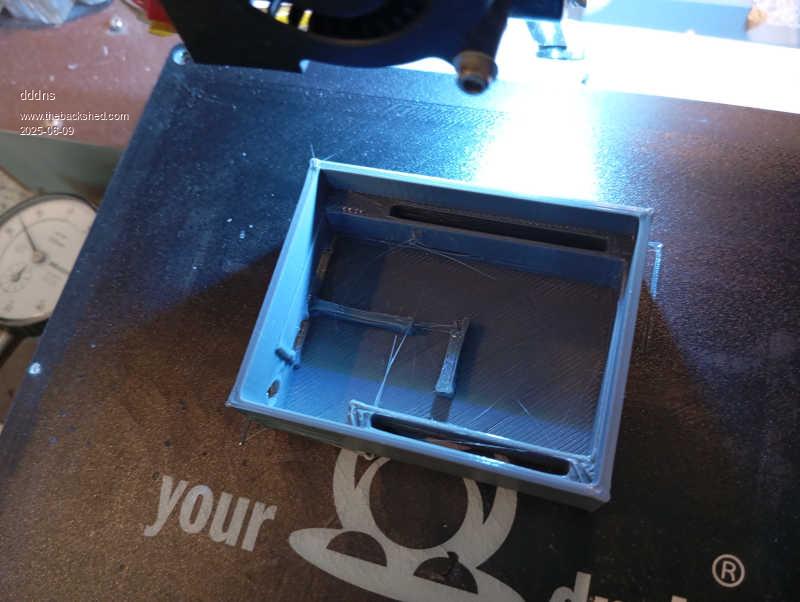

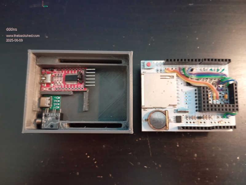

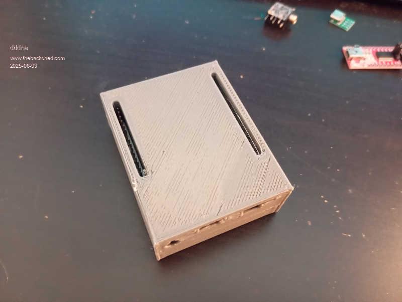

Hello :)

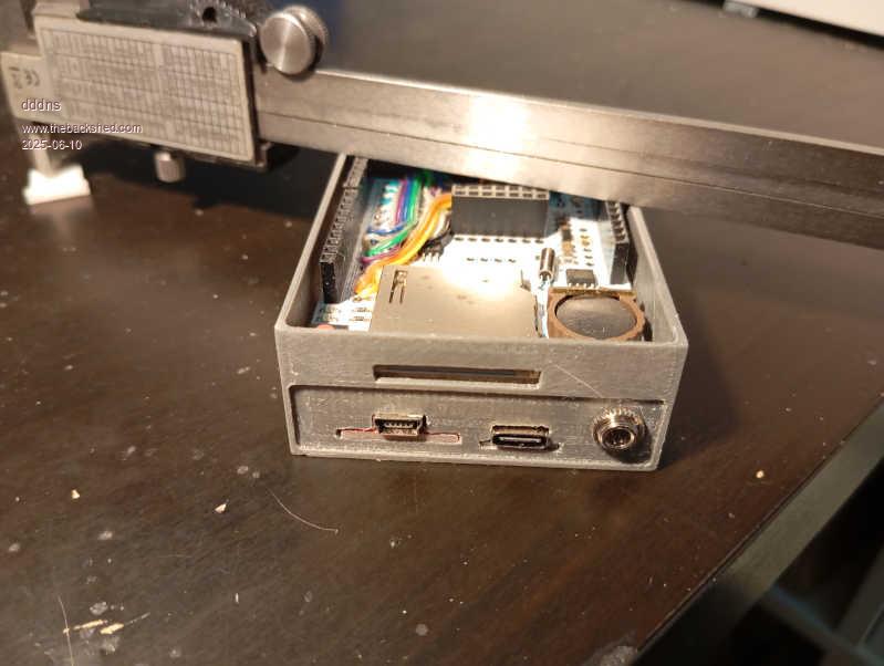

The last components missing are USB/UART, USB for the Pico and an audio socket.
Now I take it as challenge and will not modify the board and need something to mount the missing parts. I took Freecad and designed a housing:
housing1.zip
Last material I have is PLA.. very ugly in every way, what can I do..
I can only estimate how much it also shrinks, a pain
After some Kg printing I about know now..it fits well :)
It can have a docking whatever :))

Posted: 04:24pm 09 Jun 2025
Thanks Mick. Three things left to be done, to fit in the new parts and build the uplink to the board. Then the labeling with inkscape  and acrylic covers. Let's see, at least three days of work, I hope by next weekend.

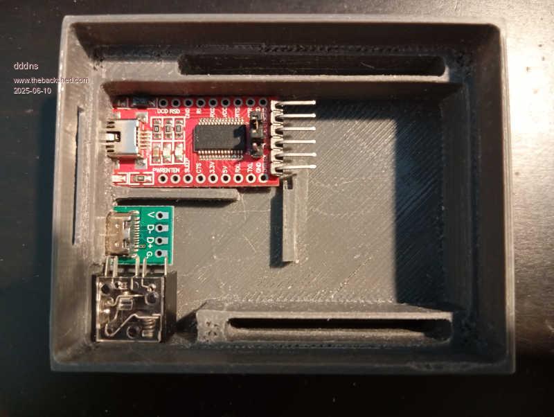

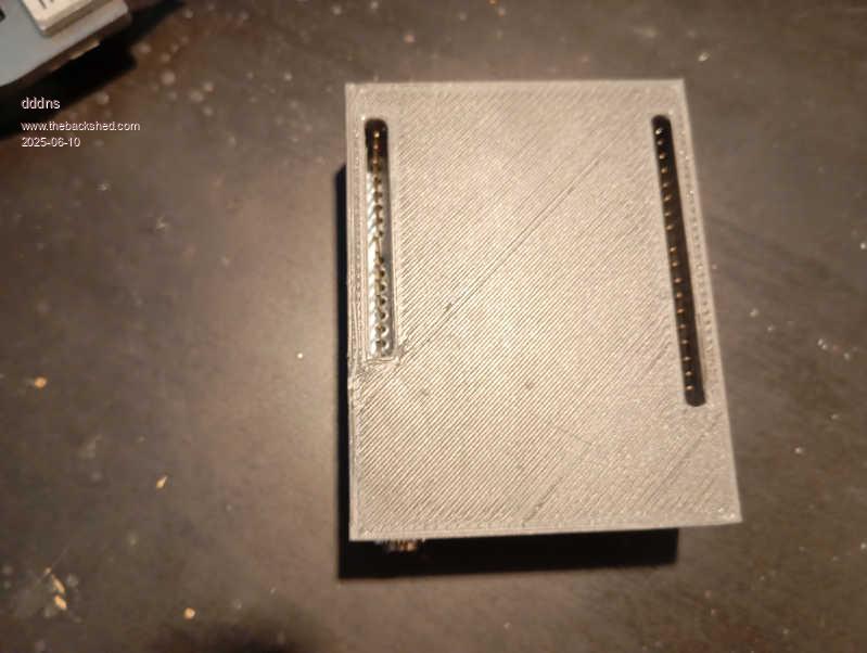

Hello :)
I have a little toy mill I use for (retro)fitting and this is the only tool
I will use to finish it. Everything is handmade and just in time, this morning:
Cleaned the print and went over all planes which I want to have "precise":
Leveled everything and milled a 0.8mm deep pocket:
The "docking pins" are 1,5mm below:

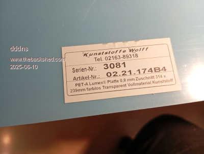

And this material for covering, it's PET and does not break. It can be cut with scissors or a cutter knife:

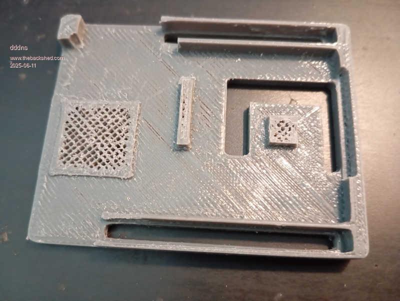

Hello :)

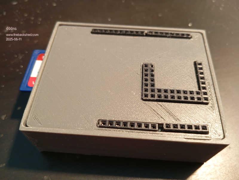

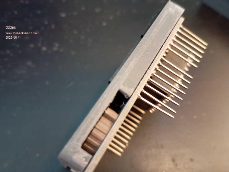

Today sun is shining and I'm not so motivated. But carpe diem and I designed an inlay:
Again, cleaned it with the little mill:
and fitted it in. Another pocket of around 1mm is created:
The inlay is 7mm in heigth:
dddns

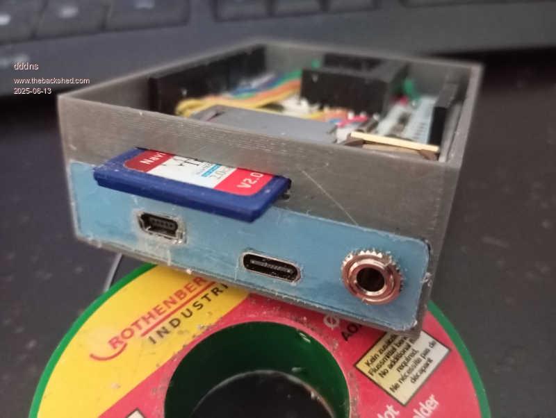

Posted: 06:05pm 12 Jun 2025

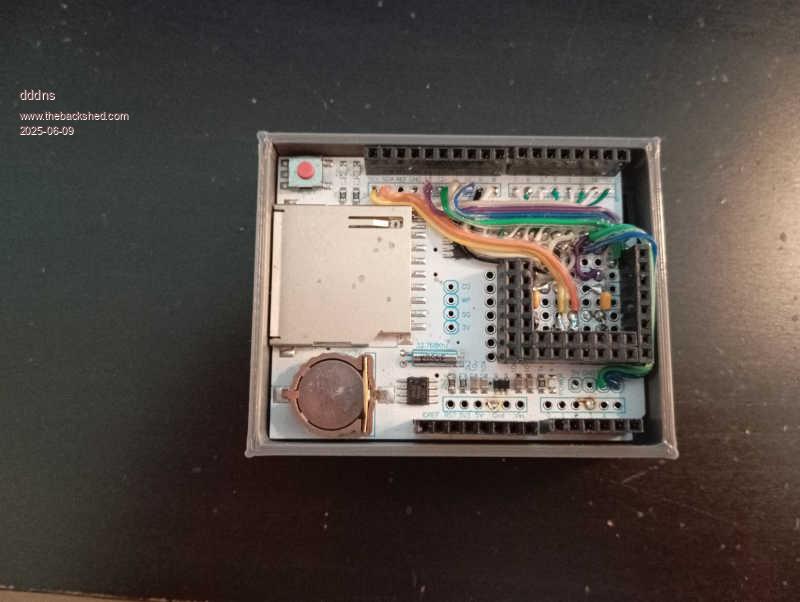

Good evening!
I need to get this done now..enough is enough of tinkering now.
I would like to look into HDMI so I clenched my teeth.
First the PET:
Then the inner wiring and on the board:

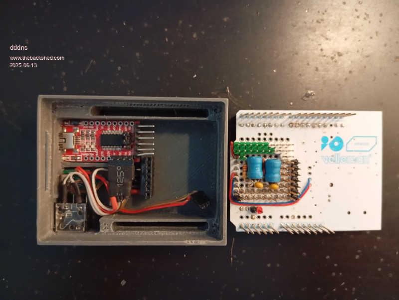

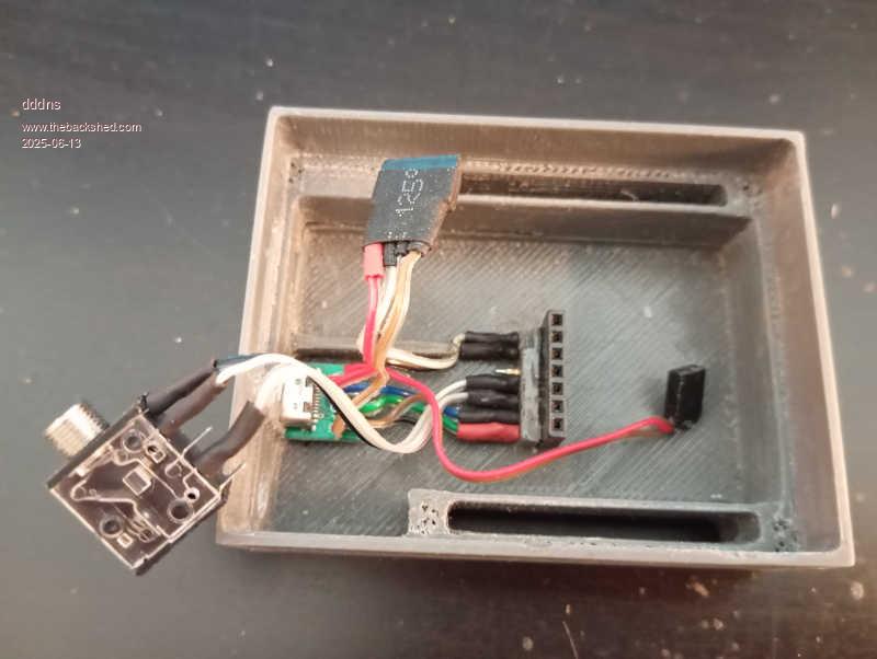

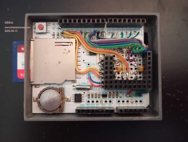

Finished so far, maybe I will move GP1(SD CS) to GP10 later:
Multilayer :))

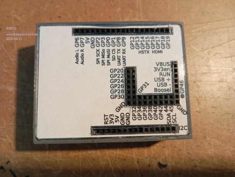

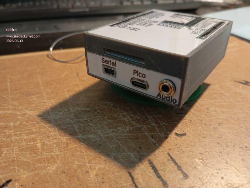

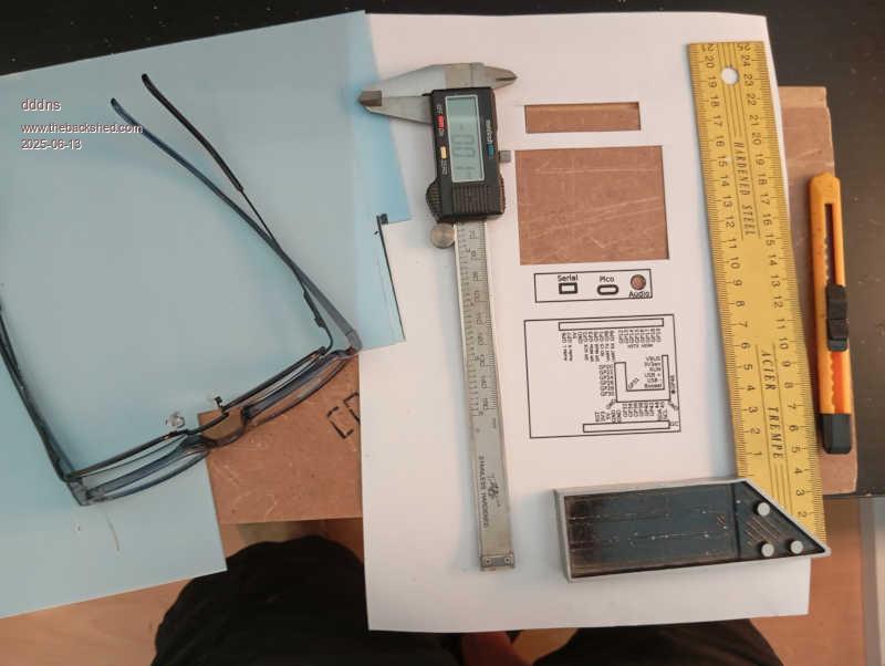

Hello All :)
I've exported the inlay from Freecad as .svg to Inkscape. Now it's easy just to position the labeling around. Only need to setup a linefeed of 2,54mm and just write it down on each row. Then I printed the first drafts on white paper and made sure everything fits.
For the cutting and tho whole process I used nothing but:
And two hours of concentration and patience:
In this very close up it looks so lala, but in reality you don't see much of it:
