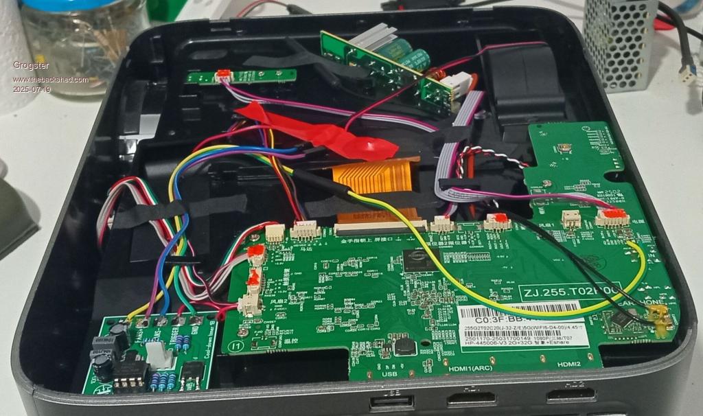

Posts: 10063
Posted: 05:35am 19 Jul 2025
All done, installed and most importantly - working great!
This is version 1B of the cool-down PCB, and I switched the 555 for a PICAXE 08M2.
This was because while testing on the bench, the 555 would not reliably keep the fans on.  Sometimes it would, other times it would shut them off after about 10 seconds instead of 60 or so.
Anyway, it was easier to just plop a PICAXE chip in there, cos then I could easily adjust the cool-down time in code without having to pull parts.
Those who look carefully, might note that the design of this projector is good enough, that they have not just buried the LCD in the guts requiring a full disassembly to get to it - note the little plastic clips on the top of the LCD(one on right of image covered with IDC cable and black tape holding wires down) - you can release those, disconnect the FPC cable, and pull the entire LCD up and out of the optical assembly.
Very nice design.
About the only thing missing, was a cool-down timer on the mainboard.  Perhaps I could suggest it via email with this photo and thread as a bit of evidence?  Would they even care though, that's the thing.....

Posts: 10063
Posted: 07:17am 12 Aug 2025
Hello.
The 8-pin PICAXE is perfect for simple stuff like this, and is small and easy to design into things.
1) I use the AXE-027 USB cable/programmer thing.  It is easier and less trouble to use the PICAXE-supported USB cable thing, then trying to use other generic serial programmers.  I have had ZERO issues using the PICAXE programming cable thing.
2) It can be programmed for ANY time period you like.    That is a simple change in the code, and so you can have cool-down periods from 1 minute to whatever the PICAXE supports.  If you want 3 mins, just change 120 to 180 in the timer loop.
3) Sure.  Here is a copy of the CURRENT code, but you could change this to whatever you like.  Would you like the Gerber files for the PCB?
