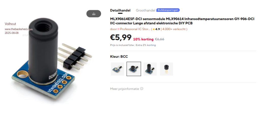

In an earlier post I gave a small preview of a Game*Mite in combination with a thermal sensor.
This sensor is a single pixel IR sensor with a very small opening angle (6 degrees).
Usefull measuring temperature of small objects (SMT components on a PCB, or a glow bulb in the ceiling). It is not a multi pixel camera.
The sensor can be purchased for few euro's on Ali.
With 4 wires you connect it to the expansion header on the Game*Mite (GND/GP16/GP17/3V3). It communicates I2C.
The associated Game*Mite program is this:
2025-08-08_070747_mlx90614_gm3.zip

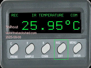

The Game*Mite shows something that looks similar to a FLUKE reference temperature meter. Which this (obviously) not is....;-)
The software displays degrees C/F/K, can output the data on the USB(console) port, and can record on the A: drive.
Navigation:
Left and Right buttons move the focus
B select the top function
A selects the bottom function
The functions MENU and ENTER are not implemented yet, but could be used to change the file name of the log file on A:.
P.S. for the record, this is running on 6.00.03 dated 7-7-2025
