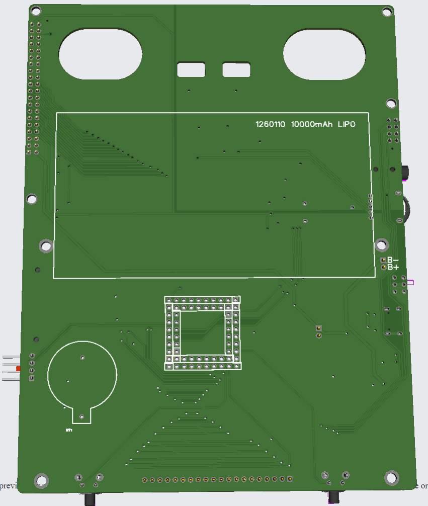

Posts: 12110

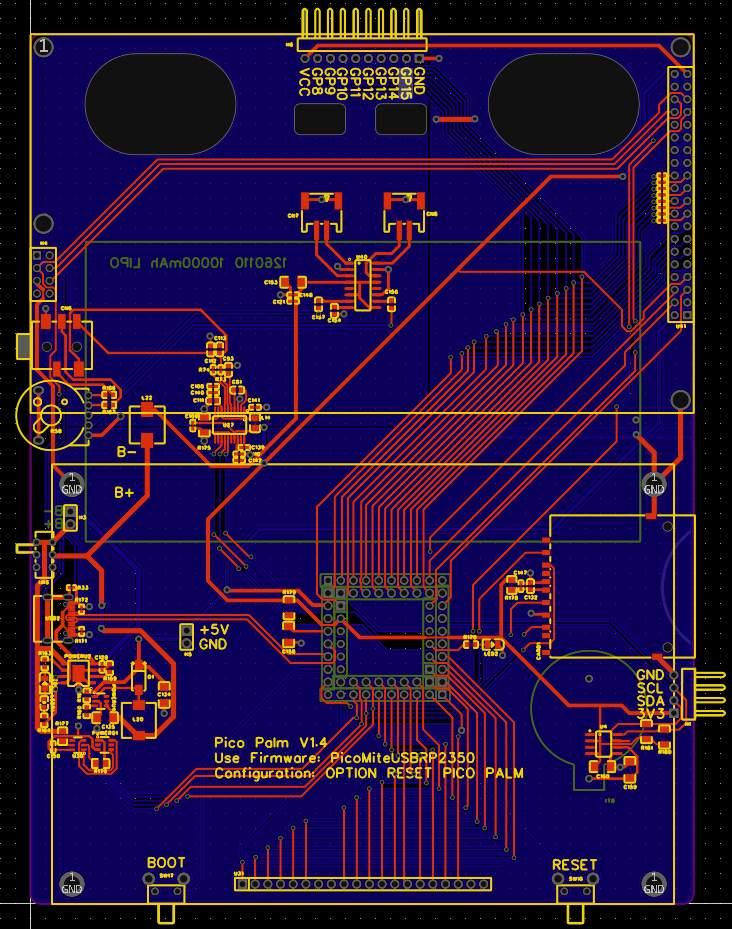

Posted: 01:19pm 04 Sep 2025

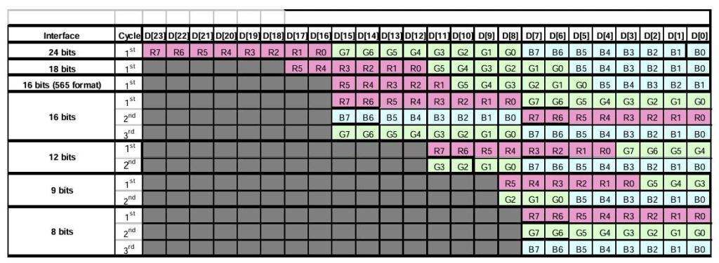

Here is the layout for the new design. I'll get some blank PCBs made which will allow me to do the development of the new drivers. The SSD1963 supports 8, 12, 16, 18 and 24 bit transfer modes. Between them they support RGB565, RGB666, and RGB888. So I can have a play to determine the optimum mode that achieves the required performance but with the minimum pin usage - 12-bit mode looks interesting.
The PCB is 174x133mm and by using a 1260110 lipo it should be possible to keep the thickness down to about 30mm with a 20hr plus battery life.

Posts: 9288
Posted: 03:08pm 04 Sep 2025
I'm not sure which version of the SSD1963 that is, but doesn't it put a fixing hole right through the volume control? It might be ok, but I was just thinking - for ruggedness of something portable.
Just a thought, and probably too complicated now. If the SSD1963 obeyed the CS line it might be possible to multiplex a keyboard on the same data bus, although you'd need to buffer the keyboard data somehow.

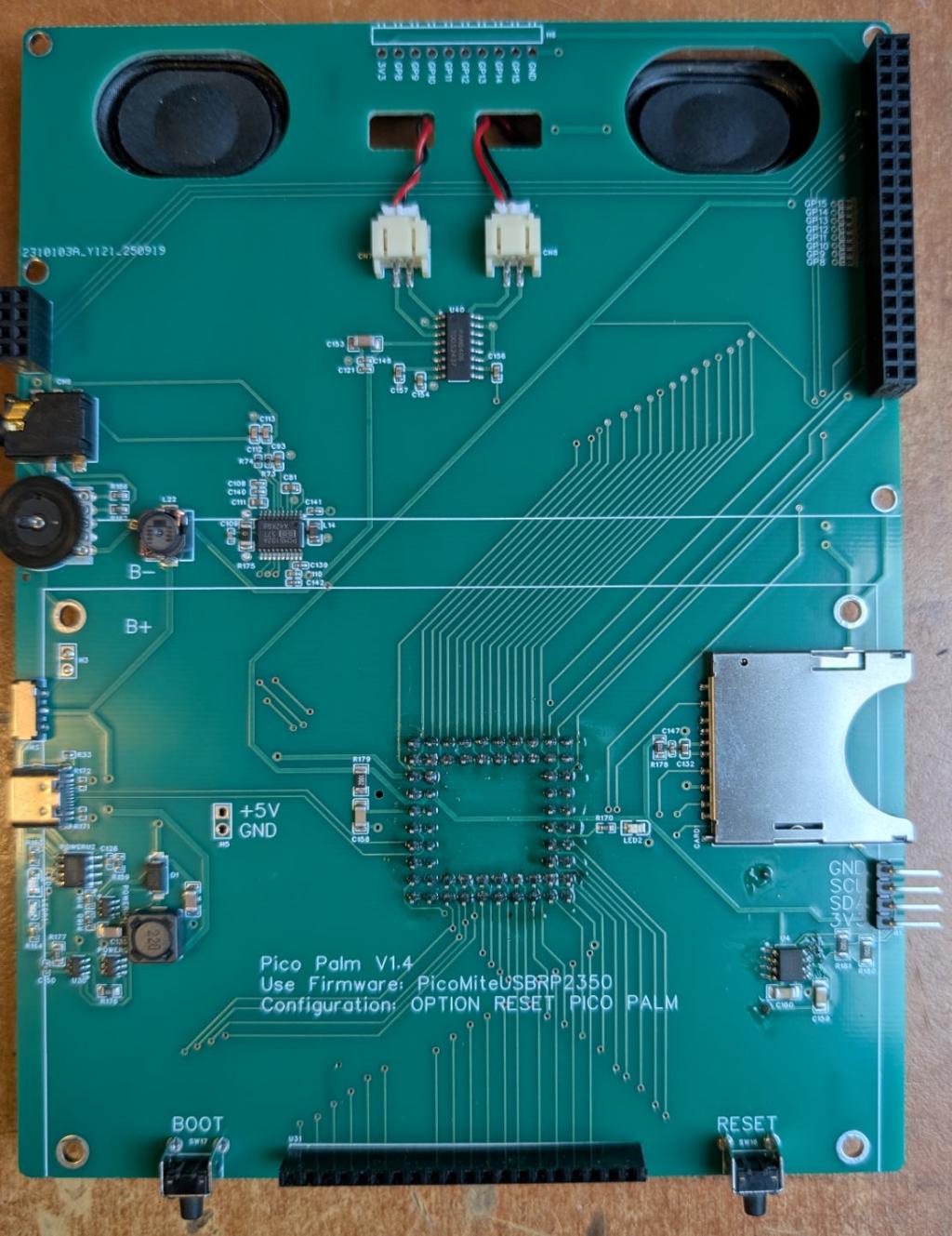

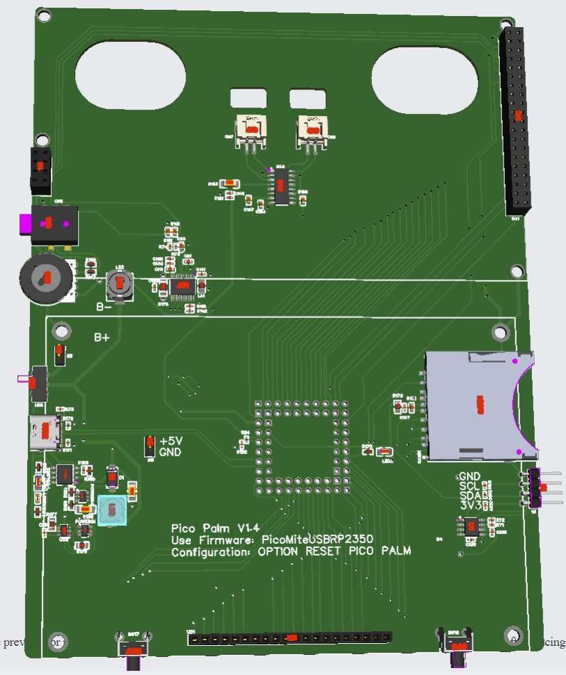

Here is the version I'm getting made. 10 pin header at the top, GND, GP8-15, VCC + solder jumpers to the DB8-DB15 pins on the display.
I'm getting them unpopulated to keep cost down but that will give me all I need to develop and test the various options for the display driver with reliable connections.

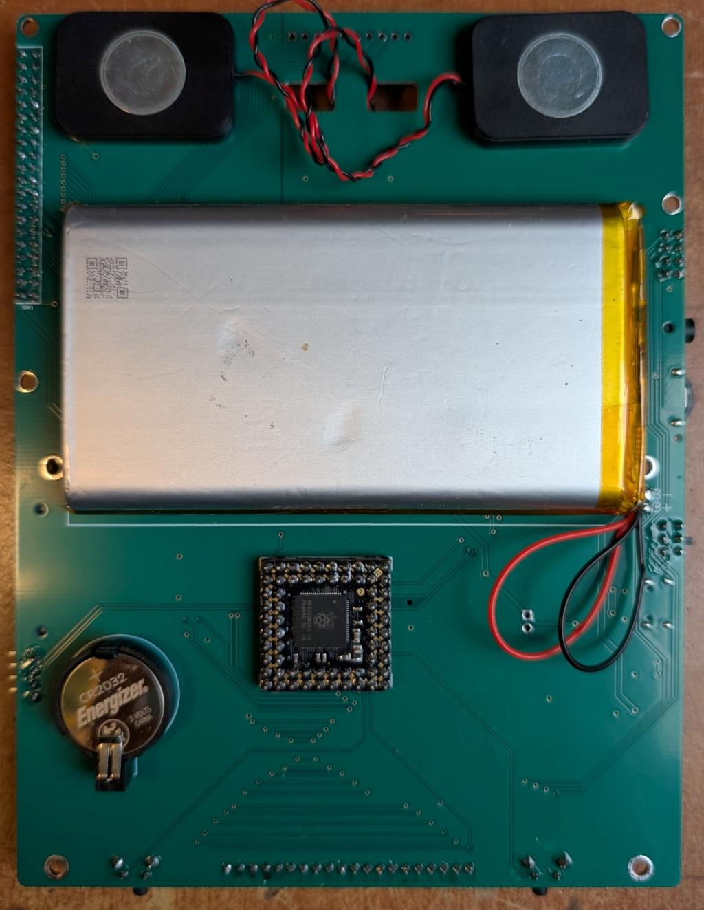

Posts: 12110
Posted: 07:06pm 04 Oct 2025
Things are looking good. I've got the final PCB layout in and everything works as expected. I've been tuning the screen driver and am getting incredible update rates - full screen draw in 0.2mSec.
I've decided that rather than making a box I'm going to go for a PCB sandwich. Top layer with cutout for the screen and keyboard. The main PCB with the keyboard PCB mounted off it and then a blank back PCB. The final assembly will be 174x137x30mm.
The unit uses 460mA running gui test lcdpanel and playing an mp3,  10000mAh Lipo for power which should give a run time of around 20 hours on battery.
Here  is a brief demo of it running Petscii - unfortunately I don't play games and have no idea what I'm supposed to do to play but at least you can hear the sound and see the graphics
Top PCB overlay
