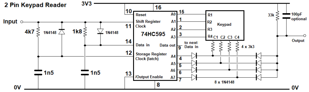

Posted: 02:50am 18 Feb 2026
Using the MMBasic Keypad command requires 8 pins for 4 x 4 keys.
A 74HC595 and a diode/resistor matrix can read the keypad using just 2 MCU pins.
A DOUT scans the keys via Bitstream and a Interrupt Sub reads the pressed key.
As with the previous version the rows are driven by idle low outputs.
Inverted logic is used to read the columns via diode-resistor logic. Switching the columns is done by more idle low outputs.
For more than 16 keys more 74HC595 chips can be daisy-chained. 2 give up to 64 keys and 3 up to 144.
Testing was done on a PicoMite MMBasic RP2040 V6.02.00 @ 200MHz and 378MHz.
Time taken to read a key (@ 378MHz) and return to the main loop is about 5mS for Key 0, varying up to 10mS for Key 15.
It varies because it stops scanning when it finds the key.

And the circuit diagram. The Bitstream pin goes to the input and the output goes to the INTL pin.

Edited 2026-02-18 16:49 by phil99
Footnote added 2026-02-26 12:34 by phil99
A version for the MicroMite Mk II.
The changes account for the lower CPU speed, lower logic threshold voltage and lack of Bitstream command. Tested at 40 and 48MHz. If there are too many button errors replace the 4 output diodes with Schottky types as the forward voltage of regular diodes isn't much less than the logic threshold voltage. Added to that is the voltage drop on the 1k5 resistors, leaving little headroom.

Footnote added 2026-02-26 21:34 by phil99
The intention was to have the code cater for more than 4 x 4 keys but one line in the column search loop limits it to 8 outputs. Here is the corrected version, 255 (2^8-1) is replaced by 2^(Rows+Cols)-1.
  For C=0 To Cols-1 'find the active column on the active row
    HC595 OutPin,Rows+Cols, 2^(Rows+Cols)-1-(1<<C+4)-(1<<R)
    If Pin(InPin)=0 Then Exit For
  Next

For the 160MHz MicroMite Plus the times could be reduced to something close to the PicoMite by reducing the data and latch time-constants and with corresponding adjustments to the pulse times in the HC595 Sub.
 For n=0 To N.out 'prepare data timing array
   B(n)=(11-(Dat>>(N.out-n) And 1)*6)/1000 'low data pulses, 11uS=0 ,5uS=1 (=11-6)
 Next
