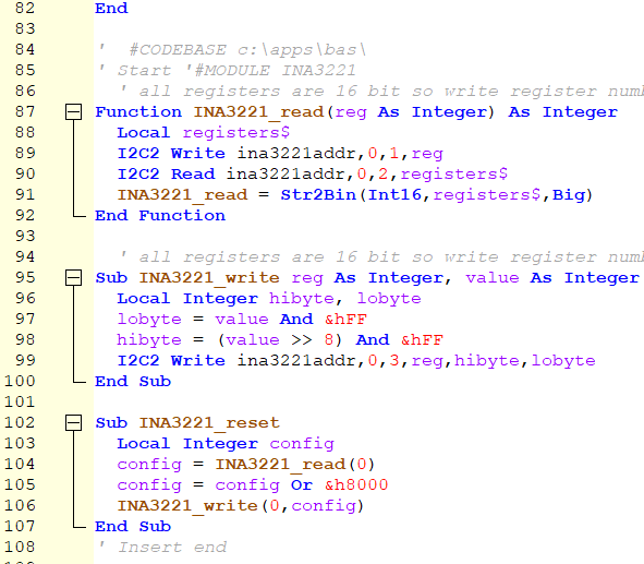

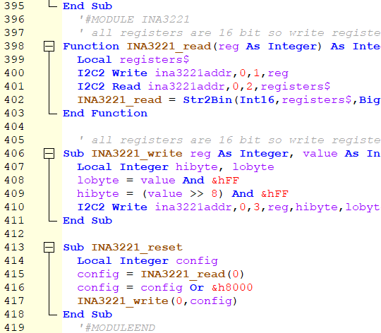

Posts: 6643
Posted: 07:29am 30 Aug 2026
Gerry,
This used the source before your change to INCLUDE paths.
I have added code in 4 places. You should be able to find it by searching for tassyjim (in comments)
So far, I have only returned the expanded file to MMEdit.
Changes:
before start of processing - globals and extractmodule procedure
just after "wrong num parameters" - read preferences
before debug directive - codebase and codemodule directives
start of Production output - close files and write preferences
On first run, a file "MMmodule.inf is created in the MMEdit5 data folder
The only entry is for the path to the module source files. They can be in a sub-folder.
If blank, the absolute path is required for the source files,
To change this base folder, use
#CODEBASE folder$
in your .bas file
to insert a module, use
#CODEMODULE modulefilename$ name$
module filename can include a path relative to the codebase folder
no spaces in path
In the library/module files, start the module with
'#MODULE name$
no quotes and no spaces
conclude the module with
'#MODULEEND
Permitted:
any number of modules in any number of files.
File to receive module
After running "replace"
Module fie:
Source and exe
MMReplaceV5All.zip

Posts: 6643
Posted: 10:17am 31 Aug 2026
#CODEBASE Z:\Kits\PicoMite\BAS\!Lib\!src_lib\
#CODEMODULE all.bas sys_kill_file
missing the final '\' on the first line
and missing the 'E" of the end of #CODEMODULE
The version of MMreplace that Gerry posted 2 posts ago has error checking and reporting which will help catch those errors.
Fixing htose 2 errors and using the latest MMreplace works for me.

I still have some troubles with the library functions:
if there are more than one #MODULE /#MODULEEND in a library-file then
- only the first entry is found
- and the complete content of the lib-file is included
all other referenced entries throw an error.
In the example below if mod1 is uncommented, it is found but the whole file is included. If e.g. only mod3 is uncommented mod3 is not found.
Main program:
'target port\com3:115200 s\picomite
OPTION EXPLICIT
OPTION DEFAULT NONE
'#CODEMODULE testlib.bas mod1
'#CODEMODULE testlib.bas mod2
#CODEMODULE testlib.bas mod3
'#CODEMODULE testlib.bas mod4
Library file:
 '#MODULE mod1
 dim integer var1
 '#MODULEEND
 '#MODULE mod2
 dim integer var2
 '#MODULEEND
 '#MODULE mod3
 dim integer var3
 '#MODULEEND
 '#MODULE mod4
 dim integer var4
 '#MODULEEND
Another issue is that if I align comments in MMEdit the '#MODULE becomes ' #MODULE which is not recognised by the program as module label any longer. Maybe you can treat '# and ' # the same. Same for #MODULEEND btw.
Or is it possible to change the behavour of MMEdit so it does not insert a space after the ' ?
Hope I didn't make a fatal typo somewhere again ....
Thanks,
Gerld
Edited 2026-09-01 15:59 by ville56
73 de OE1HGA, Gerald
