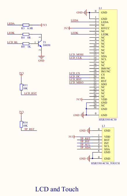

just tried, the cursor artefact also appears with a ST7789_320 display but not with ILI9488. cursor hide has no effect.

Peter63
Joined: 28/07/2017
Location: Sweden
Posts: 220
Posted: 07:55am 23 Sep 2026
  Quote  The ST7796S controller does support reading from the framebuffer. Check the schematic for your screen and that GP16 is properly connected. You may be able to modify something to get MISO working.
here are some info...
is modification possible?
/Peter63

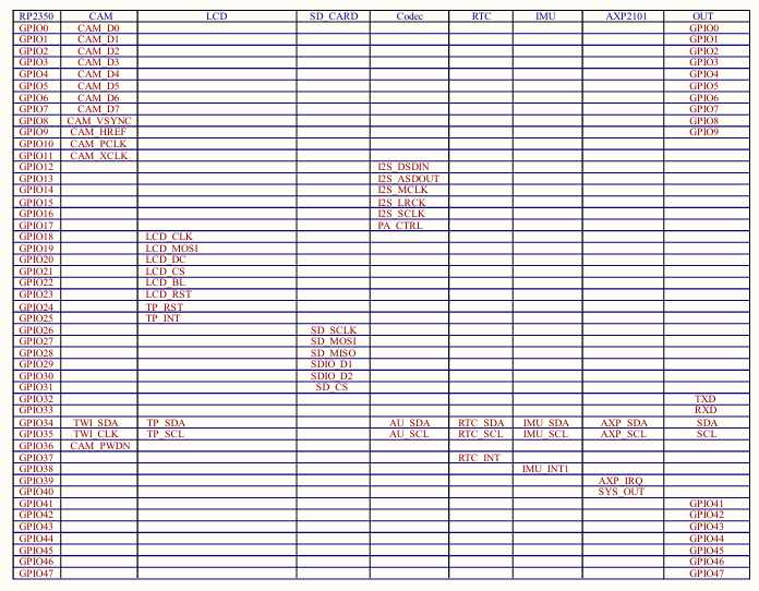

Posts: 3429
Posted: 08:22am 23 Sep 2026
In the table of RP2350 pins, LCD column, MISO is not assigned.
The display has SDO (MISO) shown but it does not appear to be connected to the RP2350.
Posts: 6252
Posted: 08:25am 23 Sep 2026
/Peter63
LCD_MISO is not connected to the pico.

ville56
Joined: 08/06/2022
Location: Austria
Posts: 665
Posted: 12:42pm 24 Sep 2026
I think I know what the reason is:
  Peter63 said  GUI cursor on/off – when I set the cursor to off, a light-colored box remains.
> option list
PicoMite MMBasic RP2350B V6.04.00RC0
OPTION LCD SPI GP18,GP19,GP16
OPTION SYSTEM I2C GP34,GP35
OPTION FLASH SIZE 16777216
OPTION COLOURCODE ON
OPTION PICO OFF
OPTION CPUSPEED (KHz) 200000
OPTION LCDPANEL ST7796S, LANDSCAPE,GP20,GP23,GP21,GP22,INVERT
OPTION TOUCH FT6336 GP25,GP24,,50
GUI CALIBRATE 1, 6, 312, 10243, -9961
OPTION GUI CONTROLS 50
OPTION SDCARD GP31, GP26, GP27, GP28
> gui cursor on
> gui cursor off
/Peter63
I am also using a hw-config without MISO (data from display to cpu) connected. When using the cursor, MMBasic seems to read data from the display hardware via MISO, for whatever reason. If MISO is not connected, it is read as all ones and this results in a white patch. Tried it with MISO on the pico side tied to GND and the patch was black (all zero).
So the artefact is because MISO is internally used but not connected properly or not connected at all.
Gerald
73 de OE1HGA, Gerald
Posts: 12172
Posted: 01:33pm 24 Sep 2026
Precisely so, without miso nothing involving reading the display framebuffer can work. BLIT, transparent text, cursor and probably more
