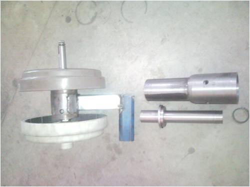

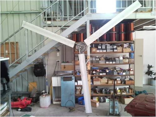

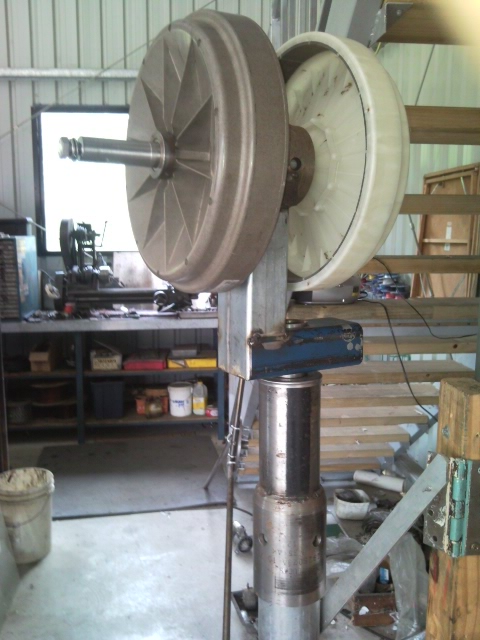

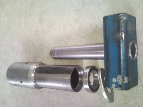

Well i must admit ive been slack with the mill project for a few months now . work has been hectic and regretibly havent done much since before christmas. The mill is just sitting there in the workshop looking at me like Ive neglected her I had posted some pics earlier on another thread (first mill. a dual) on the 11 dec. but I do have some more to keep you glued to this station
The first one is the pivot base on which the nacel sits. It has 2 x 6008 bearings (like phils) for the cabeling to go thru. I manufactured a stainless steel cover to protect the upper bearing from the weather which has clearance over the upper pipe .
next with the shaft and rotors assembled. this pic includes a circlip which locates under the second bearing holding it all together
assembled and on my test stand
and with blades attached. woooooh!! 3 metre dia fan is quite a big thing when your standing right next to it. even scarier when she is doing a few hundred rpms
hope to get back in to it soon. thanks for your help .....Marcus...

I see you have some tilt, to keep the blades away from the tower but.....
Argh.....
what about the offset????
Phill's uses a variable offset and a big 1" bolt to set it.
I'm thinking with no offset you'll need to re-invent the wheel to stop it self destructing.......
I spooled mine up to perhaps 150rpm in the shed with a howling gale coming through, she even self started!
Make sure you get those blade angles identical before you balance, as beleive me it makes a difference.

Ahhhhh!!! the offset. I was going to offset the tail to one side at the rear of the 3 x 2 rhs(blue section) but do I need to do the front as well?? I can see how Phils is variable with that big inch bolt, but the rear is fixed, apart from the tail to swing .

The center of the fan needs to be offset as it is the push on the fan combined with the offset from the mast axis that dictates the torque available to self furl. I am in the process of building something similar but will be mounting the front magnet ring off the fan hub to get the maximum distance between the shaft bearings as well as get the front bearing as close as possible to the fan hub where most of the dynamic loading is occuring.

It is a bit like how long is a piece of string. The heavier the tail and/or the greater the cant on the tail pivot the more offset is needed for a given fan swept area at a given wind speed to get furling at the required fan RPM. You can make an adjustable cant for the tail by having it on a pipe in a pipe with a clamp bolt (so you can twist it to change the angle)or even swop to a new revised assembly or use the gas axe/welder method and then fine tune by adding/removing weight to the tail. For a starting point, if you stand behind the generator (assuming the shaft offset is to the right) the top of the tail pivot shaft leans towards you and is tilted to the left. That is as it starts to furl the tail rises.

in my humble opinionm the go is to weld in the huge bolt and then its adjustable.
If no adjustable is possible then 100mm offset is a good start, Phills the tail is mounted on Aluminium square section and the tail itself is aluminium.
Rationale behind this is longer tail = same mass as shorter tail in steel but more gentle furling and, further back from the prop, so should see some wind,
Quote from Phill "these blades stop lots of wind getting to the tail", hence longer = better.
I;m sure if you ask really nicely Phill will tell you the angle he uses.
Also note you need a tail stop in both directions, one so they dont hit the blades, the other about 15degrees opposite from straight back, ie the opposite direction to furled, this helps it track the wind without bashing it around.
