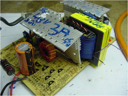

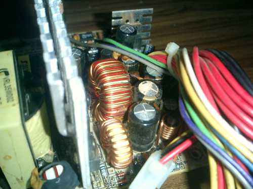

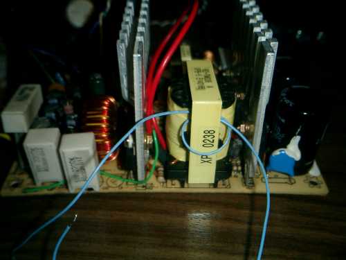

Answer.... yes here we are at higher voltage. I rewound a larger transformer.. using 1.7mm wire on the primaries and secondaries. It easily goes over 60v, and at reasonable current (10 amps for short periods... havent got to cool the trannies down on the test bench yet)
It is made from one of Spuds victims I was playing with. I had yet to see a 450W supply... so I took advantage of his.
This was made easy by using an ATX supply. It gets it's Vcc from the little flyback tranny.... so is isolated from the output voltages anyway.
You can see the oversize tranny here and the cool metalwork (gothic style), and the small loop to watch the switching waveform with the scope.
Here is a different version for 48v battery charging/maintaining using the fullwave bridge as you are doing.
In this guise (xt with full bridge), the 5v winding is still part of the 12v winding.... not an isolated winding.... So I figure that you need to use your earth end and the first tap for your power or even the center tap (Vcc<40v)).... if you used the two 5v tap points... then this is trouble??? did you do that perhaps forgetting they are the same winding not isolated.
If you did do that..... you need a better brand of candy bar...... and I will get a giggle.... even though malnourished.

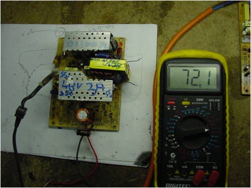

No, I didn't forget that the 5V winding is just a tap on the 12V one. What I did was basically rectify the 5V winding, add an inductor and a capacitor, then a 16V zener regulator. Full galvanic separation would've made life much easier. The TL494 is fed by 16Vdc w.r.t. to ground.
I knew I was never going to get a completely isolated voltage for the TL494 - if only.... Yes, using an ATX PSU would've made life much easier for me in that respect. Alas, an AT is all I have now. BTW, I didn't rewind the transformer as you did, just disconnected the flying lead (this PSU had one) and built a full-bridge rectifier.
Incidentally, I've seen voltage soar to over 80V.... Not good when the output elco is rated for only 63V. I attribute this to unhealthy (too low/noisy/choppy) voltage going to the TL494: my 16V zener-regulated voltage dropped to 8V when the PSU tried to start up. Will change the zener for a 10V/1W one and reduce the series resistor to 1k, and try again. I think it might just work, after all....
If I can't make it work without requiring an extra power supply for the TL494 I'll convert it back to its original configuration (2.5-29V, 8A out, nothing to be sneered at), and wait for a suitable ATX supply to turn up, to convert to 0-55V. Am currently out of PSUs: have thrown about 15 of them out in the latest move - will have to build my stock from scratch again.
Those 450W PSUs you've got there look *very* tasty - never had anything above 300W myself so far.
Will keep you posted on the developments. And from now on I'm not experimenting with PC PSUs without a series light-bulb - it saved my arse on about a dozen occasions by now. And yes, have learnt quite a bit about those PSUs in the past days - not to mention having practically memorized the TL494 datasheet by now.

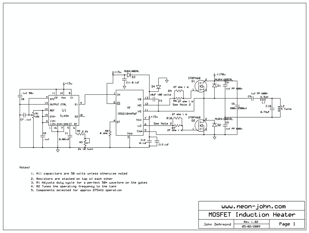

As I was studying a generic schematic of a PC PSU (http://pavouk.org/hw/en_atxps.html) I suddenly realized the similarity to some simple DIY induction heater projects I've been studying recently (an induction heater is another project of which construction is planned for the near future).
A very simple schematic of an induction heater (manually tuned):
(taken from http://www.neon-john.com/Induction/heater.htm
Basically *everything*, apart from the tank circuit (work coil and resonant capacitor) is already there.... just remove the output transformer of a PSU and connect the tank circuit of the above schematic? (C9,C10,L1,L2)
Please say it isn't so.... but could the venerable PC PSU also be modified to a small (say, 300W max) induction heater? Modify the oscillator of the TL494 to make it manually tunable to the resonant frequency of the (loaded) tank, whilst running at limited power (DTC/pin4 high).... then, when it's tuned, crank up power (by lowering the voltage on DTC) for heating? Could it be *that* simple?
Will this madness never end ?!

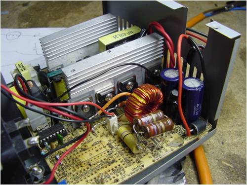

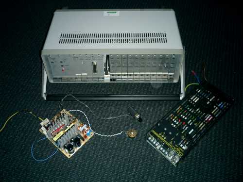

Ok - didn't succeed in properly powering the TL494 from the output transformer, so removed the full-bridge rectifier and assorted other parts. Will wait till an ATX supply turns up and modify that to 5-55V.
After playing with another PSU, I noticed that the single-turn pickup loop I added around the transformer produced about 10Vpk-pk unloaded.... and could light a small lightbulb (6.3V/100mA) from it. So maybe I simply should have added two loops around the transformer, rectified it and fed the TL494 with it? Might have been a lot easier than what I was trying to do in the first place. Anyway, scoping the single-turn pickup loop was a real eye-opener. Amazing how dirty the signal is without load (or in my case, the 13W load the resistors put on the PSU to stabilize it; even with just 13W load the signal looks dirty, but at least the PSU makes no nasty sounds, as it did without any load). Adding a 24V/65W headlight as load immediately turns the signal in a very clean PWM squarewave. Reminds me of the experiments Oztules did with one of Spudd's PSUs. What a difference a load makes.
On to the next powersupply - by now completely butchered up, with no longer even its output transformer present any more:
After removing again the full bridge I had built and other added components, I also removed the output transformer and added a toroid with about 13 turns of wire for an experiment with the PSU as an induction heater. One leg of the large coil will be the single-turn secondary of the toroid transformer. With about 6.6uF worth of capacitors, the 0.57uH coil should resonate at about 82kHz; the switchmode PSU now works at 75kHz, so should be close enough. Will replace the oscillator resistor by a potmeter for tuning the circuit to the (loaded) tank resonant frequency. Then slowly crank up the power (either with a variac, or by lowering the voltage on the DTC pin) and see what happens. Anyway, will add a series lightbulb to the 230Vac, just in case... But who knows, it may just work as a crude, small (300W) induction heater. If it does work - I will be impressed with those power supplies even more. And to think they get tossed out by the thousands daily into landfills.

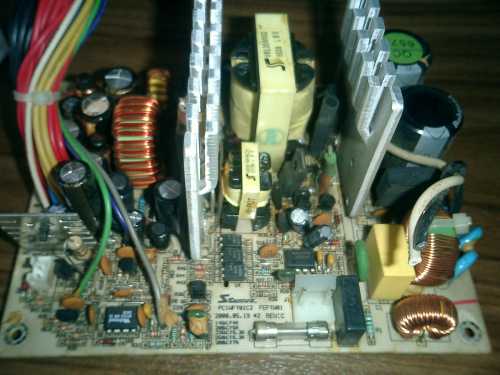

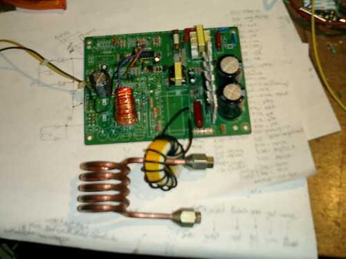

Yes... it turns out you *can* use a PC powersupply as a small induction heater....
The test setup: a 200W PC PSU without fan, so I didn't dare to put in more power than 110W and even that warmed the tiny cooling fin more than I felt comfortable about.
The work coil consists of 5 turns of copper brake pipe (5mm diameter), the capacitor bank consists of 13 pcs. 0.15uF/440Vac capacitors for a total of nearly 2uF. The resonant frequency of the tank circuit is 155 kHz, as determined by measuring and by experimenting.
Replaced the timing resistor of the TL494 (which originally worked at 76kHz) by a 10-turn potmeter so I could increase oscillator frequency up to 400kHz and tune the PSU to the tank resonant frequency of 155 kHz (notice that the oscillator of the TL494 runs at twice the tank frequency, as it is running in push-pull configuration). The TL494 was powered independently from a 12V battery.
Initially I ran the PSU with a series lightbulb and a variac. Slowly increased voltage as I scoped the tank circuit and monitored behaviour and temperatures of all components. Felt confident enough after a while to remove the series lightbulb and just use the variac - took it up till about 150V, but power increased only marginally (10W extra input) over 110-120Vac. Above about 150Vac oscillations stopped - I attribute this to saturation of the coupling transformer (powdered iron toroid, using it now for something it wasn't meant to do). There's not really room for more turns, but I'll try glueing two of them on top of eachother and rewind with the same number of turns. The material is probably MicroMetals type-52 (blue/green); at these frequencies it suffers from quite large losses, but it didn't become uncomfortably warm.
A M8 bolt was, after about a minute, warm enough to start giving off smoke. After a few more minutes of heating it up I turned the machine off to feel if anything (besides the bolt) got warm - the cooling fins got pretty warm, and the lousy powdered-iron toroid (meant for RFI suppression) was warm too - but much less than I had initially feared. After a few minutes I touched the bolt - still hot. Turned out it was still warm enough to easily melt some PbSn solder, so at least 183C - I estimate it was over 200C. Not too bad, considering the very small RF output (estimated 60-70W) of the setup.
After about an hour of experimenting one of the switching transistors gave up the ghost - not a surprize, considering how warm the tiny cooling fin had become in the meantime. The isolation pads probably didn't improve heat transfer as well. The increased frequency the supply was running at, 155 kHz vs. the original 38 kHz, probably also contributed to the overheating.
Tank voltage was 10Vrms; turns out that retuning by adjusting the potmeter has hardly an effect, but it sometimes helps in starting oscillations by tuning the frequency of the TL494 around a bit.
All in all, I'm very pleased with the results so far. It gives hope for further experiments with a more powerful induction heater - have started construction of a machine that is supposed to become a 2kW unit. But this PSU was my very first trial of induction heating and it didn't disappoint. All it took wa an old PC PSU, some copper tubing and a handful of capacitors.
Peter. Edited by Dinges 2009-12-24

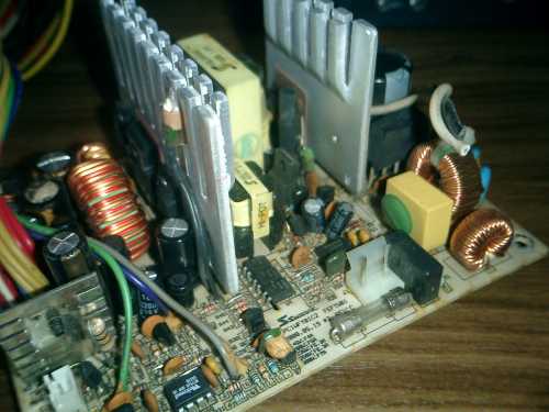

Isn't that just typical.... finally found another PC PSU (ATX) to play around with.... opened it....and was slightly stumped: they had forgotten to install one of the switcher transistors! And there was no TL494.... only a UC3845 in the high-voltage section and a WT7510 'power good/protection' IC in the low-voltage part. So probably the single power transistor is a feature, not an error .
Found the datasheets of both ICs. Not sure whether I'll try to convert it to 5-55V. Would much rather deal with a TL494, am familiar with those. Then again.... there once was a time when I wasn't familiar with TL494s either. If it hadn't been for Oztules' pestering, I'd still be unfamiliar with them.
The PSU is functional at the moment, but the low-voltage electrolytics are bulging ominously.

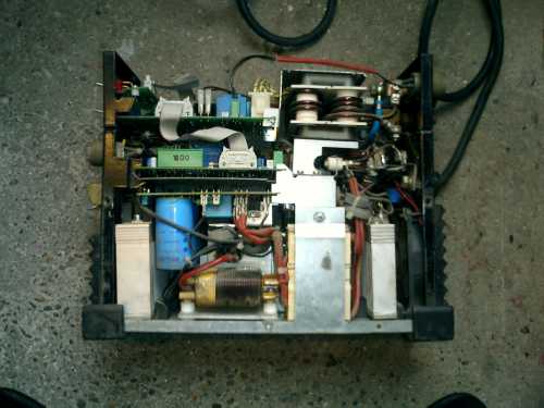

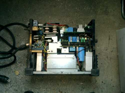

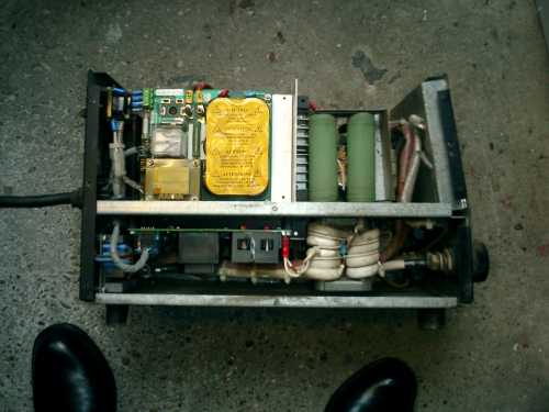

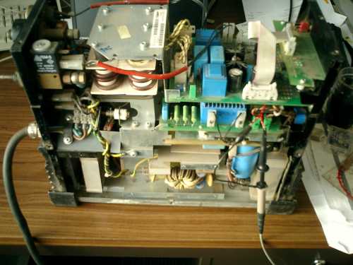

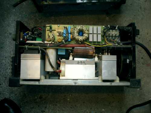

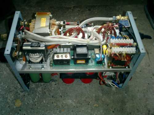

As I was at my favourite hardware store the other day (which also happens to have a welding machine repair dept. in-house) I tried my luck.... explained what I did (hobby electronics, needing parts (in my case, large ferrite cores) for a DIY induction heater) and that these were usually inside welding inverters. Asked if they were throwing an unrepairable machine away that I might gut for parts.
5 minutes later, Peter walked out a happy man.... with 4 large welding inverters under his arm.
(also note the RF HV arcstarter in the middle/front left)
(another arcstarter in there too)
And I'm particularly happy with this cute little Kemppi MasterTIG 1500 inverter (230Vac, not three-phase 400Vac like the other machines):
Had a bit of a chat with the guy who runs the repair department, which was interesting. As was to be expected, they don't repair at component level but simply replace modules.
The loot: large 3-phase rectifiers (ISOTOP case), large cooling fins, big MOSFETs, big thyristors (SCRs), gate-drive transformers for same, a few huge caps, gas solenoids (another thing the doctor ordered for the microTIG), large rectifier diodes screwed into even larger heatsinks, etc.etc.
There are also two RF-HV generators in there, with Tungsten spark gap... basically meaning my original experiments (using a ferrite rod and DIY HV generator and make-shift spark gap) were needless, as I've now got the professional thing right here in my hands, including the large ferrite cores to couple it into.
I couldn't help but smile as I saw 1890s-technology (tungsten spark gap) in a machine from 1999, which otherwise consisted of fancy power semiconductors and a microprocessor to control it all....
Pity none of the cabinets are in a state to be re-used for a microTIG machine, but we'll worry about that part later.
Those inverters are plain gold mines of parts.
Peter. (<--Who can't resist but try to repair that cute Kemppi masterTIG 1500.... Don't have a 230V TIG machine in my collection yet, you see )

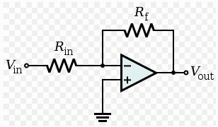

[quote=Oztules]I actually dont think of it like that, feedback to me is the pin3 stuff. [/quote]
Gain of an opamp circuit is determined not only by the resistor between the output and inverting input, but also by the value of the resistor from the inverting input to the input signal; Ri is just as important as Rf....
The only PSU that really blew (and I think it was due to instability) was one I had modified for Ron and was ready for shipment. As I quickly needed a PSU for an experiment, I grabbed his - connected it up, adjusted the voltage, *poof*. This was a PSU that had a tendency to squeal.
But on 2nd thought, I think I can think of another one that failed because of instability....
All my modifications have been made to include voltage adjustability both up and down, i.e. maximum range - 2.5...28V being common. The last conversion I took it down a step further to 1.25V by modifying the reference voltage circuit dividing resistors.
And yes, some PSUs were a breeze to convert and get stable, and others were a nightmare. The very first PSU was a nightmare, but the 2nd one was a schoolbook case of converting.
Curious as to your results on modifying the reference voltage circuit - I still don't have a decent PC PSU to play with (2nd one I found was *also* a flyback unit... Compaq :-( ; well.... there *is* that Mitra 48V/1500W PSU I'm meaning to gut and drive by a TL494... but that's a project for later)

Just had a chance to have a quick look at that Kemppi welding machine. Had already taken out the control boards and tested all the electrolytics and power supply voltages - all were fine. Wound a single-turn test winding over the gate-drive transformer for the IGBT to connect a scope to; re-installed the board and turned the machine on.
Perfect pulses on the scope, so it appears the IGBT is getting a drive signal. That rules out just about all of the control electronics as possible fault factors (note pulse is maximum width, but that's to be expected as no output current flows, so no current feedback to close the loop and regulate pulse width back to the set value)
Then I tried to figure out where the various power components were. But before doing so, just to be sure, decided to short the outputs of the transistor with a large screwdriver (= shorting the electrolytic caps). Shorting the caps gave major sparks.... So looks like DC input is there as well.
That seems to strongly indicate a defect IGBT block. Trouble is, to get at it (or any other part), the machine needs to be taken nearly completely apart (the downside of a small, compact machine....). And very hard to test-run it when taken apart. But everything so far seems to strongly indicate a defect IGBT brick, which means it's probably a simple repair.
Funny though - it's basically an overgrown PC PSU, at 1500W. Half-bridge design, using two large IGBTs (in one brick). 2 electrolytic capacitors, the usual series capacitors to the transformer, and 2 flywheel diodes (will have to check those too).
If the control board would've been dead and unrepairable, I think I'd have replaced it with a TL494 hack.
May take a while before I get some more time & chance to have a closer look at it.
Peter.
Edit: turns out they're IGBTs, not thyristors. Was already scratching my head, wondering how thyristors could work in a half-bridge.... IGBT brick is defect - tested it and doesn't respond to a signal on its gates. Will have to wait with repair till I find a suitable replacement - I don't even want to know how much a Toshiba MG75J2YS50 costs.... bet you could buy a new Chinese welding inverter for the price.
Got very lucky too.... one of the 3 electrolytic buffer caps (all parallel) makes a bad contact, dry solder joint. I had already discharged the caps (I thought....), but when I wanted to do a diodetest on the caps, huge sparks flew around. Turned out the one electrolytic cap, that had a dry joint, wasn't quite discharged. DMM is still fine, its owner was shaken though. The probe point of one of the DMM leads is completely gone - vaporized.
I wouldn't have hesitated to probe around with my finger in that board, as I was convinced all caps were discharged.

I just noticed a consumer seller over here had 2000W induction cookers (domestic kitchen) for around $70. I wonder what is inside them.... and when they will turn up at the tip.

These two links give a glimpse of the innards of induction cookers:
http://www.neon-john.net/Induction/Range.htm
http://en.wikipedia.org/wiki/Induction_cooker
Peter.
