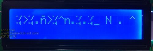

The program seems to be running, but no visual on the LCD. If I hit the menu button and up /down buttons I recognized changes on the LCD. Just the characters are not recognizable...

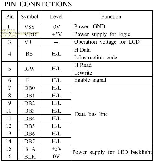

The problem we have is Glenn did not list the "DB" pins for his LCD in the schematic, so the pinouts of his lcd and yours might be different, as there is several versions of lcd around with different pinouts.
Although they look to be the same pinouts.
The messed up charactors are most likely caused by the wrong order of wiring from picaxe and lcd DB pins, causing the data to be sent to the display in the wrong order.
From what i can workout the display should be connected as follows
B.7 to DB7
B.6 to DB6
B.5 to DB5
B.4 to DB4
B.3 to E
B.2 to RS
That is if Glenns display has the same pinouts as yours.

That is how I have it connected see my pin config
But I will rewire the lcd tomorrow and try your test above. If the same wiring works on the version 1 code, can it still be incorrect for the version 2 code?

I just tried that code and it did not work...
I believe the version 2 code only works on the PICAXE-28x chip and NOT the PICAXE-28X1 or the 28X2 chips.
I found a temp sensor circuit and code and the commands are totally different for the LCD display

However, this code loads ok and works...My LCD initialize.

Thats good, although i dont see where the difference is, as both sets of code uses exactly the same code for the LCD.
Sometimes it just works
scnarine
Joined: 17/06/2011
Posts: 29
Posted: 02:14am 23 Mar 2013
Then it might not be a problem with the LCD wiring or LCD coding.
Do you or anyone you know have a revolution programmer that can convert basic to assembler. I have PIC16F873A that I can try, if the code is converted it may work....
scnarine
Joined: 17/06/2011
Posts: 29
Posted: 10:04am 23 Mar 2013
I don't understand any of this programming, I wish I knew what to do to make this project work. I search the internet for PICAXE-28X and could not find one. I order one on ebay the description for $28.00 http://www.ebay.com/itm/PicAxe-28X-Chip-Microcontroller-Inte grated-Circuit-/300852199852?pt=UK_BOI_Electrical_Components _Supplies_ET&hash=item460c3041ac
I don't believe it is correct.

Mr. Pete/Downwind, I do have a PICAXE-28X1 (PIC16F886) and the same exact thing happened when I put version 2 code on the chip, but version 1 code works perfect. This leaves me to think that something is wrong with version 2 code, or version 2 code requires a different wiring to the LCD or the LCD itself.
Mr. Gizmo's is there a data sheet or a part # of the LCD you used on version 2? and could you please post a picture of your LCD wiring.

Well Guys I would like to Thank you both Mr. Glen and Mr. Pete for your time and effort, I have learned a lot about picaxe..(not really an expert yet I am still in kindergarden) Well The good news the circuit and Version 2 code is working so far. so here is what I did so far.
A few years ago I used sprint layout and create the PCB I also purchase PICAXE-28X1 and X2 chip. Last year I used my CNC machine and Finally mill the board and drill the holes. This Year I assembled the board. A few weeks ago I attempt to program the chip. So I started out getting syntax errors since I jumped straight into the 28X2 chip so I revert back to the 28X1 chop and program it with version 1 then tried version 2 code, well that was not a good idea...because you will get a bunch of weird characters on the LCD like I was getting. I would like to apologize to Mr Glen and Mr. pete for wasting their time with me for my silly mistake.
However, This is what I did to make it work. I found a different code ( temp sensor picaxe project) I loaded that code (trial and error while I was testing my LCD wiring configuration) which changes the chip completely. An erase chip function would have also done the trick. I then program the chip again and the notice the LCD display "O/P 1 On 00.0V I then decide to hit the menu button and play around. I then decide to play around with the values then realized I have to set the values so I did and as I exit the menu I see "wait" and then wola the darn thing display correct "12.0v, 00.0A, 000.00W 000Wmax"
1. Do not program version 1 code then version 2 code over version1.
2. Do not disconnect or reset power to chip/circuit (if you do the characters might get messed up on reboot) without going through the initial setup menu by entering values, by just going through the menu will not exit and you are stuck. Version 1 have defaults setup for you.
Thanks again guys....
