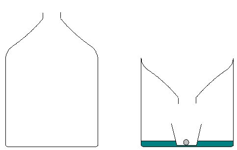

I think you would be able to use the clear platic water bottles. As a small personal distiller. Just thinking out loud, what if you cut the top off, so you end up with a funnel and a bucket. In the bottom of the bucket put an inch of water, and a heavy cup or bowl in the middle, heavy so it doesn't float ( a rock may help ). Then flip the top over so its a funnel and fit it on top of the bucket. Leave it in the sun and it should distill enough water to drink.
Posted: 02:35pm 30 Aug 2011
That should work Glenn. It requires an airtight seal at the top where the two parts join so it may be difficult to take the 'funnel' off (if its siliconed in) to get at the cup of distilled water. Perhaps siphoning the fresh water out with a hose?
To reuse this thing some means to refill the evaporation well needs to be figured out (another hose?) and the collecting cup ought to be fixed to the center before the 'funnel' is sealed in - it'll be hard to reposition if it gets knocked sideways.

I am amazed at your creativity1! Yesterday I was playing around with 6x 12 litre [not 9 litre as I thought] plastic containers and had developed an idea with 2 of them one on top of the other, the top one with a 6inch hole bored out of the bottom and the remaining floor bent up as a drain with the bottom one to be painted black and inserted in the top one... but your idea is just plain clever... I shall try and put it together after today's Idd Mubarak has passed, the shops open and I can get more containers. I would think that the cup could be glued in place and then bored from beneath with a small hole to insert a drain pipe, the whole thing being placed on a decapitated container to act as a reservoir. You may be interested to hear that a friend of mine [has to remain nameless for security reasons] wrote to me this morning: "The "watercone" was in fact invented by a close friend of mine, the late

Well, I tried the inverted top on the 12 litre container and regrettably it didn't work in any productive way. I think the problem was the heavy blue dye concentration in the plastic and the overall lack of light penetration. I painted the bottom matt black and later tried other configurations but no dice. It may be that ordinary litre bottles in series and on their side may be a better bet - I am trying to collect a lot to try another experiment. With the big ones I even tried a tower 6 feet high but not real production. In the meantime to deal with my agricultural saline problem via distillation I have put two Chromagen panels in series and run brackish water through that and it reached boiling point with sun overhead - so next I plan to run the output into a boiler with a copper pipe coming out and going into a car radiator [just got that] immersed in a barrel of cool brackish water newly pumped from the depths. Weather now dull overcast - unusually for th.eis part of the world.
