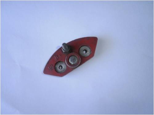

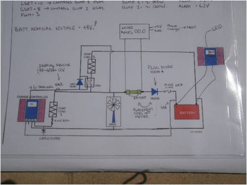

OK ok my pics are crap, making a mends here.
Pictorially hope its right as I laminated it!
Diode at the PL Load- to Batt Pos is a catch diode BTW
I had this kicking around the shed, works OK but dont know the rating, I'd imagine 40-50A
I was thinking I'd bolt it straight to the battery and the windmill to the post, bolt the terminal for the inverter on the other side and done!Edited by KarlJ 2010-01-29

The voltage rating of the diode will be important. These car alternator types can be low voltage, and easily go short reversed. When the windmill power
is low and the battery ius fully charged, the diversion load will drag the mill volts to close to 0V. The diode will be fully reverse biased, and Full battery volts will be across the diode.

The only change to the wiring that you might consider is to take your dump loads off after the shunt and before the diode, Not that it will matter greatly but will allow you to see what current you are dumping as well.
Must say your crayon drawings has improved greatly.
It was only a cheap shot at your last drawing and a drawing is still much better than words only, regardless how basic it is.
Sorry if i hurt your feelings.
Think i would leave that diode in the shed and go for the stud ones and not have the worry.
As you say the diode specs are unknown????
Pete.

yeikes, so no good is the answer I get from that.
You beauty, inverter arrived courtesy of Matt Lyons
forum member and energymatters.
Also ontop is the fuse link to the batt that I knocked together, 3 lengths of 35A fusable link wire together. resistance is less than I can measure but cant see any losses there.
So Gordon/Pete, cant see any issues with my schematic?
not perfect but closer than most will ever get to a good circuit.
As for the hurt feelings, MUCH tougher skin than that!
no probs, keep it coming.
and .....some of the best things in history were designed on the back of a serviette!
Interestingly enough this topic is posted every other day on energymatters forum BUT...
they dont have you guys...only me!
Karl

Karl, this is why I wrote what I did. It is a recent post from DanB of otherpowerhere
Says it all really..... you don't want the trick stuff on the mill side of the fuse. Battery side only... except the dump load itself.and that through rectifiers..... it's designed to cop it anyway. Gordon was right to put the voltage sense of the dump load on the mill side as well.
...........oztulesEdited by oztules 2010-01-30

Hi Oz,
The schematics i put together on what i thought you were saying in text previuosly.
I see your point with the DanB example.
One question that comes to mind is if all monitoring is done from the battery side of the fuse, what happens if the fuse blows.
As there is nothing to controlling the mill then, and you would have a runaway.
Hence the thought of the earlier idea of a relay across the fuse.
Seems like a damed if we do and a damed if we dont situation.
I guess nothing is idiot proof as an idiot will always find a way to prevail.

It's compromise after compromise......
Gordon rightly pointed out that the dump sense can be on the mill side of the fuse.... so if we lose fuse (mill will probably stop anyway.... unless you pull it yourself... hence fusable link... most unlikely) the dump will kick in on the higher voltage it would see immediately.
Thats why I would prefer to see a ghurd style dump control. only a few dollars and would solve the problem... perhaps set it for a few volts higher than the real system then it maybe an add on for this system perhaps. That makes it just about bomb proof.
Your relay scheme should do the same thing. I thought it was fine..... maybe a led and resistor across it for tell a tale too
In my system, it won't allow the mill to run unless the batteries are connected. A big relay sits across the three phase of the mill. It is NC, so if no battery seen, then shut down. Another op amp senses over voltage, and does the same thing and latches off. The current draw is about 150 ma or more..... Gordon is horrified.
Just another advantage of an axfx I've seen it shut down in over 50 mph winds... takes about 2 seconds

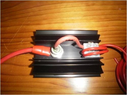

This is the "farmer proof" stud diode good for more than i could ever hope for out of this mill.
Huge cable goes to the box with dump loads wired to it and to the mill and small cable goes to power up the pl20,
its on the batt side of the diode so will read batt voltage more accurately.
another huge cable will go to the batts in the spare terminal, could have been neater but I couldnt find bigger terminal block
one last thing, this whole thing is going to be "live"
do i need to protect it ? obviously I wont mount it onto steel but he wood backing board, I though I'd teck screw it in vertically, is it going to leak to ground? Or electrocute anyone?

If it were mine I'd try to find another connection block, of the ceramic type. After having seen some dramatic pictures from RossW, where such a block nearly melted completely away and came scarily close to shorting things, I'm very suspicious of them when I use them now, especially in high-current applications.
Or perhaps use AMP Certicrimp connectors? They're pretty reliable joints, when made properly.
At least make sure your screws are tightened well; a little contact resistance will cause heating, more contact resistance, etc., in a runaway process, until you're left with a molten blob of plastic.
Ceramic or phenolic blocks may be better, but are harder to find.
I'd also find something else than a wood panel to mount it to. Wood and heat don't go together well, I'd be worried about something heating up more than it should and starting a fire. Steel would do, but then have to insulate the diode. Phenolic board (about 6-8 mm thick) would be fine, I expect.

Yes Peter i also agree with you on terminal blocks but think the matter runs a little deeper.
The only reason we get heat as you mentioned is resistance, and with screw terminals this is often due to the screw cutting the strands of wire and spreading the strands. Or should we say a poor connection.
If one adopts the practice of twisting the strands tight and soldering the exposed wire end before inserting it into the screw terminal than the resistance will not be such a large problem with time. Hence nor will the temp. problem.
The theory of bare it back and shove it in, then do the screw up... has more draw backs than often realized.
Undo the screw and remove the wire and see how many strands fall off, as well as look at how much of the copper conductor was actually in tight contact.
Then add in a few years of oxidation of the connection and you have a high resistant connection. Hence a terminal melt down.
I also thought the same about the wooden mounting board Karl used.
Here in Oz we have a fibro sheeting called Hardi board or the replacement to asspestos.
A sheet of this over the wood panel would give a very good insulator to heat/fire and also non conductive.
I just didnt have the heart to tell Karl after all the work he put in setting everything up.

[quote]If one adopts the practice of twisting the strands tight and soldering the exposed wire end before inserting it into the screw terminal than the resistance will not be such a large problem with time. Hence nor will the temp. problem. [/quote]
Soldering/tinning the wires before inserting them into a choc block is actually a very bad practice. If you want to prevent the wires from being cut by the screw, put a 'cable sock' over it. (not sure what they're called in English; basically a piece of thin tube you slide over the exposed wires, to prevent damage from the screw end)
Note that the better choc blocks already have a piece of metal or tab in them that prevent the screw from directly touching the exposed wires anyway.
[quote]Undo the screw and remove the wire and see how many strands fall off, as well as look at how much of the copper conductor was actually in tight contact.[/quote]
Fully agree with you there! I normally use these 'socks' too - it's a tiny detail, but it makes the difference between a professional job and something my grandmother would do.
[quote]I just didnt have the heart to tell Karl after all the work he put in setting everything up.[/quote]
I have no problems with saying it to him.
In fact, I'd want people to point out things they see in my work that could be improved upon - personally, I value criticism, and don't see it as a direct attack on my person. (not suggesting that KarlJ does, though!)
The difference between a job that is done 'good' or done 'professional, practically perfect' is usually only slightly and consists of details (like cable socks, cable lacing, heat shrink tube, neat routing, layout, etc.) And personally, I get a very good feeling when looking at a job done properly, either by myself or others.

Peter once again you are very correct.
The point of tinning the wire ends is a case of the two evils (unless you have cable socks).
DC cable is often made up of fine stranded multi strand cable that gets destroyed with the screw terminals as we both agreed.
I still think tinning the ends is the lesser evil and would prefere it to not doing nothing and the screw cutting into the cable.
I seen this a lot with low voltage garden lighting.
400 watt 12 volt systems would burn out the terminal blocks.
It was always the connections with loose stranded ends.
The connections with tinned ends never gave a problem.
As you rightly pointed out cable socks and good quality terminals are a better option, but this is not always the case of what we have to work with.
At least with a tinned end you can torque that sucker down tight without destroying the conductors.

OK so I've mounted the diode and the shunt on some cement sheet, do I need to protect them from people touching them?
Human body resistance varies from 1000 Ohms to 100,000 Ohms (wet fingers open wounds vs normal dry skin)
an it takes 10mA to cause pain
thus 60x60/ 1000 =3.6W /60= 0.06A
thus I guess theoretically could give you a lethal shock
at 60mA, if you touched it with wet fingers and were standing in a puddle of water....
Any ideas for a box?, obviously the heat sink still needs to dissipate heat thus fully enclosed defeats the purpose.
