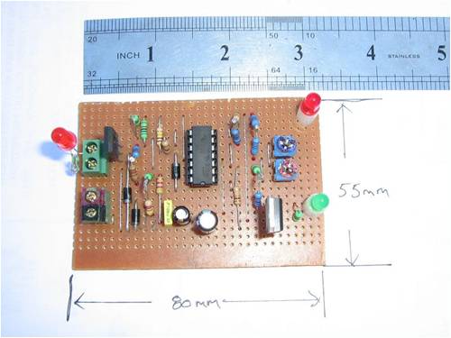

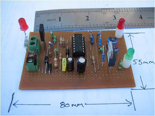

Bob, i would like to see a pic of your work.
I dont think George will get confused knowing it is your layout.
You must find the circuit very practical to be on your 4th one now.
By all means post some pin voltages as it will help to answer some others questions to.
Think i will still build one as its only a 15 minute circuit to construct and i have all the bits handy except the 8 volt reg.
That way i have something to cross check others results against too.
Pete.

So i constructed the circuit as per how Glenn has shown with the vero board layout hole for hole.
One important thing to note i did not have a 8 volt reg so i used a 9 volt reg and adjusted a couple of resistor values to bring the voltages back within the operating range.
The circuit worked fine!!!!!!!!!!!!!!!!!!!
The red trimmer is the high V, and the blue trimmer is the low V.
The help with the discussion on threash hold voltages i will list the opamp pin voltages for my circuit but as i am using a 9 volt reg and the pin voltages might be different to others circuits with a 8 volt reg.
[code]
12.15 volts supply
pin volts
1 1.32 OP1
2 3.42 -
3 2.89 +
4 9.00
5 2.88 +
6 2.89 -
7 1.47 OP2
8 1.37 OP3
9 1.47 -
10 1.25 +
11 0.00
12 1.37 +
13 4.05 -
14 1.23 OP4
15.00 volts supply
pin volts
1 8.20 OP1
2 3.42 -
3 3.41 +
4 9.00
5 2.88 +
6 3.41 -
7 1.32 OP2
8 6.90 OP3
9 1.32 -
10 6.24 +
11 0.00
12 6.90 +
13 4.05 -
14 7.44 OP4
[/code]
Note the vero board layout is slightly different to schematic.
The actual circuit pinout are as follows.
The high V opamp is OP1 (pin 1,2,3)
The low V opamp is OP2 (pin 5,6,7)
opamp 3/4 is OP3 (pin 8,9,10)
opamp 4/4 is OP4 (pin 12,13,14)
Also the schematic shows a 12K resistor as R1 and the vero board shows a 10K resistor as R1.
I found i needed a 10K resistor as R1 to get the circuit to work in my case.
Pete.Edited by Downwind 2010-02-16

Trying to work out of recycled electronic bits is a loosing battle and costs more in the long run.
Think the TL084 is about Au$2.00 and is rather cheap for the main brain of the circuit.
The relay would be the most expencive part of the circuit.
If you need some help with building the circuit for the first time than ask, as many here will help with tips of how we do things.
We all need to start somewhere to learn, as i think many have with this circuit, hence some of the problems discussed over time.
You Mensioned Boldness....What boldness...None of that here.....??
Pete.

im going shopping for a TL048, bd139 and a 78l08 tomorrow, as you said, its not very expensive. (i scored a relay in a car, looks like new to me).
i have a quick question, is a L7808cv the same (or just as good) as a 78L08? im not sure about anything anymore...
thanks/jonathan
