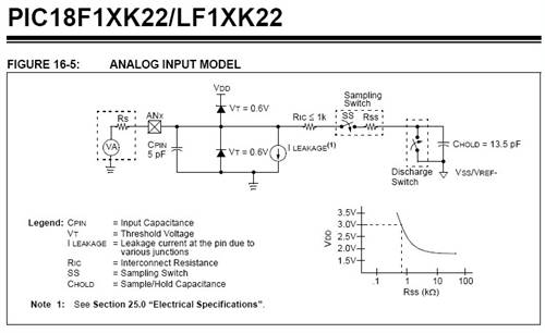

Found this from Microchip about ADC accuracy
http://ww1.microchip.com/downloads/en/AppNotes/00693a.pdf

I had read the microchip adc data before as it is in every data sheet for every pic that picaxe uses.
And as i said earlier the steps internally are not exactly linear.
I think page 8 sums it up in this use with the reference voltage used being the line voltage.

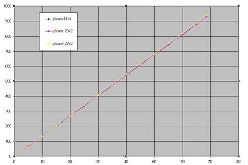

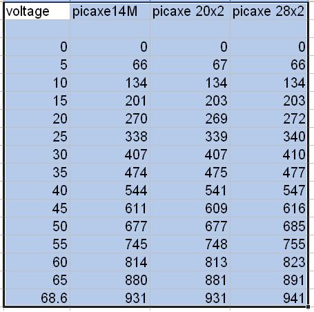

I have just finished testing of each of the other picaxe chips I have on hand, including the 14M, 20X2, and 28X2.
I set up test boards with each chip, and used the same resistor divider. This was 27k, and 2k0. Here is a plot of the cmparison, and the raw data.
The graphs are almost superimposed. This concludes that the is not a problem with the Picaxe ADC, and the problems must originate with the circuitry outside the chip.
It is possible that the leakage current through the zener may be the cause, as this is the only additional component to my test.
I usually use a diode back to the 5V rail, as this is similar to the internals of most chip inputs.
The zener removal will be an easy step. Most inputs can withstand overvoltage with limited current. On a micro, with inputs that can change to outputs, a zener can damage the output function, if the output is allowed to be made high.
something to consider in future.
Gordon.
