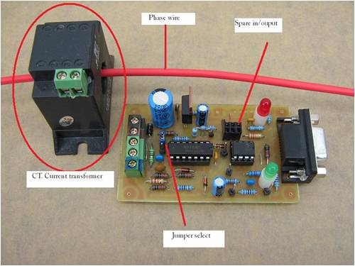

Logger progress report
With some further testing of the circuit by Gordon and myself we identified some minor problems that has taken some time to implicate a solution for, that involved many hours staring at wave forms on a cro to get it sorted, followed by a redesign on a already crammed little board to accommodate the changes.
I was aware of the low input voltage of the LM-7805 Vreg and it not suiting use in a 48v system so the reg has been upgraded to a 125v input capable HV-reg. ( TL-783 )
Problem 2 was a little harder, and resulted from using the CT for the RPM. No problem with it working, but it would only record RPM once current was flowing through the phase wires. Meaning any RPM before the batteries reached cut in voltage was not recorded as the CT will only produce an output when current is flowing through it and not before hand.
A design change was made to take RPM direct from a phase wire through a simple circuit so RPM can be read regardless of current flow.
This then set a problem of sync with the amp readings for use with monitoring mains voltage if used as a consumption recorder.
I added a 3 pin header so either mill RPM or mains Hz could be selected as a input sync and /or RPM or Hz reading by moving a jumper on the 3 pins.
With the addition of a phase sensor wire it has made this a 5 wire system from the previous 4 wire logger.
The extra wire is optional and will only give mill RPM below cut in.
I tested having the CT wired through a length of wire 20m long (what i had on a roll at the time) and got a change of 0.02 in the reading.
This would imply the CT can be mounted some distance from the monitoring circuit and function quite well.
Any loss in signal over distance can be compensated for in calibration.
Gordon's developments of the on screen software is progressing well and is easy to use.
The displaying of graphs for recorded data is easy with some good user friendly functions.
Gizmo's on screen display has been retained with changes made to the graphing window and setup, along with some data error checking included.
At this point the software is still backwards compatible With Glenn's PicLog but not forward compatible.
For a basic simple little circuit i am happy with the performance and the changes made thus far.
It was never intended as a high end logger but rather a cost effective recording device that anyone with a ability to solder a few components in the right spot can construct.

This is not a daunting project, as between Gordon and myself we have endeavored to make this as easy as possible with self extracting software with almost auto logging, along with simple easy to construct circuitry.
There is really no programming or code required as the picaxe will be supplied pre programmed and other than making changes to add extras there is nothing to program.
All calibrations are done on the computer screen in the calibration window. Its as simple as clicking a mouse and typing a number in a box.
I was once a little reserved to having a go at logging to a computer with Gizmos logger, and once i tried it, found it only to easy.
Now we have taken his work a step forward and made it even easier with more built in functions and more stable.
Along with a circuit to suit that will be available in a kit form, so there is no problem accessing all the parts required or needing to producing a circuit board.
It should work on any windows based computer either through serial or USB.

I have to add that this hardware component is purely a DC voltage sensor, an AC current sensor and an AC voltage sensor, with a spare port. There would be different logging apps for say a replacement piclog windmill app, and say an app for monitoring the performance of an RE home, battery and loading.
You do not need a windmill.
If you have AC power in your home, you can monitor it. You can monitor how much power your AC coupled solar is making for a lot lower cost than a manufacturers option. You could even monitor your fridge, or TV etc. Depending on the house wiring, an electrician may need to be consulted. An Electrician could incorporate the AC current sensor into a short AC extension lead, for appliance monitoring.

The program is relatively easy to install. During the install, some files may be in use. Choose ignore, and then OK.
The application will be installed, with access in the normal manner through the start menu. There will be a new added menu called piclog2010 in the programs menu. There will be new icons, piclog2010, piclog folder, and a readme. The readme will explain the steps needed to convert the piclog folder in to a folder icon from the program icon that is made with the self installer.
All the necessary folders are created, and as long as the COMM port is known, then the setup can be configured with the port number, and system voltage, and baud rate, etc.
The default port is 2. If you do not know the port number, and the program is run and seems like there is an endless loop when the exit cross is clicked, then just click the ABORT button in the setup window. This will set the port to zero, and allow the program to be exited normally. Once a valid COMM port is entered, the program can be run normally.
Whenever an error is encountered, a record will be updated in an errorlog.txt file. The main display window will show the latest error message, and the latest COMM data. The COMM data is cleared when data is stored to disk. The window is reasonably self explanatory, and the COMM and error windows can be covered by unchecking the COMM box. At the end of each day, and whenever the exit button is clicked, the accumulated Whours at the time is recorded in a whours.txt file located in the logs folder. After continuous long unattended logging [possibly after a year or more], it would be possible to view this data graphically after suitable manipulation in Excel, to show a graphical daily record. The totals for weekly, or monthly or yearly periods could be calculated if needed as well.
The program starts logging automatically when run. Calibration and setup can only be done when the logging is stopped. Viewing data is possible at any time. If the current days Excel file is viewed with Excel, then data stored to the Excel log file will be suspended while the Excel file is open. This is a fault with Excel and not the logger. Avoid viewing the Excel files with Excel on the current days file. A copy .csv can always be created from within the Logging graph window, and this viewed with Excel.
