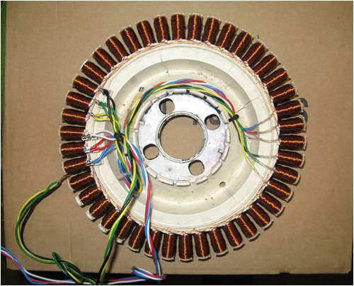

I rewired the smart drive the other night using the 7P2S configuration, with both ends of the winding availiable for star or delta connection:
Stripped a piece of trailer cabling to get some good colours, although it should easily handle the 2-3A.
I'm not sure this was a good idea because any or all of the following could happen:
1. If the smart drive turns clockwise only phases A and C will work.
2. If the smart drive turns anti-clockwise only phases B and C will work.
3. At any given time phase A will flicker imtermittently, but only when someone other than yourself is watching.
Joking!! The average conditon of wiring on any trailer on the road in SA, HAHA!!

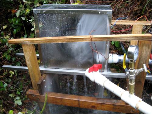

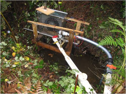

UPDATE: Tried the new hydro setup for the first time today!!!
Greenbelt, in answer to your question, i'll refer to the Econinovation website which is where i brought the pelton runner and other bits:
Eccoinovation pelton runner

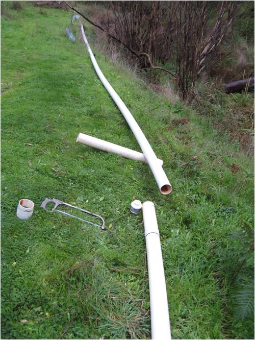

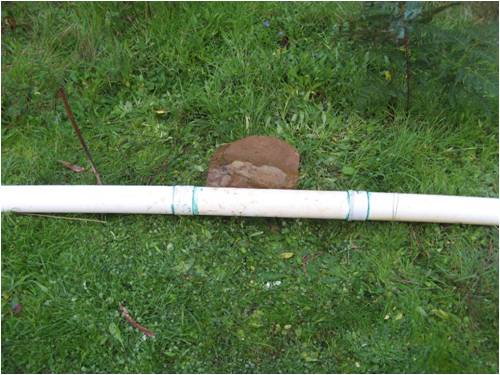

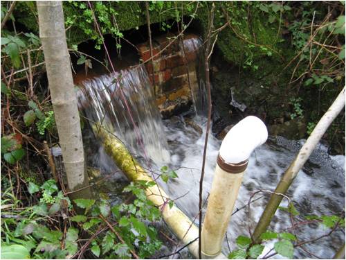

A previous repair on the penstock pipe failed, so i had to fix that before anything could really happen:
Cut out the broken section and sandpapered all gluing surfaces before connecting it all back together, after drying overnight hopefully it holds:
The blackberry bushes in our valley seem to be intent on breaking some sort of record for the time taken to totally engulf any cleared space, so i spent a good 30 minutes reclear the space to set things up in. (I think i need to get serious with some chemical weapons AKA roundup)

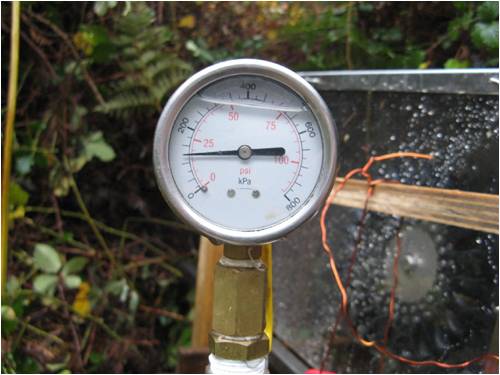

Charged up the penstock, this photo shows the static head:
To start up the turbine, first i open a tap under the pressure gauge to relieve any pressure spikes in the penstock, then open the main valve and lastly close the relief tap for max pressure.
Started off with a jet opening of about 10mm, with the 1000W projector lamp connected.
Opening the valve for the first time was abit of a disapointment, as the turbine was struggling to move at all (F&P is too good??).
After jacking the F&P rotor about halfway across the magnets things were starting to go a little better, although the turbine was still running a little too slow as shown by the water exhausting backwards:
After opening the jet up to about 14mm, the power increased to 1.56A x 47.2 V = 73w approx, the turbine was running at about an optimal RPM and the light was starting to glow:
Already i can tell that hydraulically the system is operating a lot more efficently than the previous DC generator turgo turbine with radiator hose connection + poly irrigation takeoff.
To get the same amount of power, i had to use a 19mm jet. Although i havn't really measured the flow it seems considerable less for same amount of output power...
With more water, a bigger jet (or using the second jet) i'm sure we could be talking 150W plus.
So i'm pretty happy with the results of the first test run, i was worried that the SS box would vibrate make too much noise, but the whole rig is really very quiet, because the samrt drive is running at less than 600RPM. It's only the wirring of the smart drive that gives it away and even then it could easily be mistaken for the noise of the creek flowing at a distance of more than 20m.
Because the system is opperating close to the static head with only a small dynamic loss of head, there is a very pronounced "hill" which represents the optimum turbine RPM and electrical load.
So electrically the issue of matching the load (MPPT) is going to be fairly important to obtain the maximium watts and therefore watt-hours possible...
Not to sure how the efficency of the smart drive will be affected by jacking the magnet rotor out away from the poles.
Basically i need to get an MPPT controller, this will also mean i can send the power up the hill at 100V say, which will reduce the power line I^2R losses and then step it down to the ~54v of the 48v battery bank.

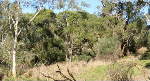

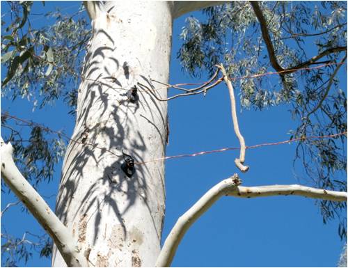

The last couple of weekends I've managed to run the power line from the turbine site up to the house.
It is 2.5mm diameter enameled copper wire, supported by plastic electric fence insulators, secured to some big trees with stainless steel screws.
I've found that normal steel screws in trees rust away very quickly, the stainless is a necessity.
Because of it's brown colour it's really quite difficult to photograph, but with the sun at the right angle you can see the wires
Here's another shot showing the insulators on the tree.
I only put the power line up last weekend and already there's a stick that's got caught!!
I shorted the power line at the turbine end to test the resistance around the loop and hooked up a 12v light bulb to an SLA battery i measured a 2.54V drop with a current of 1.4A
V / I = R
2.54/1.4 = 1.8 Ohms!!
I'd estimate the length of the line at about 250m and was hoping for less than about 5 ohms, so this was a pleasent suprise.

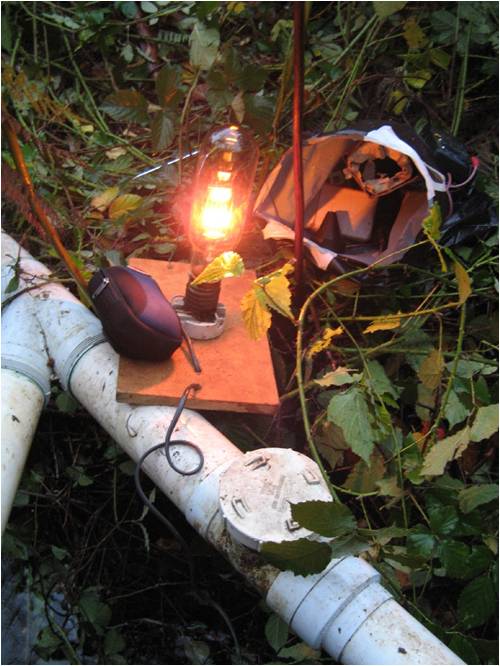

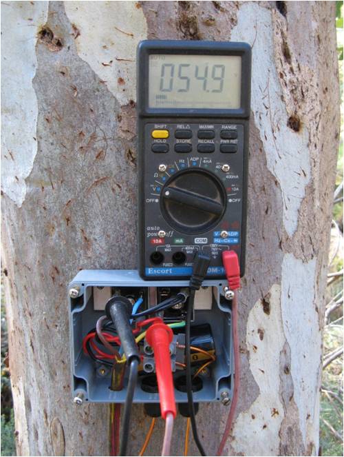

Next i enclosed the 3 phase rectifier with filter capacitor in a waterproof box with cable glands to terminate the power line.
This box is situated away from the creek with the water and spray, an old extension cord carries the 3 phase wild AC from the smart drive to the box so that there is less chance of the connections corroding electrolytically.
Here's another shot showing the voltage at the output of the rectifier, the battery voltage is sitting about a volt or so below this figure.
The battery bank is being fed through a low loss shottky diode that stops the power line being energized by the battery down into the valley for safety reasons.
I will put a switch across this diode so that it's possible to power up some lights down there from the battery if i have to go down at night and sort out problems or something.
Actually i'll pull the fuse to the power line as i don't want my power line starting a black saturday bushfire in summer if it happens to short circuit?!

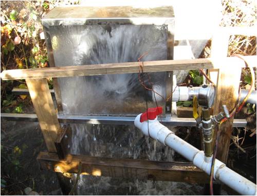

Here's another shot of the turbine running:
The water is exhausting in the middle of the casing showing that unit is running close to the maximum power point
The turbine was delivering about 80W at this point but was drawing down the intake wier, because it hasn't really rained for the last week or so.
So i reduced the jet size as of the moment it's delivering about 40W, so the battery is helping me make this post!
After i've finnished it i'll let it charge up overnight.

Question ..with hydro do you really require a diverion load, as its not like a mill that will spin to destruction.
A wiper motor and ball valve would make a good flow controller.
You can tell your rain god he can back the flow off a little for a while now.
Pete.

The last day i've had it powering our freezer which uses about 1.8kWh a day, the 48V UPS i've got as an inverter is using a fairly greedy 0.7kWh a day meaning there's a few Wh's left for the battery to make sure the net energy in and out is positive.
Actually using a ball valve to limit the flow will introduce hydaulic losses that would reduce the pressuse seen at the jet and reduce the hence the power output from what would otherwise be possible.
Although i might try to rig up a wipper motor on a ball valve to open the second jet which would double/half the flow
What i really need is a Spear valve
This varies the aperture of the jet directly and are used on commercial scale pelton turbines.
Connecting this to control system that uses an float on the intake weir to measure the avaliable water level would be the ideal setup.

About time for an update on how the hydro rig has been going:
Positives:
1. The machine has been running since June 28 minus a few of days of down time equals about 50 days or 1200h of contineous operation!
2. At least this winter, there has been a good minimum useful flow at all times.
2. The meter i've got on the output of the inverter has clocked up about 70kWh of energy consumed by the AC loads.
3. Easily achived my inital goal of running our fridge (and freezer sometimes) from RE power.
4. The stainless steel case for the turbine hasn't corroded at all and has stood up well to the constant use in the wet environment.
Negatives:
1. Not all of those 50 days was at max power production with the largest jet, the flow
2. Attempting to take all the water from the creek results in the intake wier being drawn down with the penstock half empty and alot less power output
3. The UPS inverter is a big parasitic load on the system and uses about 0.8kWh a day

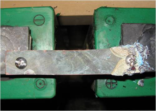

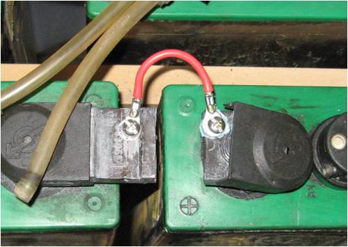

4. Links on the battery bank keep corroding.

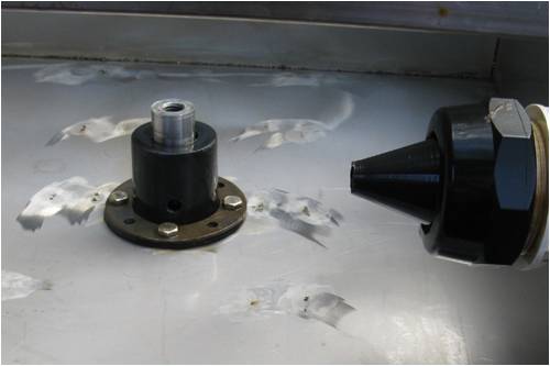

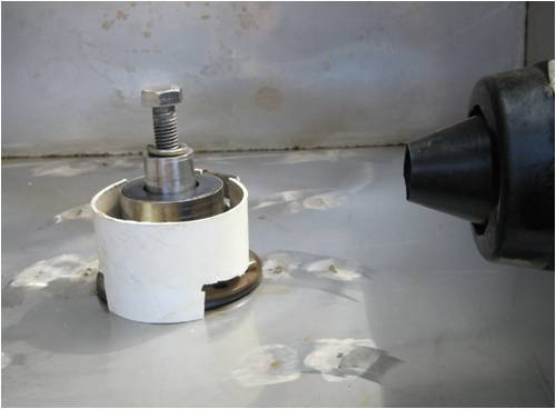

4. Biggest one - water has apparently been making it's way into the bearing block and running THROUGH the bearings. I had to change the bearings, i think i've got one sorted now.
Probably guilty of turning a blind eye to this, as there was water running along the outside of the bearing block and i was hoping that there was little or no water on the inside but i was wrong...
Part of the problem lies with the stainless steel case i had made up, the hole though it was not a close fit with the shaft and hence water could easily flow up against the bearing.
Fixed this with a simple spacer of polycabonate sheet drilled just larger than the shaft with a 1mm gap.
However when using large 19mm jet, water was still getting blasted up the drain hole and being forced into the bearing block
Added a shield made from some PVC pipe to protect the drain hole from direct spray and fingers crossed i think the problem is solved.
Here's a pic of the copper battery link:
I've replaced some of the links with lugs that i've coated with 60/40 leaded solder but even these seem to be corroding
The stainless steel screws seem to be surviving OK, so that might be the only answer, any other thoughts??
Still heaps of work to do:
1. Finish the distribution panel, with buss bars fuses ect
2. Finish modifying a 24V to 12V DC-DC converter for 48V so i can run 12V loads directly off the 48V supply.
3. Set up the second jet so i can take avantage of the extra flow when it pours:
For next year:
I connected a hose to the end of the penstock and ran it down stream and worked out i could get about another 2m of head bring total pressure to 20PSI
So i have to order some more 90mm PVC pipe, clear the blackberries and set up the machine in a better more accesable location

Try a coating of grease or vasaline over the terminals to prevent the corrosion.
There is also a spray on terminal lube to prevent corrosion, and think there is a marine one too.
Might be the answer, a tool kit in a can.
I see most of the battery places use it when replacing a battery and i have never had a corroded terminal with one that has has the spray applied.
Luck or myth i dont know but worth a try.
One would expect you are gassing the batteries a bit to get that sort of corrosion rate.

I cant help but notice its a 60S stator right? potentially this is not the right tool for this job particularly as you can get 600rpm+
If you have one laying around or keep an eye on the verge collection an 80S wired as you did this one will punch out alot more amps.

The enamalled copper wire that is the power line is 4.9mm2 and was free from work, i do have plenty of wire and could double it up.
Even through the run is about 250m the cable is only losing me about 12 watts, yes HV transmission at 100V with a MPPT controller is one of the things on the cards for next year.
I would like to try a different stator, the thicker wire of a 80S would probably give less copper loss and may well be more efficient.
Thanks for the comments Pete, i do need to get some of that blue spray which seems to have magical properties in repeling battery terminal corrosion.

I'm just now discovering this thread. Being a plumber for over 40 years, I wish I had been following it sooner, since I deal with water all day every day and maybe I could have helped along the way, but it looks like you're "arrived" with out me; good job.
One thing I will stress is you should paint that white plastic pipe with just about any paint available so as to protect the plastic from UV degradation. If you notice the surface of the pipe beginning to "check" (little cracks) that's a sign of UV deterioration and sooner or later it will break.
[Quote=SSW_squall]I also snapped an eagle soaring way above the 11kv etsa power lines that goes across the valley: (bold added)
The thought occurred to me those high-voltage lines are sure to leak flux. If you could somehow get a coil winding close enough to one of these 11KVA lines to induce a current into it, you could snag some free power.
Of course, you could also maybe snag some time in Hotel No Knob (jail) or maybe even host a "termination" party at the local cemetery, but it was just a thought.
