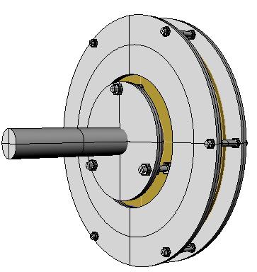

Hi Glenn,
Mate! i have to give credit for your images of you thoughts, well done
I often see things in reverse and it would be great with your design not only see how to build it, but how to create the negitive gigs to make the construction easy.
Example:- i asked myself how would i setup the axle to weld the lugs on, to mount the stator to, within the right position, square to the shaft.
Myself i would make a gig to hold the shaft square to a plane the lugs located into, at the required spacing, prior to welding.
Some extra support around the stator mounts to sandwhich the stator between would be an advantage, but im sure you would have a plan there, yet to be shown in detail.

Yeah I've been thinking about the manufacturing side of things, and not 100% happy with the 3 individual stator mounts. I'm leaning towards a flat disc, with a hole in the middle to fit neatly over and then welded to the axle, and 3 holes on a PCD to match the stator. If you are going to get the magnet discs laser/plasma/waterjet cut, then you might as well get the stator mount cut too. The stator mount could be cut from the scrap inside the rear magnet plate, so long as it was 6mm or thicker.
Power wize, I'm going on roughly the same size as Phills axial alternator, so I would images it would be in that power range. Its using 18 50mm * 12mm magnets, 9 per side. Alternator diameter is approx 365mm.
Remember this is just proof of concept, to see if its manufacturable from a home workshop point of view.

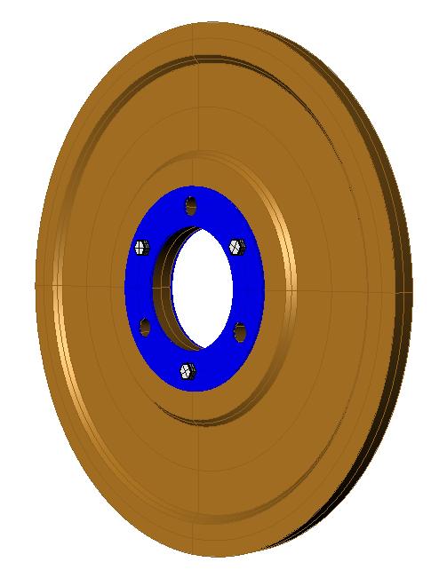

Nice design Gizmo.
I would go with the 12 magnets, as you will have a lot of dead space with only 8 on that plate..... or very very big magnets.... or poor performance.
The stator: Have you considered molding a steel center plate into the stator itself. You can go out to nearly the inner radius of the coils without causing much if any eddy currents in the plate.
This could be them bolted to your "flange" you are talking about being welded to the shaft.
Flexing of the stator concerns me holding it too close in the inner areas. The usual design holds it from the outside (plenty of leverage.... and I use 9 holding points), but if I were to hold it from the inner radius area, I would want as much purchase and stiffness as possible..... or bolt the glass stator directly to the flange (big as possible).
Look forward to the final iteration. With something around the two disks, weather protection is a welcome possibility.

Posted: 01:57am 18 Apr 2010
Yeah I agree a 12 magnet 9 coil arrangment is better. I've spent the last few days in CAD trying different layouts, moving coils and magnets around, and the 12/9 or higher magnet/coil count works very well, which is why just about every axial flux out there is using a 12/9 configuration, its the logical choice.
However I'm going to use a 8/6 for this first build. Its a challenge, but I want to see if it can be done with no wasted space between the coils. The overall diameter is unchanged from a 12/9, so I'll be able to reuse the waterjet cut plates when I upgrade to a 12/9 later.
To better make use of the lower coil count, I'm winding wider diameter coils to fill the space between coils. This means more wire, and more resistance, so to counteract that loss I'm going for a flatter stator between the magnets, 10mm, which will reduce the wire length. This also means closer magnets, and more flux intensity, so I'll gain some power there. The stator will be cast with a step, 10mm thick where the magnets pass over the coils, and 15mm thick where the support bolts go through and the outside diameter..
Where the bolts go through the stator there are two steel reinforcing plates, on either side. I'm using 3 12mm bolts to postiion the stator. The bolts will only be short, there is 25mm between the stator and the mounting plate welded to the axle. 3 Bolts means easy adjustment, but 6 should probably be used for a 12/9 or bigger.
This pic shows the stator and its reinforcing plates. Between each 12mm bolt hole there are smaller 8mm bolts to help clamp the sandwitch together. I think this should be strong enough, but time will tell. This area is where all the big forces are, especially if the mill is shut down in high winds. I can cast this part of the stator thicker if needed, making it stronger and closer to the stator mounting plate.

Posted: 04:19am 18 Apr 2010
Regarding the stator material, yes I planned on using fibreglass resin, with as much glass as I could get in there.
I do agree the coils need to be thoroughly soaked through with resin. I belive, and this is just my opinion, that one reason for the failures in these stators, apart from furling too late, it the individual turns are not properly secured within the coil. As the magnets pass over a loaded coil, the individual wires are been forced against eachother, as they try to squeese out of the flux path. In my view this means the wires, given the chance, will be moving around inside the coil, and in the process rubbing off their insulation, causing internal shorts. Eventually this leads to a overheating coil, the problem escalates until you get a coil failure. The fact we see failed stators with only one or two very burnt coils, while the rest of the stator apears to be OK, confirms this in my opinion. If the stator was overloaded, then you would expect to see all coils burnt.
Impregnating the coils with resin locks them together, they cant move against eachother. Either applying resin while you wind the coil, or vacuum bagging the finished coil is a must do I think.
