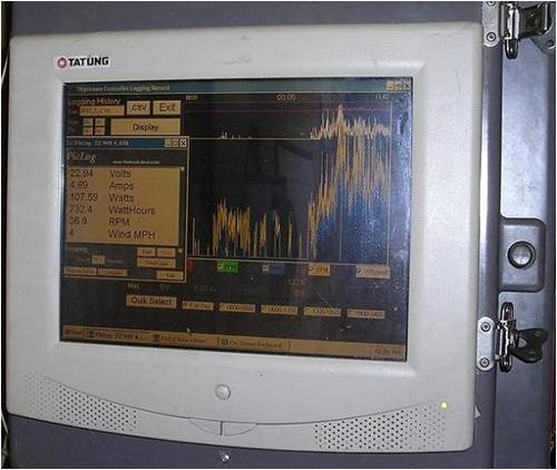

Hi Glenn,
Re placement of graphs in the browser. All the graphs are the same time interval. I think it would be best for comparisons that all the graphs are the same width, and arranged vertically. Any additional graphs can then be easily added to as a list.
Until I get an anemometer, I am going to send out the RPM as windspeed. My windmill tracks the winspeed quite well, so this should be quite easy to calibrate. Will make better use of the graphs on screen as well.

I have modified Pete's piclog hardware, to measure the windmill rectified AC phase voltage, and AC phase current, so the windmill power is more accurately represented, similar to what would result from a GTI boost converter type windmill.
The voltage will range from 0-70V or so in my case. instead of the 51-53V as seen so far.
This mod will have impact on any users that wish to monitor the windmill with Pete's hardware as well. It would be best if the software was as universal as possible I think.
I hope a few more get to put their windmill/other systems online.

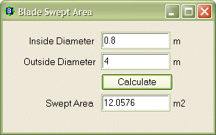

Posted: 11:40pm 09 Aug 2010
This is an example of a little program to calculate swept area. Very basic stuff at this stage.
nomainwin
WindowWidth = 312
WindowHeight = 195
UpperLeftX=int((DisplayWidth-WindowWidth)/2)
UpperLeftY=int((DisplayHeight-WindowHeight)/2)
statictext #main.statictext1, "Inside Diameter", 38, 21, 96, 20
statictext #main.statictext2, "Outside Diameter", 30, 51, 104, 20
button #main.button6, "Calculate", [CalculateArea], UL, 142, 76, 104, 25
statictext #main.statictext7, "Swept Area", 62, 111, 72, 20
statictext #main.statictext9, "m", 246, 21, 144, 20
statictext #main.statictext10, "m", 246, 51, 144, 20
statictext #main.statictext11, "m2", 246, 111, 144, 20
textbox #main.SweptArea, 142, 106, 100, 25
textbox #main.OutsideDiameter, 142, 46, 100, 25
textbox #main.InsideDiameter, 142, 16, 100, 25
open "Blade Swept Area" for window as #main
print #main, "trapclose [quit.main]"
print #main, "font ms_sans_serif 10"
[main.inputLoop]
wait
[quit.main]
Close #main
END
[CalculateArea]
print #main.OutsideDiameter, "!contents? OutsideDiameter";
print #main.InsideDiameter, "!contents? InsideDiameter";
OutsideDiameterArea=(OutsideDiameter/2)^2 * 3.14
InsideDiameterArea=(InsideDiameter/2)^2 * 3.14
SweptArea=OutsideDiameterArea-InsideDiameterArea
print #main.SweptArea, SweptArea
wait
produces this little app
Now for the harder stuff.
GlennEdited by Gizmo 2010-08-11
graynomad
Joined: 21/07/2010
Posts: 122
Posted: 12:12am 10 Aug 2010
Strange syntax, I gather that (for example)
Tells the main form to assign a function called "quit.main" to the close event.
Defines a button and assigns the function "CalculateArea" to it's pressed event.
