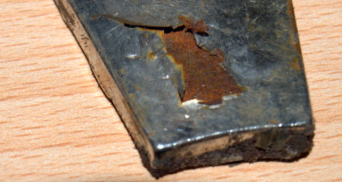

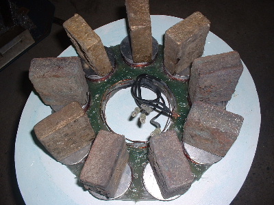

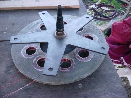

Well I tested the AXFX today. Very disappointing.
1) 100 RPM, star configuration, between phases, ? 15.5v AC ?. But fluctuating a lot.
2) 100 RPM, 3 phase, star, rectified, ? 21v DC ? Still fluctuating.
3) 100 RPM, 1 coil, while still connected in series with the other 2 coils, 3-4v AC.
Suspected some magnets in the wrong orientation. So dismantled.
Found 4 magnets in the wrong orientation. I don't know how that happened.
Removed the 4 perpetrators and fitted them back on the right way around. Glued again and painted only those magnets. Reassembled.
Tested again.
1) 100 RPM, delta on phase 1, 3 coils in series, 13v AC.
2) 100 RPM, star configuration, between phases, 22v AC.
3) 100 RPM, 3 phase, star, rectified, 31v DC.
4) 48v DC at 155 RPM.
The magnet gap is 22mm.

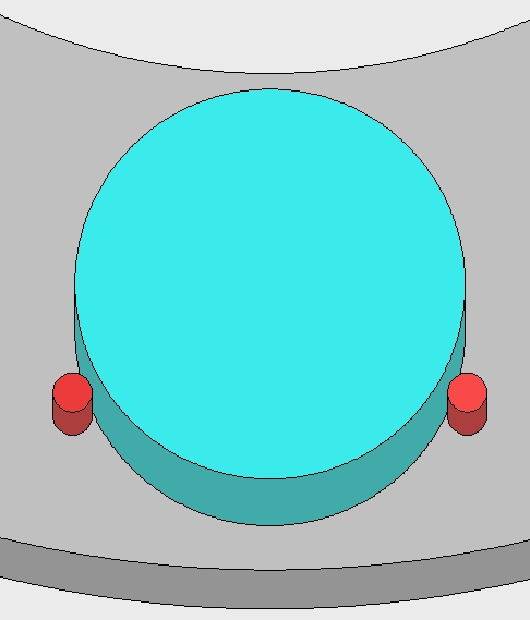

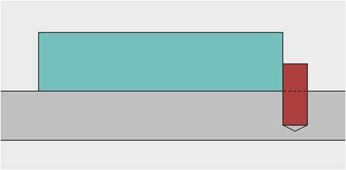

Yeah, I think you should secure your magnets. I've see a LOT of photos on Other Power where the magnets have come loose and slid out the side of the alternator. Remember, under load the coils are pushing magnetically against the magnets, they are trying to push them out of the way.
On my own axial, if I ever get back to finishing it, I was going to use dowel pins to secure the magnets in place. Hopefully the pictures below will explain it. Each magnet should only need two dowels, at about 150 degrees apart from the center of the magnet. Ideally you could use 3 dowels per magnet, one on the inside. The dowel holes dont need to be drilled all the way through the steel backing plate. The dowels only need to poke above the steel plate by 3 to 6 mm, just enough to stop the magnet sliding. The steel plate is shown in grey, the magnets in bluse, the dowel pins in red.
Posted: 01:09pm 12 Jan 2011
I would do that somewhat simpler than the precision drilling dowel holes method shown above.
How about a piece of plywood, slightly thinner than the magnets and cut holes in it for the magnets to poke through. This can also come in handy as a locating jig when placing the magnets.
The plywood needs to be encapsulated in epoxy to waterproof it before painting.
The plywood (or any other non conducting suitable material - plastic? - only needs 3 or so screws to prevent the lot from sliding with the magnetic drag force.
Regarding testing the magnet polarity, after assembling the lot on the steel plate place a 6mm ply sheet over the top. The N or S pole of a small bar magnet (Jaycar sells them cheap) can then be moved over the disk magnets to see if the magnet bar alternately gets attracted and repelled. If this does not happen alternatively the underlying disk magnet is the wrong way round.

i think with dowels youd need to get the nipping pressure just right , the nickle coating is ridiculously thin ..one crack anywhere and the clock will start ticking down
youd need to be pretty accurate with dowels but others have done it ....
maybe half pot the mags in epoxy ?

Along the lines of what Tinker was saying about using thin plywood, take a look at this
Link and you can see I did pretty much the same thing with my first ax-fx build.
In the picture down the page a short ways, I used a hole saw, but in later builds I replaced the hole saw bit with a "forstner" bit as it cuts a more-precise hole. I slid the magnets over the plastic, then tipped an edge into the hole and finally slid the rest in with a minimum of "click" as each one snapped into position against the iron backing plate. This minimizes the likelihood of destroying the magnet's weak structure.
On yet later builds, I found that if I stacked the magnets together, it allowed me to more accurately place a single magnet inside a holding hole without it snapping into position, risking its fracture. The rest of the magnets act as a kind of "handle" and allow easier placement. The plastic wheel was slightly thinner than the magnets' thickness so as not to interfere with stator clearances.
Stacking the magnets or just using them right out of their box makes getting the orientation easy as well. All you do is alternate ends. First place a magnet from one end, then twist the pile 180 degrees and place the next magnet. This assures one is -N- face and the next one is -S- face so there's no mix up.

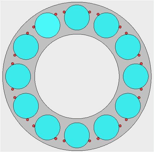

It obivouis your machining skills are very good if it were me I would machine a hole or notchs to recess the magnets into the steel plates let's say an 1/8 inch (dont know in metric)add a small amount of adhesive and your good to go.
Use that bad ass mill and your indexer like you did for drilling the other holes to help keep things neat and tity.
This may help you sleep better at night when you hear mother nature blowing up a storm.

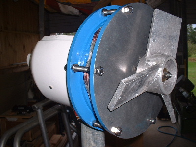

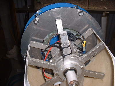

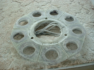

Me again i do not want to pick any holes in your mill your work is great but one other thing i noticed is you only have 3 bolts holding your stator in place all the power the blades produce will go into them this was discussed on glens mill 3 is not many even if they were on the outside of the stator even worse on the inside
you can tell me to go away if you like others might add idears best to talk now than repair later just for example mine has 6 bolts 16 mm on the outside of the stator and your mags are similar to mine.
edit lol mine atually only has 5 bolts don't even know my own mill. Edited by shawn 2011-01-14
Posts: 5194
Posted: 04:37am 13 Jan 2011
I agree with you Shawn. I was going to see if Trev had plans to strengthen this area before making a comment, but I do agree this area will need to be stronger than it is, or it will break apart. I used a 3mm(1/8th inch) plate on both sides of the stator, with 3 12mm threads to support and position the stator, and a further 6 8mm bolts to keep it all clamped together.
Under load, those 3 bolts are holding back the full power of the turbine.

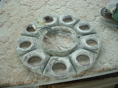

Thanks for all the ideas, the windmills keep turning. Shawn, I read that your magnets are similar, please tell me more, what grade, size etc. Did you have them glued with super glue and they came off??
I fiddled around with the rotors and discs and managed to get the magnet gap down 1mm, to 21mm apart. Scraped off some paint in the process, but whos cares, this is a test. I needed to know if closer magnet gap would deliver much increase in voltage. Well, not much.
100 RPM, star configuration, between phases, 24v AC. Up 2v AC.
100 RPM, 3 phase, star, rectified, 31v DC. The same. Suspect minor inaccuracies with measurements.
So then I went the other way and increased the magnet gap to 23mm. And the voltage dropped.
100 RPM, star configuration, between phases, 21v AC. Down 1v AC.
100 RPM, 3 phase, star, rectified, 30v DC. Down 1v DC.
Just proves I need to get the magnets closer. So dismantled. Because the stator had warped some when fibreglassing, hence the reason why I can't get any smaller magnet gap, I cut and ground a groove in it. This weakened it enough to push it flat. And then re- fibreglass, while held flat.
All is well, we will win eventually, but only as we learn.

and worse in your case i think is your stattor all this stress is also on it and many a good solid stattor that has no holes and thick resin outside and inside the coils has shatterd under the stress these were also mounted on the outside of the stattor yours will be tryin to hold together from the inside glen had a good idear for that and i think it would be a absalut must do it might not even be enough for his size mill but without it death for sure.
otherpower site is full of posts of mags comming off and stattor breaks

Posted: 06:42am 14 Jan 2011
here is a photo of my stator 16mm thick and steel stattor mount 10mm thick with 16mm holes drilled for bolts 5 bolts
to try and hold this with 3 bolts on the inside of the stattor is asking to much.

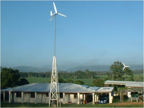

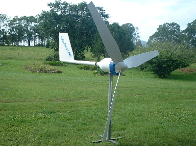

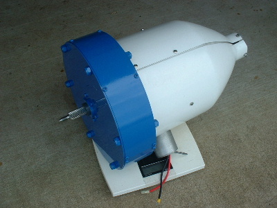

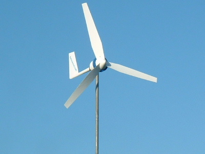

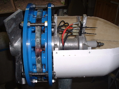

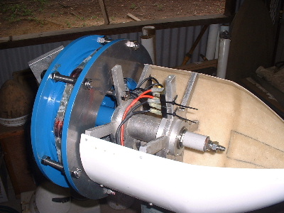

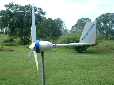

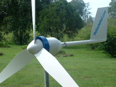

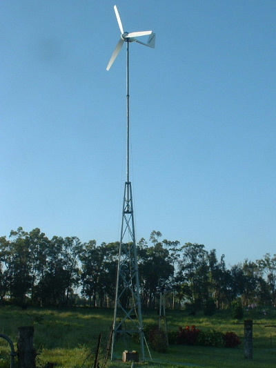

The project is finished for now.
On Sunday I took down the double F&P White Pointer, and put up the AXFX White Pointer. The AXFX is an all new unit, I did not use any parts from the old double F&P unit, which is now an icon, it was the first double White Pointer ever built. It has been up since 2006. Both units are the same, except the generator.
Here are some final pictures. Magnet gap is 21mm and runs free after I re-glassed the stator back together. The cut-in RPM is a bit high, but I can add some caps or make another stator with more copper in each coil.........that will be a decision later. The weight is 28.8kg for the entire power head. The double F&P White Pointer power head weighs 20.4kg.
The AXFX now takes the place the Double F&P used to, in the picture as seen in Basicly Natural home page.
Trev @ drivebynature.com

Hi Trev
Very nice mate, as usual a professional job from you, now we await the performance figures.
All the best
