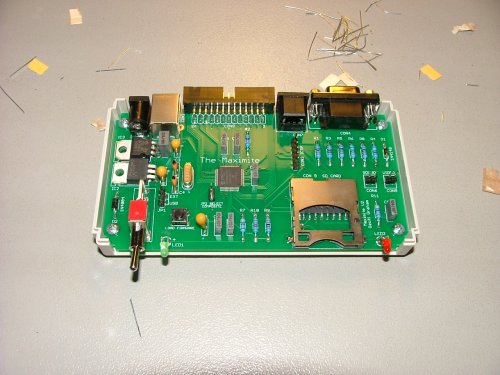

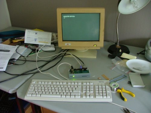

Its arrived!
I ended up ordering it from MicroZed. I was talking to the owner on Monday and he said he wasn't taking pre orders, but would update his web site as soon as they were in stock. On Tuesday, I noticed his wed site had changed to say he had stocks, so I phoned up and placed an order with my credit card. I noticed by this morning his web site was changed back to out of stock, so they sold out quick!
It arrived just after lunch.
Took about an hour to put together. Only complaint is the VGA connector pins are too close, I had to bend them out to fit the PCB holes.
And the first test run. Its currently powered off a USB cable from my PC. The monitor is an old monochrome 12inch VGA screen I've been lugging around for years, just waiting for a chance to use it. Today was its day.
Been playing around with some demo programs and some I've dug up from long ago. Its a fast little thing! Will post more in the next few days.

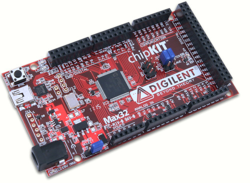

I'm glad you got it! For anyone else having difficulties in getting one, maybe this board can be the solution (if it will be available in enough quantities):
Pic32 board, same microcontroller.
It will be available as a fully assembled board on May 21 and can be programmed with a modified version of the original Arduino IDE. That's mean that the board have a bootloader but I don't know if the basic can be uploaded on the board and having a functional board after that...
I didn't looked at the firmware files of the Maximite board yet.
Anyway, it will require a "shield" containing the required connectors and SD-Card socket as per Maximite schematic (not a problem though)

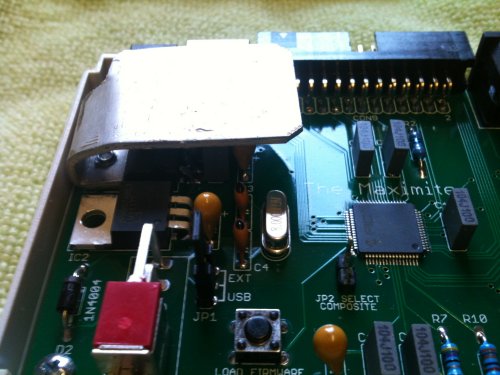

Today I fitted a heat sink to the LM7805 regulator. Its recommended in the construction manual to fit a heat sink if you intend to run the Maximite on 12 volts or more, and I'm glad I took the advice, at 13 volts the home made heat sink gets warm. There's not a lot of room though. Be careful with the LM1117T regulator next door, its metal tab is at 3.3 volts, not a 0 volts like the LM7805. In other words, don't mount both regs on the one heat sink without insulating them.
I also fitted a piezo speaker to the audio output.

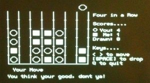

Spent a few hours porting a favorite old program to the Maximite. Porting software teaches you the differences in BASIC version, as you encounter errors and learn how the commands behave. One example, LOCATE A,B in QBasic locates a cursor on the screen, from where you can print text using the PRINT command. A is the row, and B is the column. If I wanted to print the letter A in the center of a 80*24 screen, I would use LOCATE 12,40 : PRINT "A"
The Maximite is different. Its LOCATE X,Y, where X & Y are coordinates in pixels. VGA screen size is 480,432, so to print A from dead center I use LOCATE 240,216 : PRINT "A". This also means, even though the manual says the Maximite VGA screen is 80 characters wide, 36 lines, you can in fact position text in pixel steps instead of character steps like the computers of old. Thats good. Also worth noting, each character is 6 pixels wide and 10 height.
The other trick is the Maximite is can run some commands in the background, like SOUND, to play tones. You need to allow for the fact the Maximite will start the command and move on to the next command before the first command has finished. So SOUND 1000,500 will make a 1kHz tone for 500mS, but SOUND 1000,500 : SOUND 2000,1000 will only make a 2kHz sound for 1 second. Its started playing the first sound, but then moved straight onto the 2nd sound before the first sound finished. SOUND 1000,500 : pause 500 : sound 2000,1000 fixes it, adds a pause after the first sound command, so it gets a chance to play before the 2nd sound starts.
This is just some of the stuff I learned while porting the little Connect Four game. Heres a screen shot.
I originally found this game on a Microbee demo tape, and remember spending hours playing it. You play against the computer, and it a tough competitor! I've ported it to GWBasic, QBasic and now MMBasic, and added a few features along the way. I don't know who originally wrote the original Microbee version unfortunately.
Anyway, for those who have received their Maximites, here's MMFour for you to have a go at. If you like it let me know.

I looked closer at the schematics of the boards and there are little differences. First, is that the Maximite use the USB port for downloading firmwares and Max32 use one of the serial ports so is possible to be an incompatibility between bootloaders. The board can be programed for sure using a Pickit3 (compatible) programmer but this method is not accessible to all members on the forum. Having the sources of Maximite firmware makes this possible but is a (fun) project for advanced users.
So, using Max32 as Maximite board is possible (even using USB port of the microcontroller). Once you did it, you can revert back anytime by removing the "Maximite shield" and use the board for other applications.
The Max32 board use one serial port for bootloader because it offer hardware compatibility with other two (smaller) microcontrollers.

Thinking at this conversion, I just realized that the Max32 board can be redesigned to use the USB port for download ... still hard to make the board... but it can be fun
But this is offtopic...Edited by vasi 2011-05-22

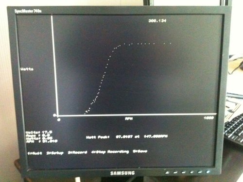

I've come up with a usefull first project for the Maximite, a RPM to Watt plotter.
One of the most difficult things to do is plot the power to RPM curve for a alternator. Normally, you would bolt the alternator into a large lathe, bring it up to speed and measure the watts at that speed, with the output connected to a battery or dump load. Its a painfull process because most lathe's dont have much in the range of speeds to choose from, and you need to measure the amps and watts at each RPM, which takes time. A lathe is used because it will keep the alternator at a constant speed, giving you time to measure the amps and volts.
The Maximite is very fast at reading its analogue/digital inputs, and can process that data within a few milliseconds. It can take hundreds of readings per second. If we connect up volt, current and RPM sensors to the Maximite, it could plot a power curve, very quickly, in one session. For smaller alternators, like the F&P, a variable speed electric drill will work, just bring the alternator up to max speed in a few seconds, you have a power curve on the screen! Larger alternators need more power, and even most lathes struggle to turn a 1 to 5 kw alternator at full power, so you could use a petrol motor and clutch, or even a car ( seen it done! ) to drive the alternator up to full speed over a couple of seconds while the Maximite plots the power curve.
You could also add an efficiency curve, done with a pony brake and a pressure sensor. A strain guage from a set of electronic scales could be adapted.
The data can be saved to the SD card as a Excel file. I'll see what I can put together this week.

The RPM to Watt plotter is progressing. So far the software reads in the data and plots to the screen nicely, now I need to add a few autoranging bits of code, and the save as excel file code.

I've been working on the Watt/RPM plotter, I should really start a new thread for this, but anyway, the interface is built and today I tested some of the basic program functions. I'm using a old servo motor as the alternator, driven by a drill.
Here's a screen shot after a test run, you can see the power curve.
I need to find a better way to take screen shots. My old VGA monitor died , but I'll have a look and see if I can fix it.
The plot is built up as you test, and at the end of the test it joins the dots together to make a curve. Its very crude at this stage, this was just a test to see if the Maximite would read in the values quick enough. It did.

So, it's reliable. As for screenshot, if you can save data on SD-Card, you can simulate on PC the output of Maximite so you can post a readable screenshot.

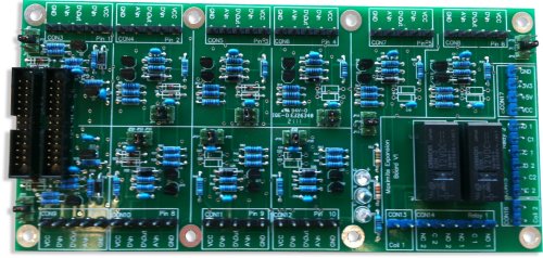

Hi,
I'd just like to let everybody know I have designed an expansion board for the Maximite to make interfacing easier.
More information can be found here
RohanEdited by Gizmo 2011-06-07
