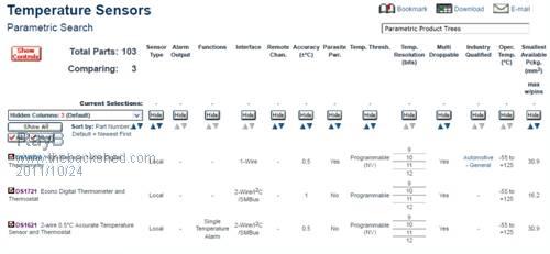

For Ray and anyone else interested.
Reading the DS1721 chips mentioned above was easy. I thought that I might have fried the first chip as I had mounted it reversed and used a heat gun to remove it, then re-soldered. But it works OK. I found that I already had a program from “Crackerjack” to read DS1621 chips which must be similar. Here is a program which I have kept simple but with comments. My little boards have 3 jumpers to set the individual thermometer address pins high or low, then only a 0.1 uF cap across the supply plus provision for mounting pull up resistors on the two I2C bus pins if required. A 6 pin connector for 0 volts , + 5 volts, SDA and SCL plus a pin for the chips temperature comparator output pin, still to be tried. The individual address is sent to the chip embedded in the I2C address byte.
Note that the chip in 12 bit mode reads in sixteenths of a degree, not tenths.
I am not against adding 1Wire protocol to the Maximite but it is slipping down my list.
Keith W.

Ray B

Further to Keith W and CrackerJack's posts here is a comparison between DS18B20 (1-Wire Device) and DS1721 and DS1621 (2-Wire/I2C devices)
Keith W (or anyone else) would it be correct to assume that the sample code above would not work with a 1-Wire Device like the DS18B20 which I just happen to have and not the other I2C components.
RayB from Perth WA

Hi Ray
I wasn't able to read the image you posted ... could you redo it as a URL.
I have included the following link which gives basic info on the alternatives to I2C.
http://www.i2c-bus.org/alternatives/
With the little that I know I would say that 1-Wire's software requirements are more demanding then I2C mainly due to the strict timing demands.
Horses for courses ... Clydesdales will never win the Melbourne Cup but will pull more weight then a spindly filly. Equally 1-Wire has advantages over I2C.

Ray B
Joined: 16/02/2007
Posts: 219
Posted: 01:01am 25 Oct 2011
Keith @ I've reposted the comparison off the MAXIM web page below as it shows some differences. This is a filtered page which can't really be sent as a URL due to the filters not showing up but here goes....http://para.maxim-ic.com/en/results.mvp?fam=temp_sen s
My preference for the DS18B20 because I have those at hand from using them with PicAxe and the fact that I can buy 10 for A$14 from HongKong on ebay inc post (takes 2 weeks). Someone mentioned DS1621 on special at 50 cents each from Rockerby but their freight alone in Aussie is over $10.
Much a muchness I suppose...
