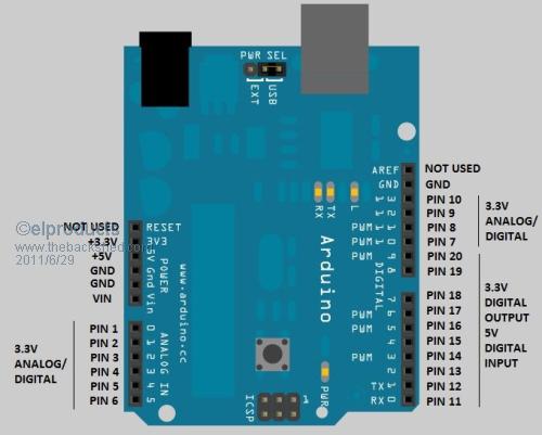

Don Wrote:
>I still need the height of the black socket female section, and the length of the male tails, as my Chinese Lady >(supplier) doesn't know what an Arduino is. So if anyone can help there, it would be appreciated.
The link to the data sheet is here:
http://www.sparkfun.com/datasheets/Prototyping/Connectors/18 688.pdf
The Arduino.cc site has all the gerbers for the pin layout. The two 8-pin connectors have non-0.100" spacing between them which means you can't build a shield out of standard protoboard. Apparently it was a gerber file mistake that stuck.
Gerber file links are on the page below.
http://arduino.cc/en/Main/ArduinoBoardUnoEdited by elproducts 2011-06-29

Quick question, well actually a couple and a comment.
On an Arduino, what voltage range are the analog inputs. Is there an incompatibility with Maximite as Maximite allows only 3.3v.
Assuming we use some of the Maximite analog capable lines for digital, what voltage range do the digital lines on Arduino support.
A comment, it seems that the Arduino we lose 4 analog inputs.
Just making sure that Arduino shields will work without level translators or protection.
Stuart

Here is where we are at with this mating of the Maximite to the Arduino
bus.
Pins OK, and Footprint should be OK. Chuck chased these details up for us. Thank
you.
I can sort out a few pins and even come up with something that shouldn't blow up
a Maximite, or Arduino shield, but what we really need is someone to set out a
table of MM pins and the matching pins on the Arduino shield.
Perhaps even someone that knows the architecture of the PIC32, and has a good
working knowledge of Arduino shields.
Wanted one crazy volunteer that is silly enough to make a decision on
matching a BASIC language operating system that is locked into a 20 pin I/O bus,
and mate it up to an Arduino shield pin out, and live with it forever and ever,
till death do him part. In unison Maxiteers: "Amen!"
Reminds me of an old boss of mine. If you piddled in the ocean, it would be in
the wrong spot. Damned if you do, and damned if you don't. Etc. Add a few of
your own, but you know what I mean.
Perhaps we could take a poll on pin out and all get the blame.
Speaking with Stuart, there are multiple UARTs on board the PIC32, and he thinks
our I/O bus use a TX and an RX, but they are different UARTs. Stuart also raises
other compatibility issues in this thread. Please go back and read them, if you
haven't done so already.

I looked over the PIC32 data sheet and there are five UARTS available.
Of the five only one RX pin lines up with the Maximite I/O pins.
Therefore lining up the USART to the Arduino USART is not possible.
I looked at the PWM/Output Compare pins which there are also five.
None line up with the Maximite I/O pins.
All the Maximite digital pins (11-20) are 5v tolerant input.
All the Maximite analog pins (1-10) are 3.3v input.
So I don't see a need to put much effort in trying to line all this up for Arduino shields as there are many differences.
Therefore just lining up digital and analog and then filling in the extra gives me the pinout below.
I suggest this as the Maximite-Arduino connection standard.

  elproducts said   I looked over the PIC32 data sheet and there are five UARTS available.

Already a flaw in my offer.
You are correct in that I was thinking VIN was the 9-12v power from the Maximite but I missed the fact that doesn't exist on the Maximite I/O header so that pin would be Not Used also on the DonDuino Maximite to Arduino shield adapter.
I had no intentions of implying the pin names should change.
Maximite pin names/number would be the control in software.
www.elproducts.com
