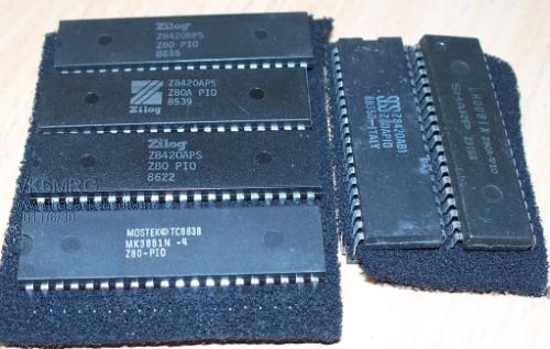

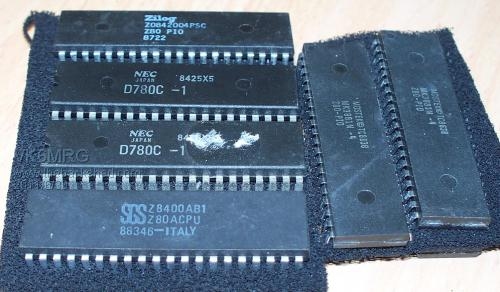

VK6MRG
Joined: 08/06/2011
Posts: 347
Posted: 10:21am 30 Jun 2011
I've got some Z80 chips here, you could build your own TRS-80.
I’ve even got a copy of the original TRS-80 user manual with the schematic and parts list, in PDF.

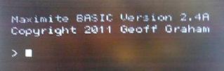

Nick
Joined: 09/06/2011
Posts: 512
Posted: 11:01am 30 Jun 2011
Ok. Have done my best to adjust the horizontal frequency of the LCD. Here are 2 photos of what I'm getting, both shot under the same conditions.
This is the LCD. The LCD backlight seems to have caused the camera to brighten the background. This is the best I can get my LCD, although pixel variation occurs right across the screen. This small sample is the best I can get. Not bad but...
... when I compare to the CRT, the CRT is clearly much better. This is with no adjustment, just straight out of the dusty cupboard and power on.
The LCD is liveable, I admit, but maybe a firmware update to the video driver of the Maximite "may" be able to improve the output to LCD. That is all I am wondering. If not, then be it.

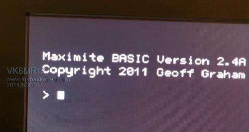

Joined: 08/06/2011
Posts: 347
Posted: 01:06pm 30 Jun 2011
Hi everyone,
Here is a photo of my NEC LCD.
Nice!
