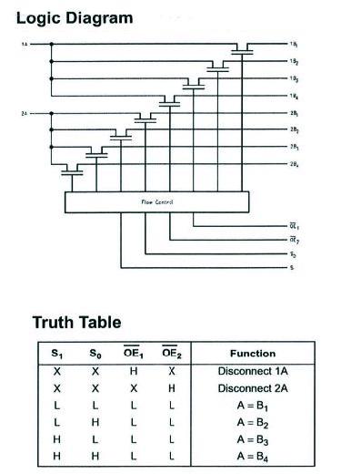

Had a look at that FST3253 Dual 4:1 Multiplexor/Demultiplexor Bus Switch but unfortunately (if I've understood the datasheet correctly) it won't do the job.
Here is the Logic Diagram and Truth Table from the datasheet...
It looks as though it will channel 1 channel (there are 2) into *1 of 4* outputs.
This chip will allow me to route the VGA to either Red, Green or Blue..but only one at a time.
That's only 3 colours.
I need a bit more flexibility to route the 1 channel to at least 8 combinations, example...
to RED and GREEN only,
to GREEN and BLUE,
to all RED, GREEN and BLUE,
etc.
This will allow me 8 colours (including BLACK).
Have I read this incorrectly? If so, any other suggestions for a substitute chip?

use two chips or even three....
Nick
Joined: 09/06/2011
Posts: 512
Posted: 05:58pm 04 Jul 2011
  sparkey said   use two chips or even three....
Ah yes. They're cheap enough I suppose. Let me go back to my corner again and give it some more thought. :)
Would a 74LS139 Dual 1 of 4 decode/demultiplexer be used?
I know it's for digital circuits but since the VGA output is essentially digital (may need something to bring it to 0-5v spec).
Where's the best place to find the FST3253?Edited by Nick 2011-07-06

just looking at that ls139 it has two sets of inputs and dual outputs it may do it but im only sumizing i guess you have looked at the data sheet ..ls should be fast though

  sparkey said   just looking at that ls139 it has two sets of inputs and dual outputs it may do it but im only sumizing i guess you have looked at the data sheet ..ls should be fast though
I think it will be fast enough.
I'm just wondering if the FST3253 is more likely to work with the VGA signal directly whereas the LS139 requires the signal to be 0-5v (digital).
Who do you recommend to get the FST? Jaycar don't seem to have it.

I wonder, since all I'm wanting to do is decide where the single VGA signal in going to 1 of 3 inputs, would an old 4116 Quad Bilatereal Switch do the job?

Nick, check out the specs of the 4066 as well, I seem to remember one of them was faster, but I cant remember which.

Thanks Stuart. I see that the 4066 has lower ON resistance which will be better than the 4106 (300ohm).
I'll pick one up at Jaycar including the required IDC connector.

@Nick, a hw guy always google few numbers higher and lower to find better version of the chip - so have a look at fst3251 (8:1) or fst3257 (4x2:1).. It seems the 3251 is the best fit for you.. P.
PS:
SN74CBT3251 - TI
TC7MB3251FK - Toshiba
FST3251 - Fairchild
74FST3251D - ON Semiconductor
PS1: mind you are going to drive a low-impedance load with the MUX (unless you will use a driver), so you need a switch with an on-resistance ~5-10ohm max..
PS2: 3251 is bi-dir analog/digi switch so it will work 1:8 as well..
PS3: not sure you need a "mux" actually - as you need something like 1:(bin combination)_of3bits MUX only if you intend to modulate somehow the signal (many levels of r-g-b).
For 8 colors you need 3 bits anyway (for the 8 color combinations) passing directly to the VGA r-g-b pins, maybe tristated.. The idea of "multiplexing one maximite video output to a _comination_of_r_g_b_on_the_VGA_connector" is equivalent to direct passing the 3 rgb_mux_control_bits to the VGA connector as the actual "color code"...
It means in order to show 8 colors all you need are 3 bits to be passed directly to vga pins (with some sync modulation as it is today), as a binary 0x000, 0x001, .. 0x111, not as 1:(one of 8 combinations) as this is the same, except you have to have a resistive network connected to the mux, and, moreover, one more pin needed (1-output from maximite, 3 for mux combinations).
You cannot avoid the need for passing 3bits info out of the chip when you require 8 colors even linewise..Edited by pito 2011-07-11
