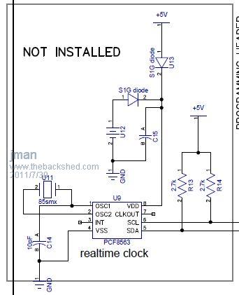

Heppy take not below
Hi John.
As regards the 5V and 3.3V connections, on the original schematic they were shown on the wrong pins - so 5V is on pin 4 and 3.3V is on pin 3.

In the SM1 circuit diagram the RTC is show.
So just get the bits and add them.

Correct me if I'm wrong jman but have you got your PCF8563 board connected to the programing header.Edited by Nicko` 2011-08-02
jman
Joined: 12/06/2011
Posts: 711
Posted: 07:10pm 01 Aug 2011
Hi Nicko
Yes you are correct the power rails line up
I have made two small cuts to the pcb and ran some
small wires to the I2C pins

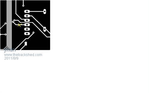

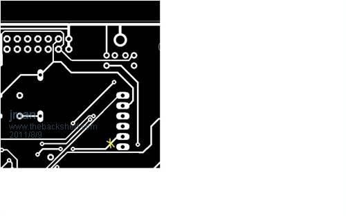

You did modify the Maximite board ?
PCB cuts show below
And add the wires for the I2C
I added the wires the 26 pin connector
on the revised schematic it is pins 6 and 8 respectively (on the original it was pins 21 and 19 respectively)
Top of PCB
Bottom of PCB
JohnEdited by jman 2011-08-10
