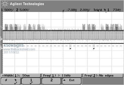

Posts: 3373
Posted: 04:54am 21 Oct 2011
If anyone can come up with the right timing numbers (see the start of Video.c in the source) I would be happy to fold them into the code. Every TV and monitor that I have automatically switches between PAL and NTSC (and I suspect anything in between) so I cannot test NTSC with any confidence.
I believe that the selection of PAL/NTSC should happen at power up depending on a jumper. This is because it would be difficult to correctly type in a command line to switch to NTSC if you could not see the video output in the first place. This would therefore require a jumper of some sort that could be detected at power up, perhaps connecting the VGA/Composite select pin to the video out or something like that.

Keith W.
Joined: 09/10/2011
Posts: 118
Posted: 12:23pm 21 Oct 2011
Hi Geoff,
I will have a try at the timing for NTSC.
The major difference is that there are only 525 lines for NTSC vs 625 lines for Pal. On our non interlaced composite display that makes C_LINE_N = 262, (525 / 2). Presently it is 312 for PAL.
The required line time is 63.55 uSec. vs PAL’s 64 uSec. Therefore C_LINE_T should be 5084 for NTSC with an 80 MHz clock, 5120 now for PAL.
Although NTSC has less lines available I think that 18 lines of text should still fit. 262 – 216 still leaves 46 lines for sync and some blank lines although maybe the active area should be shifted down a little, I suspect at present the active area is given equal blanking top and bottom. Usually a picture would start at about line # 23 and with PAL extend to line 260, similar for NTSC; however these figures would normally give us a few lines of over-scan and would not show top and bottom of the display.
C_HSYNC_T is still correct at 374 = 4.675 uSecs., nominally both standards requires 4.7 uSecs.
NTSC’s video signal is a little different than PAL in that black level is a little above blanking but not important here; we only have black and white. There are other small timing differences but I think the figures above are worth trying. Frame rate is a little off, for both PAL and NTSC. Most monitors are very forgiving and will lock on something close. Perhaps someone in the States can try a test version.
Keith W.

ksdesigns
Joined: 25/06/2011
Posts: 143
Posted: 05:45pm 21 Oct 2011
Those are about the same numbers i came up with still does not sync
quick scope capture top trace video out bottom is vsync even tho not used for composite it is still toggled it seems to be glitching
ken
  Keith W. said   Hi Geoff,
Keith W.
