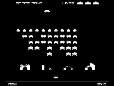

Just for fun, threw this together this morning. Space Invader animation, with two of the alien characters. Very basic, but proves the Maximite has more than enough speed for the full game if written in MMBasic.
10 FONT UNLOAD #4
20 CLS
30 FONT LOAD "SPACE.FNT" AS #4
40 FONT #4
50 X1=1:X2=50:XStep=2
60 FOR Y=1 TO 200 STEP 5
70 FOR X=X1 TO X2 STEP XStep
80 LOCATE X,Y : PRINT "010101010"
90 LOCATE X,Y+20 : PRINT "030303030";
100 PAUSE 100
110 LOCATE X+(XStep/2),Y : PRINT "020202020"
120 LOCATE X+(XStep/2),Y+20 : PRINT "040404040";
130 PAUSE 100
140 NEXT x
150 IF X1=1 THEN
160 X1=50 : X2=1 : XStep=-2
170 ELSE
180 X1=1 : X2=50 : XStep=2
190 ENDIF
200 CLS
210 NEXT Y
220 END

  Gizmo said   Just for fun, threw this together this morning. Space Invader animation, with two of the alien characters. Very basic, but proves the Maximite has more than enough speed for the full game if written in MMBasic.Glenn
All good. Certainly programmable characters makes this possible, something I've been calling for since day 1.
Now do it for 55 invaders (that's how many there in Space Invaders), make them fire lasers, explode, move a laser base that also fire, barriers that break down, sound effects and scoring and your done!
Our simple game of Space Invaders for the Maximite!
(Or just load up Space Intruders from Adventure International on the Maximite TRS-80)
damn you beat me to it, I've created the full set of aliens, now to make them shoot, and to be able to shoot them.

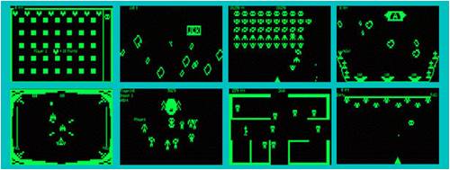

Nick, who is going to learn anything from that?

Nick
Joined: 09/06/2011
Posts: 512
Posted: 01:36am 23 Sep 2011
damn you beat me to it, I've created the full set of aliens, now to make them shoot, and to be able to shoot them.Terry
You know that the aliens are meant to move in a ripple fashion? Not as a fixed block?
Check out this youtube video to see what I mean...
http://www.youtube.com/watch?v=437Ld_rKM2s
The reason for this is that part of the strategy of Space invaders is to time your shots so that your laser misses the bottom invader and hits the ones above as the invaders 'ripple march' into it sideways. Bonus points can be awarded for this.
And don't forget the accelerating hardbeat sound which give Space Invaders it's psychological stimulous as the number of aliens move faster the less of them there are.
...not to talk you out of it or anything!
