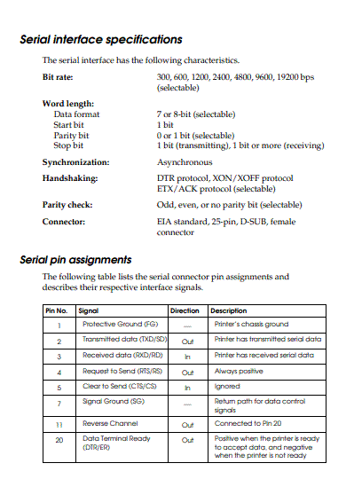

G'day Guy's,
Well after trawling thru page after page looking to see just how many code examples there have been and I do have not very many at all I came across this old thread. So I had to go upto my shed and check out those old LX300 dot matrix printers I got from the road side collection a few years ago just to see if they would worth a go at hacking and for a play see I can get a DM-mega to get some life out of it.
I found the User Manual for the printer and YES it can be driven by serial so I'm going to make a DB25- to DB-9 connector and have a play. I also found the pinouts for making the serial cable on the Epson site so it won't be a hard task to make one up. I may have to make up a RS232 board so I can get true serial data and that would a cool job for the Arduino setup. Well going from the help file to tinkering with an old dot matrix printer.... And who said these Duinomites ain't fun......
I do have atleast 3 and maybe 4 of these printers here so if I can get a bit of life out one I'll have to send one over to Don and Mick to have a tinker with
Cheers Bryan
P.S. Further reading on this printer it only needs 3 PINS for serial RX,TX and DTR(which is just a ready/busy signal from the printer) so I reckon I'm goingto have some fun with and the 'print' command could end up taking new meaning......
Edited by Bryan1 2011-12-15
