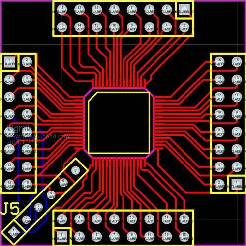

  CircuitGizmos said   I'm thinking about a minimum MM board,...... I might want to make a minimum board smaller (possibly) than the mini Maximite. (And then one with more, but bigger.)
This is as small as you can get for a Maximite!
Ok,
I am at work now... found my PIC32 Stamp design..
Note it is just a start... It needs a lot more rehashing... no caps no XTAL but is the size I was looking for...
2mm smaller each way than the futurelec one (36mmx36mm) and has SPI and would have had XTAL and CAPs that every PIC32 needs.. Pins are 4 banks of 8x2 every one on .1" grid to suit proto boards..
I like the idea of the 45degree notch to identify pin 1 on the futurelec one.

Mick,
How easy/hard would it be to add the Vss/AVss (grond) connections, Vdd, Acap, AVdd and associated capacitors and the crystal to your PCB design?
If using SMD components on both sides of the PCB, there should be just enough room to fit it all in.
And taking into account that not all the PIC32 pins need to be taken to the header pins on the sides of the PCB if the above can be achieved.
Even if the larger size was required to be able to accommodate the ground and 3.3 volt rails, a 40mm x 40mm PCB is not something to be worried about. As there are some of us designing a building I/O PCB's to suit our own projects, adding a set of headers to accommodate the Maximite Stamp is not that hard (in my case anyway).
Now that I can buy the Maximite enclosure from Altronics, I can redesign my project with the provision for the Maximite Stamp and all associated I/O circuitry knowing that I'll have heaps of room.
My original I/O PCB was designed to plug on top of the Maximite EV, so with a bit of time and effort spreading the circuit over a larger area, I'd still have plenty of room.

Hi VK,
The tracking was just a proof of concept.. to determine if the size was big enough to fit the chip..... I am sure that the CAPs and XTAL would fit if mounted on the underside of the PCB... GND and Power rails need to be wider where possible of course...
As I work in the racing industry, and the Melbourne Cup carnival is on starting Tomorrow I have no time to spend on the design at this stage but if you have some suggestions I would consider re-visiting it in a couple of weeks.. If size was increased to 41mm square (an even .2" for pin spacing) I am fairly certain I could route the tracks and have all/most components on top layer with GND shielding on bottom layer.
I would be happy to throw the artwork (done in Protel 99se) into the public domain if there was demand for it.

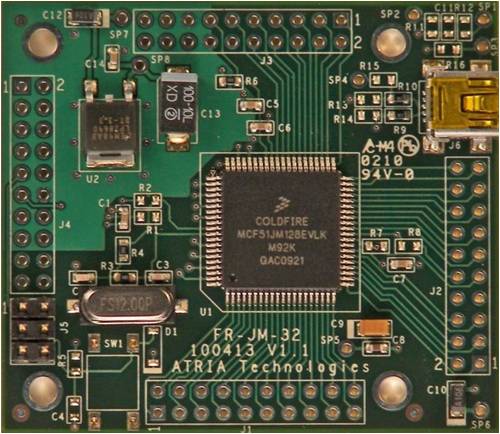

Mick,
Were you thinking of something like this board from AtriaTechnologies.com for your design?
They call it the Basic On Board.
Its based on a Freescale coldfire chip and has the StickOS, which is a Basic Interpreter similar to MMBasic, developed by Rich Testardi. StickOS also has a version for PIC32 running on UBW32 and chipKIT as well.
Atria also has several small add on boards but I think you have to wire things together. They don't stack on each other like Arduino. You can't easily breadboard them either. When you have these double row headers you are limited. I like the in-line headers like the UBW32 and mini Maximite because you can plug it into a breadboard.

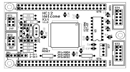

Similar to the format of this board as used in some of my projects.

  elproducts said   Mick,
Hi El,
Similar... My idea was that you `could' fit pins and plug it into a proto/vero board as all pins are on .1" grid... No power supplies or USB or other real world connections on board.
You could also just solder wires to the pins you needed and supply the relevant power and connect the lines to where you wanted for the task at hand..
For example... If you wanted to modify a certain Game console, the whole box and dice will only be 3-4mm high and could slip inside a case with minimal fuss.
It would also be a `standard' for `engine changes' if a better CPU came out a new PCB could be designed and the CPU plugged in..
As I said... it was an idea I was toying with when I designed Dons DonDuino Patch and DonDuino Cross PCBs for him.
