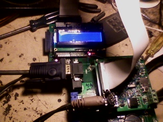

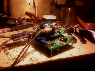

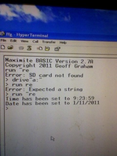

i know how it is i always like to remember the fact that i was once a newbie and its up to those who have the intell to pass it on in the long run takes a lot of "frustrating " work out of things....any way heres my ev running my rtc swhich i mounted together and well its been a blast actully filling in my time i...regards sparkey...///...///

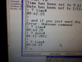

and if you dont want to add the time readout at start up :::
:: then from the prompt :syntax:: ? time$ ..hit enter it should read out the correct time ...same can be done for the date just replace date instead of time...///...///
Edited by sparkey 2011-11-02

also a nother foot note when setting time it should be in this
format ::: "12:34:00"
and for the date :: "02/11/2011"
note the syntax......

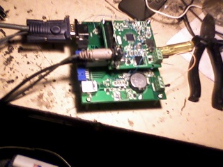

ok just found a fault if you dont run the read prog for the "rtc" it wont update the time and date so its prolly a better option to run it in your "autorun file" other than that you can just do it when u need to " from promt run the read prog then every other time you want the time on your current "session " as i call it ..every time you power down ..dont panic your "rtc" is working for you keeping the stats ..just a matter of putting a finger in to let the "rtc " to allow a read and display it...///...///
on a nother topic how long is the expected battery life for the "rtc" batt ..there are a few things to take into account type of battery standard cheap dime battery and others like the one i am using is a lithium battery i am expecting around 3 to five years depending on current drain as i said few factors involved..generally i would expect that it draws only micro ampheres ...but i have not put a meter in series with it in well lets say "maxi off mode" but i still have a nother set of components and hopfully i will be getting another "SM1" board this week some time...never the less u could not put an exact time on the battery life ....regards sparkey...///
another thing to note is when you power up your maxi and run several command line commands ..its sort of got like an in built doskey function thanks geoff very handy...up and down arrow keys ....impressed ...///
just a little tit bit for you um with the "rtc" using a couple of the i/o pins seems to me that the duino cross and lcd sheild may be also utilizing these pins so there for the "rtc" mod may have to take a step back ...i mean attatching it to the tracks that were earlier published when connecting it to the con 3 hedder ...regards sparkey
