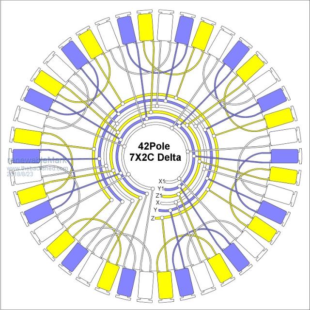

Posted: 05:46am 23 Aug 2018
Hey guys I wired a 42 pole to 7x2 star delta like the instructions as per this.
So to get delta do you connect Z to Z1, Y to Y1, X to X1
And star connect Z1, Y1 and X1 together?
Cheers Caveman Mark
Off grid eastern Melb
Madness
Joined: 08/10/2011
Posts: 2498
Posted: 06:31am 23 Aug 2018
This might help
