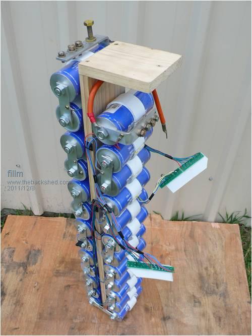

Below is an Ultra Capacitor bank I have fitted to my system mainly because of the High current that is produced buy the wind generators during gusts ( up to 4kW or 80A @ 54V+) and the solar bursts from cloud edge effect ( 45A ) trying to be absorbed by a 225A/Hr Deep cycle battey bank .
There are 25 x 3000F 2.7V Ultra caps which give me a total of 120F @ 67.5V . As my system works between 52V to 64V which the 2 x 1200W grid inverters work at , or I should say the 52V is the disconect V and the 64V is the Regulated Upper voltage set buy the dump loads and Solar Regulation, that then determines the working voltage capacity of the Ultra Cap bank .
So using the caculation ( 1/2 cv^2) to work out what the benifit of these will do to my system is ( .5 x 120 x 64 x 64 = 245760J )-( .5 x 120 x 52 x 52 = 162240J )= 83520J , / 10 = 8300W for 10sec or . /30 = 2784W for 30sec is the storage that the capacitors can absorb on top of the Battery storage. This isn't much when you have large amounts of power being delivered and the inverters do not respond as quickly but fitting the ultra Caps for this purpose is what they are designed for .
By adding more capaciors to this bank will reduce the working storage capacitance but increase the safety margin for no benifit.

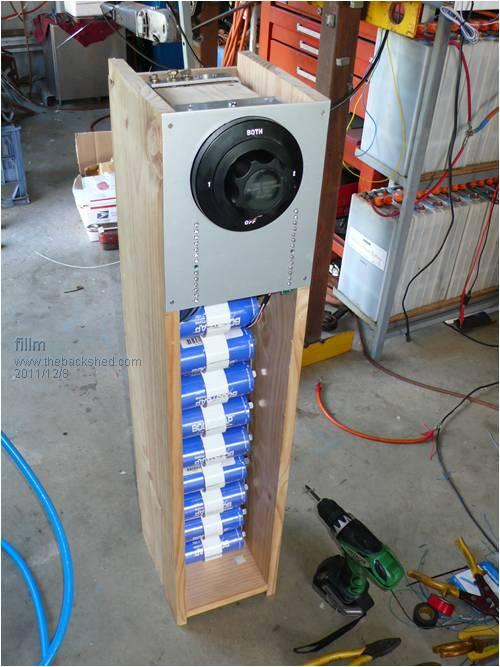

This is my Ultra Cap Bank " 25 x 3000 Farad 2.7V " set up and each capacitor electricially isolated from each other as the case is also the Neg terminal , the balancers are fitted .

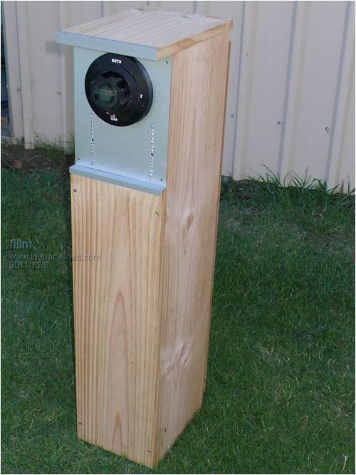

I fitted these into a purpose built timber cabnet , having them laying arround fully charged with exposed terminals is not a good idea , the power stored in these is lethal.
The finished enclosure .

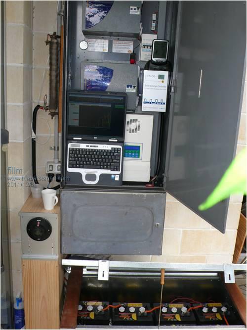

The bank in place with my existing system , I have set up the 3 way switch to be able to isolate either the batteries or Ultracaps or run on both . The leds started to light up at 43V when charging the Bank and due to some internal leakage a couple are dim compared to the others .
