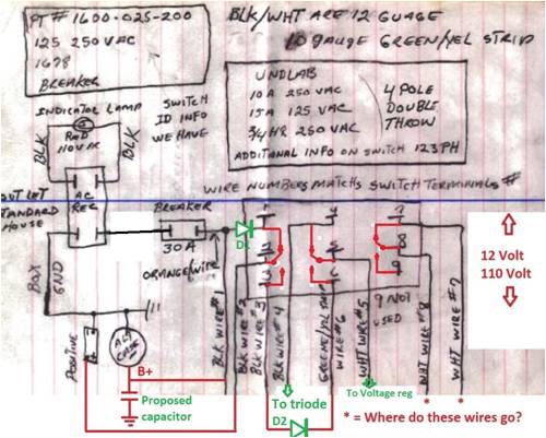

Robert,
The Pow'r Converter.pdf has numerous "schematics".
Which one is applicable to your arrangement?
And the same question applies to the Handi-Power paper.
Len
larny
Joined: 31/10/2011
Posts: 349
Posted: 03:08am 29 Dec 2011
Robert,
In one place you wrote:-
"The other side of the cap plates are connected to the frame of my machine as the outlets in my box are grounded to the case of the alternator through the frame of the generator. (What is the generator?
So the diode is to allow the use of the frame instead of adding another wire from alt ground directly to the other set of terminals on the cap and the outlets in the box.
(I don't understand this point)
My thinking is that the cap would somehow work while charging the battery and work with the high voltage output.
In other words the cap is being used like a small battery to store just enough energy to stop the engine from stalling"
But later you wrote:-
"The diode is only to stop feeding power the wrong way into the cap thus into the alternator if something is connected in reverse by accident"
So I'm confused as to what you want the diode to do.
Len

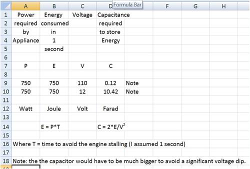

  WindyMiller said   The diode is to allow power not to be fed backwards into the cap and the B+ stud. This is if the battery is connected the wrong way by accident. Yes damage would be done either way as I have done that already once last winter. Blew the reg and fried my wiring.
No the cap was not and is not installed until I know if it will do more damage than good? If I ran an additional wire from the cap to the outlets then the cap would have no effect in the battery charge mode.
I want the cap to store a small charge to stop from stalling my old engine when connected to a low battery or a heavy 100 Volt load as it stalls the engine sometimes.
Robert
I'll be able to comment on how to connect the diodes once I understand how your system is wired.
Would it be possible to put a fly wheel on your engine?
This would be equivalent to a capacitor, but would offer the following advantages:-
1. there would be no effect on the electrics.
2. it would store more energy than a small capacitor.
Len

Posted: 11:40pm 29 Dec 2011
Robert,
I have attached a modified version of the circuit that was on page 24 of one of your .pdf docs.
I assume that this is what you have.
I have added 2 diodes to prevent reverse voltages causing damage.
D1 needs to be 63A rated.
D2 will only have to pass the field current so it can have a lower rating.
I initially added a D3 & then realised that it won't do anything, so I deleted it (as you can see near the breaker).
If you need to use a capacitor (ie. if the flywheel idea is not viable) then I'll add some simple circuitry to cope with the charging current, etc.
Len

Len, The wires 7 and 8 are not used and are tied back. Terminal 9 is not connected to any wires at all. For my alternator wires 3 and 6 are connected together. The engine I have is off a riding tractor and has a cast iron flywheel as do all small engines like from a lawn mower, roto tiller, etc. The pages in the PDF Len is the ones referring to the GM Delco 1 wire alternators. I believe it is pages 4 and 5 in my PDF. The only option I really have is a cap. I have several on hand, but would like to start with the 10 UF cap. I also have a 40 and 50 UF cap. I can also order as large as 60 UF from the surplus center on the cheap. I also want to confirm that installing a proper bleeder resistor on the cap will not cause any problems? This is to bleed the cap fast for changing out batteries to prevent any arching if the B+ cable touchs the frame. Can I also confirm that adding a MOV to the alternator from B+ stud to ground will not cause any problems? This is to arrest any spikes from loads being turned on and off that could harm the alternator diodes.
Len, you say the diode near the breaker needs to be a 63 amp? The breaker is only 30 Amp. Or is the diode supposed to be in wire 1 from B+?
Len, This system is not used for any kind of welding. I either charge batteries, or use 110 Volts DC for light construction or work around my property.
Len, Can you confirm your drawing will if used? Not cause any damage to the system, or interfere with how the switch works. 12 Volts in one mode and 110 in the other? I don't understand the diode in wire 3 and 6 where they are spliced together?
I know this must be getting tiring for everyone? But I really do appreciate the help as I am not a electronics expert, but a tinker like most of you guys on here. However I do know the basics and the dangers with DC vs AC and stuff like that. Circuit design is my weak point in this hobby.
RobertEdited by WindyMiller 2012-01-01

larny
Joined: 31/10/2011
Posts: 349
Posted: 09:53pm 30 Dec 2011
  WindyMiller said   Len, The wires 7 and 8 are not used and are tied back. Terminal 9 is not connected to any wires at all. For my alternator wires 3 and 6 are connected together. The engine I have is off a riding tractor and has a cast iron flywheel as do all small engines like from a lawn mower, roto tiller, etc. The pages in the PDF Len is the ones referring to the GM Delco 1 wire alternators. I believe it is pages 4 and 5 in my PDF.
The only option I really have is a cap. I have several on hand, but would like to start with the 10 UF cap. I also have a 40 and 50 UF cap. I can also order as large as 60 UF from the surplus center on the cheap. I don't know how much capacitance you will need. It depends upon how much energy has to be stored. Even 60 uF seems too low to me.
I also want to confirm that installing a proper bleeder resistor on the cap will not cause any problems? This is to bleed the cap fast for changing out batteries to prevent any arching if the B+ cable touchs the frame. The only effect of a bleed resistor will be to put more load on the engine. However, as I said in a previous post, you could use a relay to disconnect the resistor while the system is operating so it is only switched in when it is necessary
Can I also confirm that adding a MOV to the alternator from B+ stud to ground will not cause any problems? This is to arrest any spikes from loads being turned on and off that could harm the alternator diodes. A MOV won't cause any problems, but my understanding is that they only last for a limited period. You could use a power outlet surge protector, they have MOVs inside.
Len, you say the diode near the breaker needs to be a 63 amp? The breaker is only 30 Amp. Or is the diode supposed to be in wire 1 from B+? I thought you said that the alternator can output 63 Amp. Besides, diode D1 is not in the breaker path. It is in the battery charging path. You said you want to protect against accidental battery reversal. However, note that D1 prevents the battery supplying the load if the alternator voltage reduces (or the engine stops). Is this what you want?
Len, This system is not used for any kind of welding. I thought you mentioned welding in one of your posts. I either charge batteries, or use 110 Volts DC for light construction or work around my property.
Len, Can you confirm your drawing will if used? Not cause any damage to the system, or interfere with how the switch works. The diodes won't cause any damage, but you need to think about the point I raised re D1 above. 12 Volts in one mode and 110 in the other? I don't understand the diode in wire 3 and 6 where they are spliced together? Diode D2 is to prevent damage to the voltage regulator if you accidentally reverse the battery.
I know this must be getting tiring for everyone? No problem But I really do appreciate the help as I am not a electronics expert, but a tinker like most of you guys on here. However I do know the basics and the dangers with DC vs AC and stuff like that. Circuit design is my weak point in this hobby.
Robert
Robert,
I have put my comments in bold above.
Perhaps you should remind me why you need the capacitor. As I said above, I thought it was because you used a welder which has high current damands when you strike the arc. And also when you charge a very flat battery.
Please clarify.
Len
larny
Joined: 31/10/2011
Posts: 349
Posted: 10:34pm 30 Dec 2011
  WindyMiller said   Len, If you need to use a capacitor (ie. if the flywheel idea is not viable) then I'll add some simple circuitry to cope with the charging current, etc. This is the route I want to go with this. This circuitry will consist of what, some diodes, resistors, ferrit cores, metal oxide varisters?
Len, would these work for the diode you said needs to be 63 amp rated? Diodes
Diodes 2
These should do for the field diodes correct? Diodes 3
Or do you have any part numbers for parts that would work? I would prefer diodes of the round type that I could just solder and heat shrink into the wiring? However It would probably be better to use a square diode with two legs and screw the thing to the inside of the box for heat sinking purposes. Ofcourse the diode would have to be of the electrically insulated kind as the box is steel and grounded.
Robert
Robert,
I had a look at the diode links. 1 & 2 are transorbs & not suitable. Also it appears that you have to buy more than one.
Diode 3 would be suitable for the D2 diode, but it appears that you have to buy 50.
However, I'm not sure if what I proposed is what you want, so I won't do any more until you answer my previous post.
PS old computer power supplies have high current diodes in them. So, if you can obtain one cheaply, you could possibly remove the diodes.

Len, I use this setup to recharge two or more batteries for use with a power inverter for loads that cannot use 110 Volts DC. Two of my batteries are large capacity and stall the engine even when it is in full throttle. When I use the 110 Volts DC side I run anything from 750 watts of heating element to a 1HP brush motor. The heating Element and large electric motor tend to stall the engine sometimes. The motor is a pain because it is attached to a water pump and needs high torque for the pump which draws a large amount of amps constantly.
Welding is not installed currently but I am seriously considering the idea as I need welding ability for my turbine construction project. So If you want to consider this project as a welder I will go along with that approach. I could use the ability to weld now and then.
I thought you said that the alternator can output 63 Amp. yes. I also have a 105 amp stator available for the alternator if I need more amperage. Besides, diode D1 is not in the breaker path. It is in the battery charging path. You said you want to protect against accidental battery reversal. I do. I had this happen last year and it cost me a pretty penny for new regulator and wiring. However, note that D1 prevents the battery supplying the load if the alternator voltage reduces (or the engine stops). Is this what you want? The battery in the 110 Volt mode has to supply the field current for the alternator but receives no charge. I see no reason why this is a serious issue other than the voltage regulator may not like not being able to sense the battery if the current cannot flow from the battery to the alternator via wire 1?
I do notice that when the engine is off that there is 12 volts at the outlets when the switch is in a certain mode. The diode would stop the backfeed I would assume? This would be good to stop the thing from draining if the switch is forgotten and a lightbulb is left plugged in by accident.
PS old computer power supplies have high current diodes in them. So, if you can obtain one cheaply, you could possibly remove the diodes. I got a ton of these that have Fets that blew up. No problem.
60UF too small? I can get my hands on a high voltage DC cap of around 5000UF if that would work? What do you think I should be on the lookout for?
This is the game plan
1. The engine is a variable I cannot change right now.
2. I want to add a cap to stop the stalling issue which is caused by #1
3. My loads are battery charging, Power Inverter, Or heating elements, electric tools, lightbulbs. Welding maybe in the future if I can convince myself that if done with the proper gear is not as dangerous as was distilled in me growing up. Long story!
4. I know that 63 amps in 110 Volts DC the output is only 6 amps or there abouts. I can and will be rebuilding the alternator for 105 amps using new parts and the fan and back half of a 12SI as they have a superior cooling system than that of the old 10SI. This would give 16 amps in 110 Volts Mode.
5. Someday I hope to find a 6HP 3200 to 3600 RPM engine to replace my old 1750 RPM engine of 30 years of age. Engines are expensive and rare around town so I would need to order one and have it shipped in.
6. Caps and diodes are cheap if you know where to look? I know some people who can help and I will be talking to them this weekend.
Robert

Roberet,
I have highlighted my questions in the quote in red so it is easy to see my text versus your's.
I also added the note re the 63 Amp in red.
I have attached some rough calculations on what size capacitor would be required.
Note that I did not include the contribtion of the alternator. but I think it is obvious that 60 uF would be next to useless.
I suggest you ask someone to check my calculations & assumptions.
Len

Robert,
I have been forgetting to make some points about the diodes.
If you connect diodes as shown in the drawing, this will introduce a voltage drop of 1 Volt or more - depending on the current.
This will not make much difference in the 110 Volt case, but it will in the 12 Volt case.
So I suggest you consider Schottky diodes in lieu of normal ones. These have a lower voltage drop, but there will be still some effect.
Diode D1 will prevent the issue that you raised regarding draining the battery in the 12 Volt case if something is left plugged into the outlet when the alternator is off.
Diode D2 will reduce the voltage at the voltage regulator. Is it possible to adjust the voltage regulator to compensate?
In other words, can you increase the voltage output from the alternator in order to account for the voltage drop across the diodes?
Len
