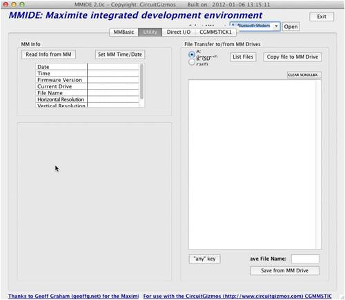

New MMIDE 2.0 c
MMIDE Version 2.0 c
Changed the way serial ports are opened (and added a button to do that). I have no idea if this helps the Mac problem or not.
Fixed the file listing issue by adding an "any key" button. :-)
Click on the row for the pin you wish to find and a dot appears for that pin.

Version 2.0 c is running without complaint on my Macs. My MM lives out in the shed and after I've done some chores I'll plug it in to see how everything works. It may be a bit tricky accessing some functions because the layout has squashed up with some controls overlapping (see screen grab). But that's cosmetic: the main thing is that it's running in Lion, which is unusual for many Mac apps these days!
I really appreciate having a Mac version because it saves me setting up a Windows window on the Mac, no big deal on the Mac Pro (I develop Windows software on it for far too much of my time) but very handy when I take my flaptop (which gets grumpy running two OS simultaneously) to the shed.
More when it happens...

We are having varying degrees of joy here. The story so far:
1. MacBook laptop (OS X 10.6) connected via USB:
Ports listed are MacPro-Bluetooth-PDA-Sync, Serial Port, Bluetooth-PDA-Sync, Bluetooth-Modem and iPhone-WirelessAP.
System Preferences | Network doesn't offer any connection.
2. Mac Pro (OS X 10.7) via USB:
Ports listed are:
Bluetooth-Modem and Bluetooth-PDA-Sync
System Preferences | Network offers "Maximite" as a network connection, but it's shown as a phone modem and therefore requires a phone number, account name and password. All the settings are related to a phone modem so it's unlikely there'll be much to offer in that department.
Clearly there's some kind of contact on the Mac Pro, but there seems to be no intelligent life as we know it down there. I wouldn't spend time on the cosmetics until we actually have communication.
I'll be unable to do any more tests until Monday but will be happy to try anything else that may help after that.
Bruce

I'm unsure of whether it's likely to illuminate where the Mac version of MMIDE is losing the plot, but when I ran the Windows version on the Mac using VirtualBox (an excellent and free environment from Oracle that runs Win/Mac/Linux on any Intel-based system) the following error message popped up when I clicked on the Select MM port "Open" button:
"An exception of class OutOfBoundsException was not handled. The application must shut down."
I hope that will shed more easily-traced light on where the express is leaving the track.
Bruce
CircuitGizmos
Joined: 08/09/2011
Posts: 1427
Posted: 11:04pm 08 Jan 2012
Bruce: Before you clicked on the "Open" button, was there a serial port in the drop-down box - a serial port made by the Maximite driver?
brucepython
Joined: 19/06/2011
Posts: 64
Posted: 11:09pm 08 Jan 2012
No, it was greyed out and empty.
B
