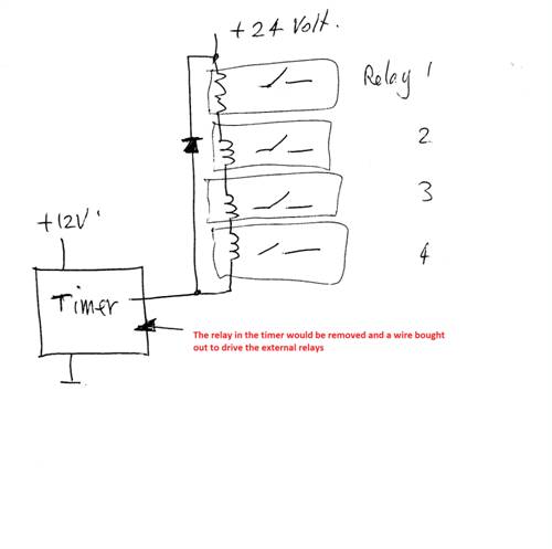

Ok, if you check the prior posts, we are running off a 12v power supply. Stepping up to 24V with a step up circuit. So the output from the timer will still be 24V. So basically how many pumps can I run off this timer. 1 X 24v pump. 2 X 12v pumps. 4 X 6v pumps?
How many volts can I pump through this circuit to run however many pumps? Do not worry about time they probably only run for 5 min maybe twice to 3 times a day.
Seperate lines - meaning pipelines E.G 2 pumps would run, 2 X 6Mtr pvc pipe (one pump per pipe)
If I can get 4 pumps running of one timer E.G 4 X 6v off 24V supply pumps then I would run 4 lines. If only 2 pumps@12v each = 24v usage on 2 lines.
Basically it's an attempt at keeping costs down by not having one timer per pipe. I don't really want to constantly mod timers for the rest of my life haha!
The other way is to just tag another 6mtr length on the end of the first and expand that way, but then I would need faster flowing pumps which may increase the price due to the Ltr per Min rating. Still working this bit out to see whats cheaper/easier & best in the long run for expansion.
The 48v thing is a question. The timer can obviously take 240v AC, but I know DC is a bit different. Curious to know what the maximum DC voltage the timer could take? I will then attempt to revolve the amount of pumps around this (Hopefully!)
Hope that helps explain better. I type fast sometimes and often end up not filling out my sentances properly so sorry if if this causes a bit of confusion. I am slack on the keyboard!

My understanding of what you have written is that you want several pumps to be switched on & off by the timer at once.
So, in other words, either all of the pumps are running or they are all stopped.
Is this correct?
If so, then your question has nothing to do with the timer, it is an issue of choosing the correct relay.
You could have one relay for each pump all operated from the timer.
The relays would be chosen according to pump voltage & current.
The timer would always be operating from the 12 Volt.
So for example, if you want 4 pumps, you could use four 6 Volt relays in series from the 24 Volt supply all driven by the transistor Q1 as I have illustrated in the attachment.
I won't comment on the 48 Volt option yet, I'm currently trying to clarify what you want.
Edited by larny 2012-02-21

  Lapsy said   It's all based on cost mate! Of course! But see below. Cheapest and most versatile are the 2 things I want.
We all want to do things as economically as possible, but beware it's not a false economy.
If you switch the pump motors using relay contacts that are not adequate to the task, or not properly protected from inductive spikes, then they will burn out - sooner or later and so it is likely to cost you more in the long run than it would if it was done properly from the outset.

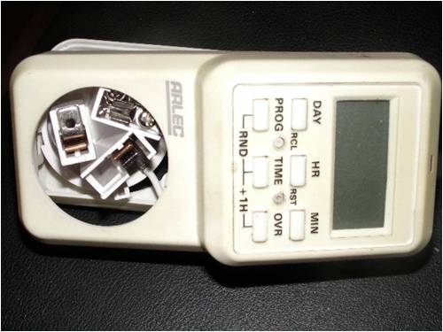

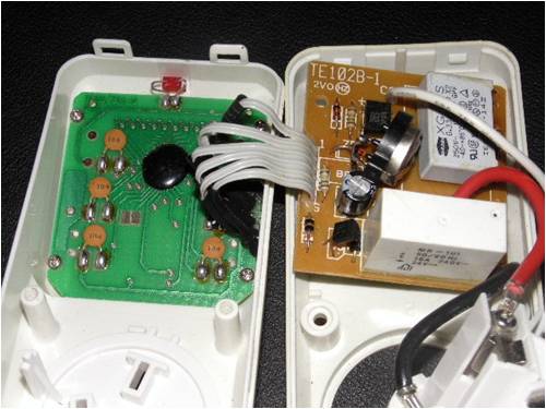

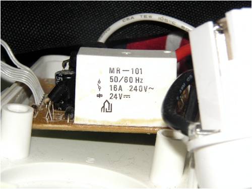

Posted: 12:06pm 20 Feb 2012
Further Pictures for reference...
Battery needs a charge by the looks of it. Was working a few days ago fully operational.
Arlec Specky stuff from their site...
Digital Time Switch
Product Details
13 digitally programmed settings – 24 hours daily, weekday, weekend & 7 day programming options. Minimum time increment 1 minute. Set with digital accuracy and LCD display. 240 volt 10 amp rating, maximum load 2400 watt. Random setting, daylight saving and over-ride functions included. In-built battery maintains program when disconnected. Packaged: Clamshell
Product code: PC787 (Different model to the silicon chip one)
This is my signature ---> Scribble, scrawl, a bit of light pencil shading, some indelable ink and a bit of caligraphy.

Posted: 08:35pm 20 Feb 2012
The spec indicates that the relay can switch 10 Amp.
The photo of the relay indicates 16 Amp.
The Silicon Chip article indicates 5 Amp: 10 Amp in brackets.
So let's assume 10 Amp.
The next question is: what is the starting current of your motors?
You can decide this by measuring the resistance of the motor when it is not moving.
Then measure the meter lead resistance by shorting the probes.
Say the motor measues 1.6 Ohm, the leads measure 0.4 Ohm, then the motor resistance is 1.6 - 0.4 = 1.2 Ohm.
So if the motor runs on 12 Volt, then (using Ohm's Law) the starting current will be 12/1.2 = 10 Amp.
