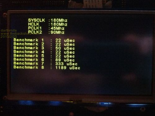

Well , i just try this benchmark on stm32f429 ...
BM1 BM2 BM3 BM4 BM5 BM6 BM7 BM8
ABC 800 single precision 0.9 1.8 6.0 5.9 6.3 11.6 19.6 2.9
ABC 800 double precision 1.2 2.2 10.0 10.6 11.0 17.8 26.4 14.4
IBM PC 1.5 5.2 12.1 12.6 13.6 23.5 37.4 3.5
Apple III 1.7 7.2 13.5 14.5 16.0 27.0 42.5 7.5
VIC-20 1.4 8.3 15.5 17.1 18.3 27.2 42.7 9.9
ZX81 in "fast mode" 4.5 6.9 16.4 15.8 18.6 49.7 68.5 22.9
Maximite 0.016 0.144 0.196 0.205 0.354 0.512 0.721 0.310
Maximite with line Nos 0.016 0.131 0.193 0.194 0.245 0.393 0.582 0.241
Maximite without line Nos 0.016 0.111 0.173 0.173 0.192 0.336 0.525 0.220
MicroMite 40MHz 0.028 0.18 0.285 0.289 0.644 0.892 1.346 0.376
MicroMite 48MHz 0.023 0.15 0.237 0.24 0.536 0.744 1.121 0.313
C-Language (code see above):
Arduino UNO 0.010 0.010 0.058 0.043 0.043 0.043 0.045 0.284
Arduino DUE 0.003 0.003 0.006 0.007 0.007 0.007 0.106 0.014
stm32f429 bm1 0.000 022
"C-Language" bm2 0.000 022
bm3 0.000 050
bm4 0.000 022
bm5 0.000 023
bm6 0.000 089
bm7 0.000 334
bm8 0.001 188
So , it appear that the chip is very fast Edited by darthmite 2015-02-26

Wow impressive stuff- are you 100% sure of these figures Fabrice?
Also can you let me know how much current the basic circuit pulls when achieving these times!

The C compiler may have optimised some or almost all of the code away.
Maybe worth posting the C? Someone may try RPi, A20, etc...

for the 100% sure ... look at the picture
Now how much current it draw ... no clue ... here i have a TFT , Wii joystick , sd card , ps2 keyboard + mouse connected ...
for the sin , cos function i use the FPU , it ... help ...
Cheers.

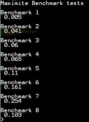

Hi ,
As primary test of MMBasic on the STM32F7 discovery board i have want see if it was fast enough.
st429 180Mhz 0.012 0.073 0.117 0.125 0.207 0.315 0.497 0.162
st407 168Mhz 0.010 0.067 0.104 0.111 0.195 0.290 0.443 0.146
MX470 120MHz MMBasic 0.013 0.082 0.135 0.135 0.265 0.380 0.597 0.174
st7 200Mhz 0.005 0.041 0.06 0.065 0.11 0.161 0.254 0.103
Not bad at all
It look like if we have a original PIC32 at 200Mhz , the result will be very close to
the st7 chip ...
You will get more info about the alpha release to the Uwe Becker (UB) page.
stm32f7 MMBasic port
I just send him the timer integration ,so you will get this release soon.
The project is compiled with System Workbench for stm32.
here the picture from the benchmark.
Cheers.
