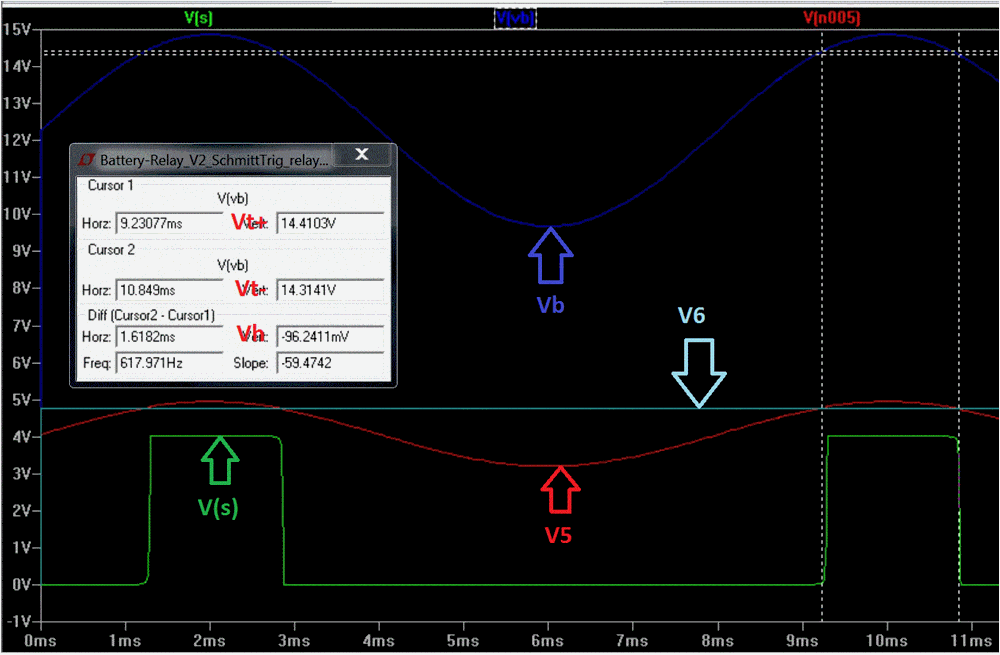

Hmm,
I have what I think may actually work!
Three pots,
1 for voltage divider off input, s.t the same circuit can be used for 12/24V with only changing the zener (or omitting it)
1 for setting Vref
1 for setting hysteresis for the relay.
The hope was that the relay could cut out below the threshold for the shunt control.
I have put a simple totem pole on the shunt fet in case it desires to switch really fast... (which it should do and does if you connect Bat+ to Vb instead of after the fuse.
Oh and I didnt include the potentiometer.asc in the zip file! No wonder you had problems! Put it in lib/sym/ or wherever.
I should improve the model so you dont need potentiometer.lib spice directive...
What do you think? I think this could be quite easily setup, esp. with say a battery charger, battery and a potentiometer as a voltage divider for variable volage supple.... if you need more than vbatt + charger to set vH then derate Ri
Should be set 12 input -> 4 at Vi
I am sure you have far cunninger ways of doing this 8)
Jasper

Posted: 01:35am 04 May 2012

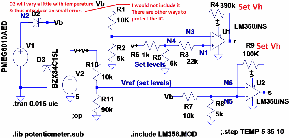

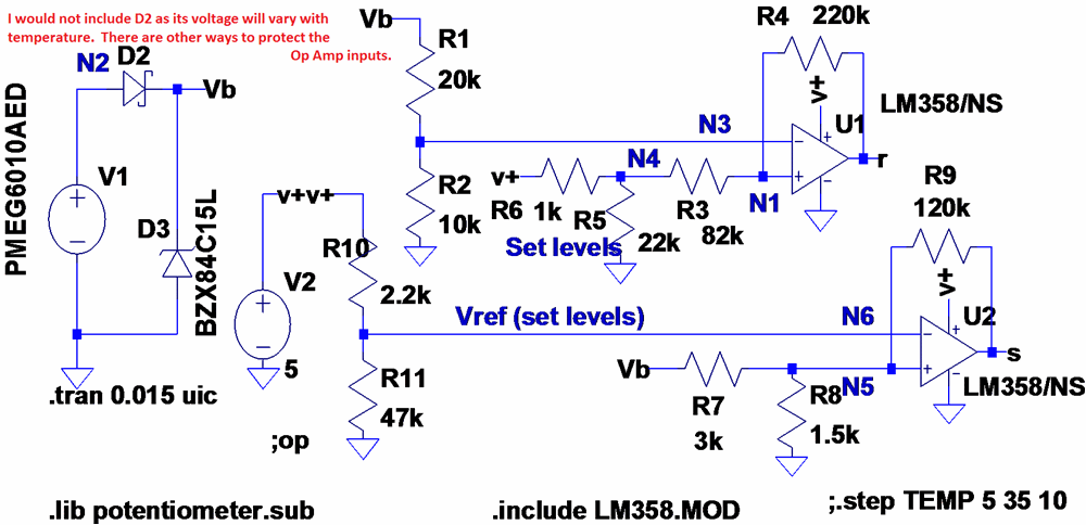

Jasper,
The pot now works thanks.
Comments on your circuit:-
1. The main issue I can see is that the 2 circuits are interlinked.
2. What is L1 used for?
3. D1 does not need to be a Schoktty diode, a silicon one such as the 1N4148 would suffice.
4. As I mentioned on my circuit, D2 will introduce a small error due to its thermal coefficient, ie. the voltage across it will vary a little with temp & thus alter your thresholds levels. The IC can be protected by other means.
See my version below. I have not set the threshold levels to what you want, but that is easy. Set the negative going threshold first, then the Hystersis.

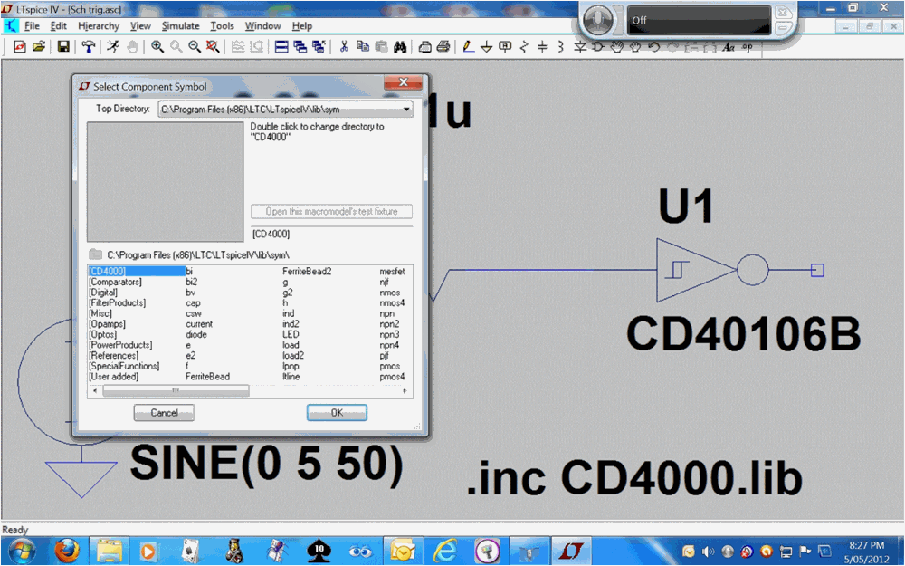

Heya Len here is the LTSpice cmos stuff. I basically agree with warpspeed. What reason is there in terms of the original brief (i.,e 20years+ operation etc) to _not_ do this and do something else?
Cmos library info
and the files for 74HCT
2012-05-04_144531_74HCT.zip

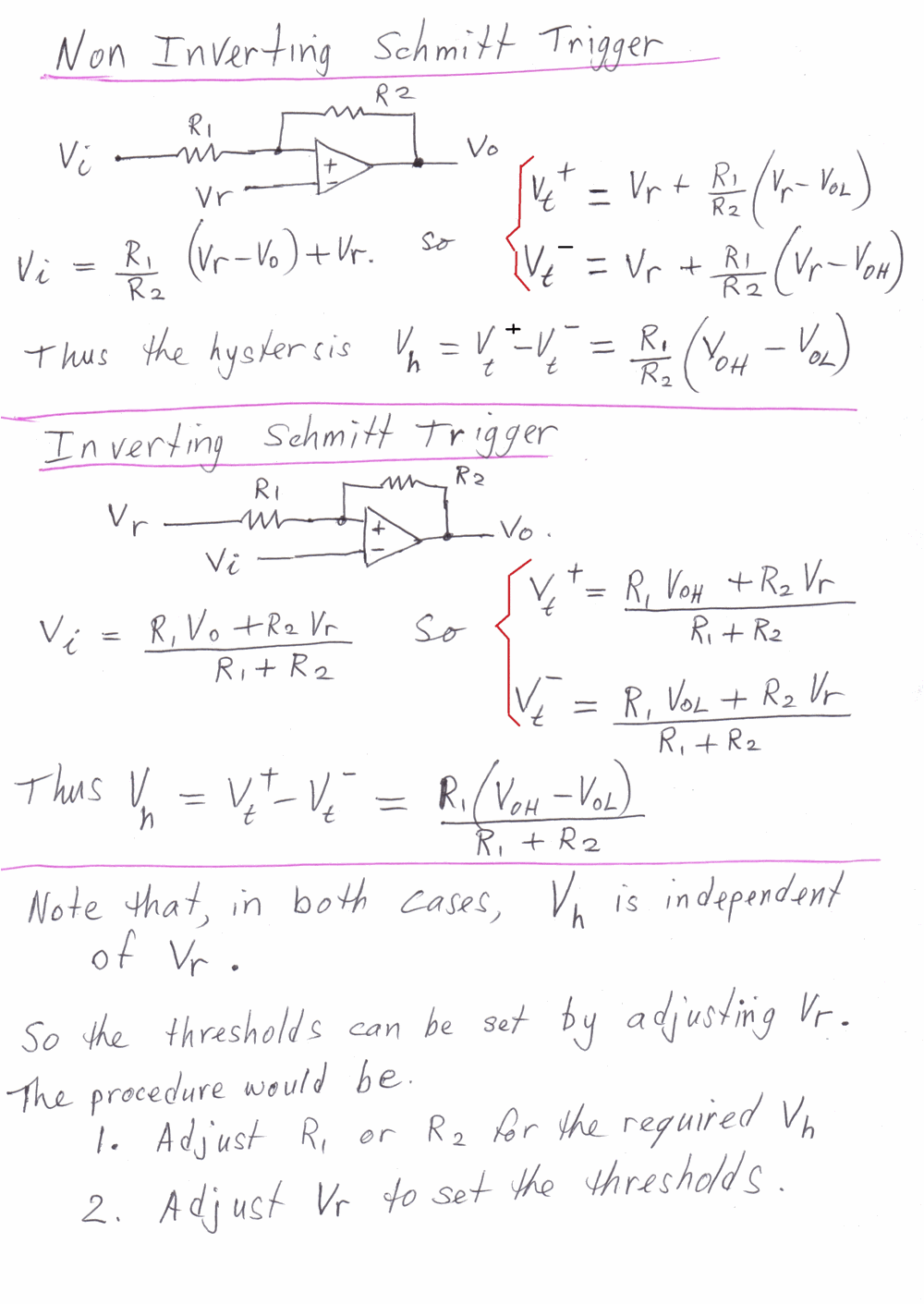

The esential point to note in the maths is that Vr is not in the formula for Vh, so you can set Vh independently of Vt-.

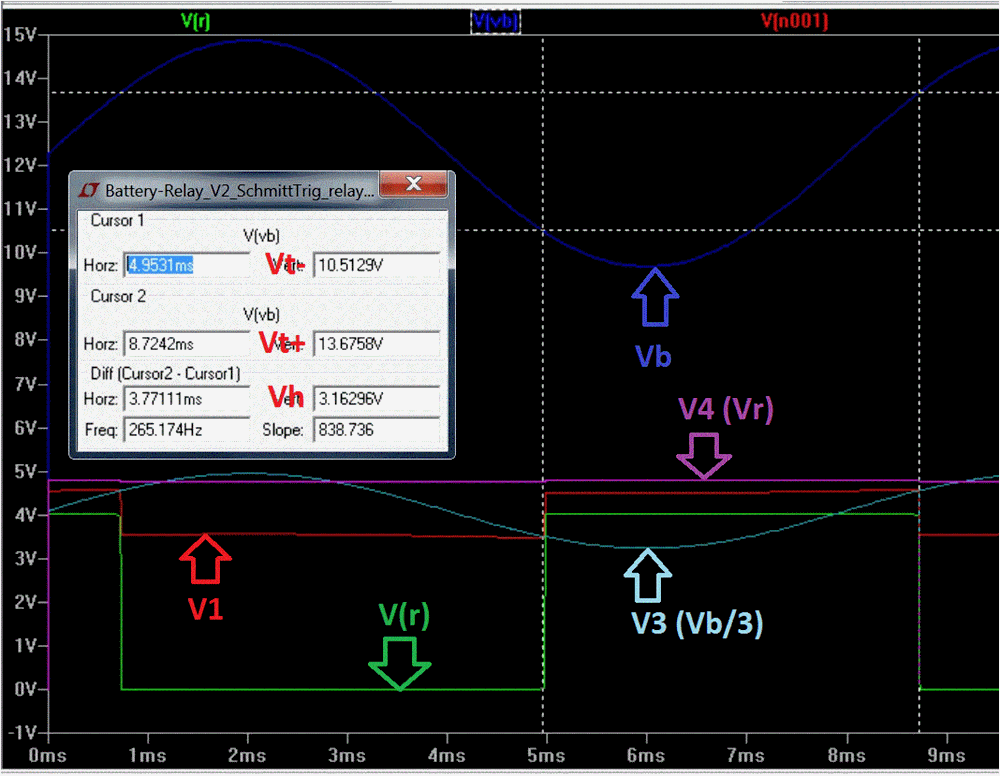

Jasper,

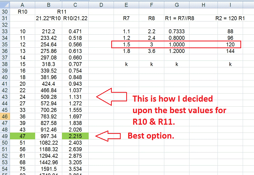

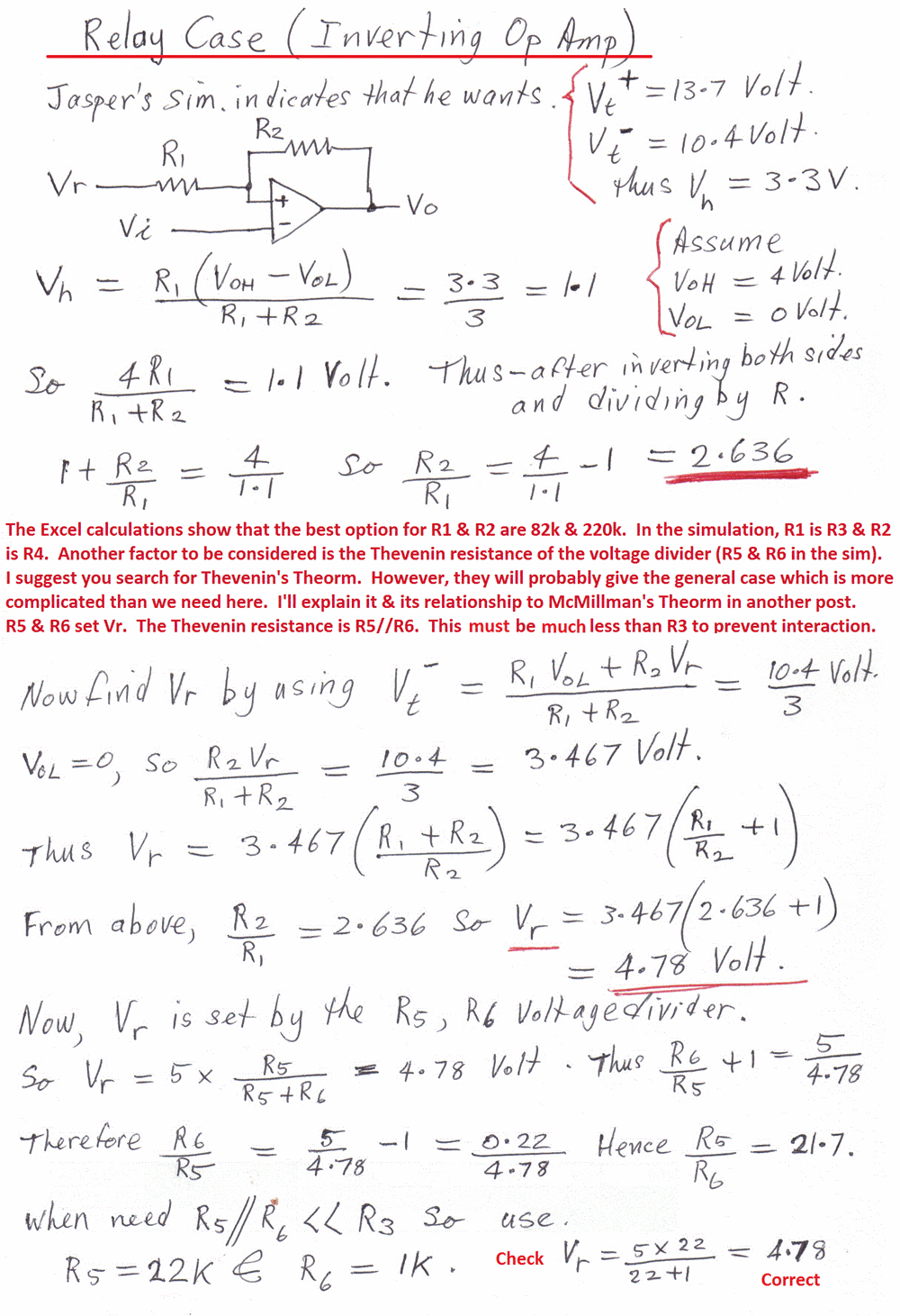

Thanks for the links, I have downloaded the 4000 CMOS & the 74HCxxx files & will insert them into my LTspice folders later.

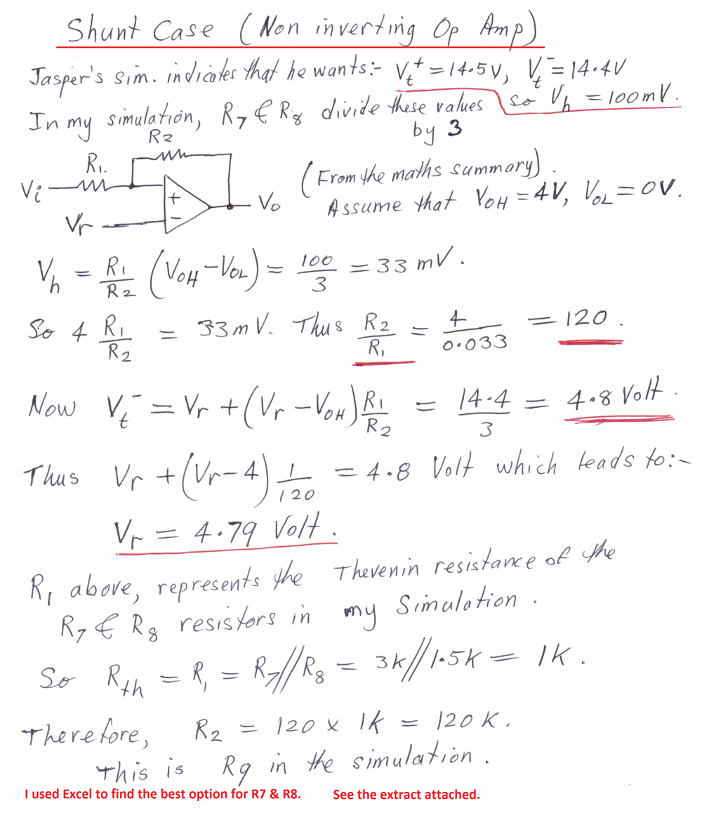

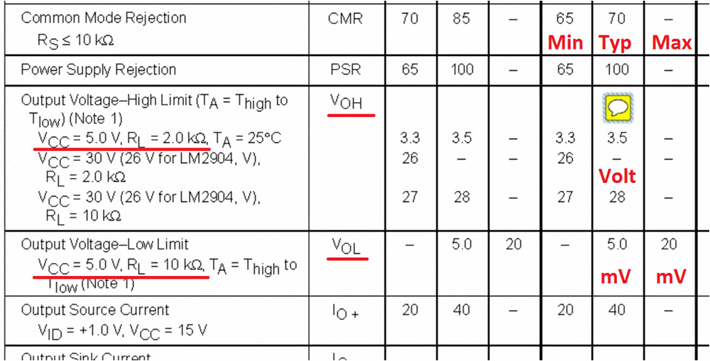

I used your simulation to discover what threshold levels you want.
I have done the maths and calculations accordingly (as below) & have used them in my latest simulation - attached below. I have included an extract from the Excel spreadsheet that I used to help with the calculations. Note that I accidentally transposed R10 & R11 in the spread sheet, but the calcs are correct.
HOWEVER, I don't regard this as a practical circuit at this stage for several reasons such as:-
1. I have not considered the Opamp's offset.
2. The Voh level may vary with temperature.
3. The + & - inputs to the Opamps need to have approximately the same Thevenin resistances.
4. I would eliminate diode D2 and protect opamp inputs by different method.
etc.
I'm mainly concerned about the shunt case since the hysteresis is so small & is made even smaller by the voltage divider. So there is little margin for the effects of temperature changes & the fact that component values change a little as they age, etc. Some further thought needs to be put into this area.
Warpspeed,
Note that I was able to calculate the threshold levels & hysteresis such that there is no interaction between the settings.
This is because the hysteresis does not depend upon the reference voltage Vr & because I designed the voltage divider formed by R5 and R6 such that its Thevenin resistance is much less than R3.
The Thevenin resistance is the parallel combination of R5 & R6 so it is just below 1k.
Therefore, any (small to medium) change to either R5 or R6 will have virtually no affect on the hysteresis.

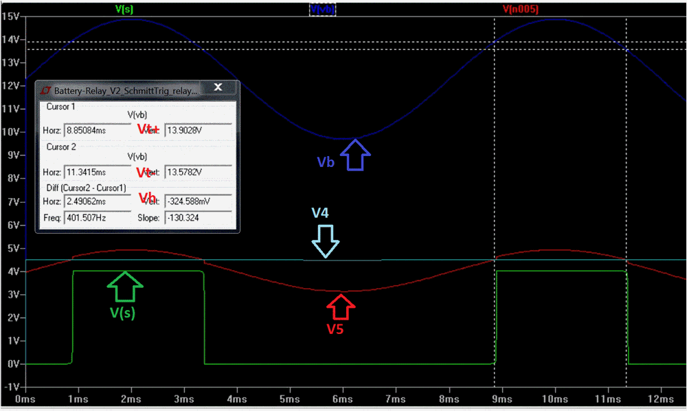

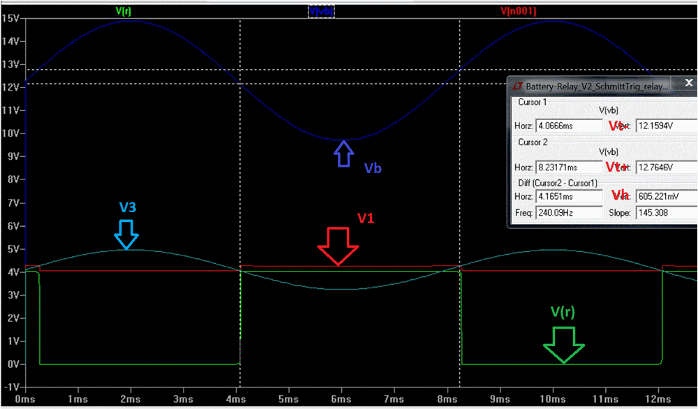

After doing the calculations, I transferred the values into the simulation & and the traces below are the result without any fiddling of values.
Regardless of whether you are doing it by calculation or by adjusting potentiometers, the procedure is essentially the same:-
1. Set the hysteresis first
2. Then set one threshold by adjusting the reference voltage Vr.
I suspect that part of your "hystersis nightmare" may have been due to the Thevenin resistance issue.

For variable hysteresis I will need a 100K pot for R3.
<You mentioned some time ago that you had a ee friend who disliked pots, even still, I need to use them here, so how can they be used to be most reliable. Out of habit when not used as a voltage divider, I always connect two of the legs. Is this good/bad etc? I havnt found much in my literature regarding this small point>
Cheers.
Jasper
Jasper,
You don't need any pots.
Just set the resistors to the values I calculated.
However, your Shunt ST has a very small hystersis (made worse due to the divide by 3 voltage divider) so it is going to be subject to component tolerances & temperature.
That is why I'm still thinking about that one.

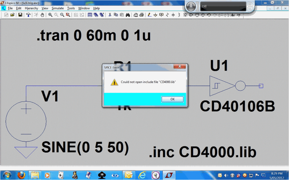

I downloaded the CD4000.lib & CD4000.zip & inserted them into my LTSpice according to the instructions in the link you gave me. But it did not work & I don't know why.
I did a simple sim of the 40106 Schmitt.
See the windows below. Do you know what the problem might be?

Len,
You do realise that the LM358 output cannot swing fully from rail to rail, and that the highest output voltage the LM358 output can reach is not at all well defined.
It will be quite different for different LM358's from different manufacturers, different batches, and changes in temperature. Maximum capable upper voltage swing is a figure deliberately avoided on the LM358 data sheet for very good reason.
They give a guaranteed upper swing, it will always go considerably higher than that, but by how much is a large unknown.
That is going to directly effect the upper hysteresis threshold voltage, and toss a big unknown variable into any purely mathematical solution.

  Warpspeed said   Len,
Tony,
Agreed. One of the first steps I took at the outset was to check the LM358 Data Sheet. Jasper - see the attachment below. It is an extract from the Motorola DS.
The Voh is as you said - unknown; however, it is good since the Vol is very low.
The LTSpice assumes it is 4 Volt. It is also why I suggested a R2R Op Amp some time ago. However there are other ways to avoid this issue.
There are also other issues.
eg. I don't believe the LM358 is fast enough anyway. That is why I was thinking about using a CMOS inverter as a Schmitt Trigger. I have not fully explored that option yet.
I have been trying to take Jasper through this in a step by step manner as I think he will learn more that way. Besides, I need the time to work through the large number of possibilities & issues. I have other things to do, so I can't do it all immediately.
I will post a suggestion for him later re a DC-DC converter. If the supply voltage was say somewhere in the 25 ~ 30 Volt region, the threshold levels that he wants would then be in the Common Mode Range of the Op Amp & so he would not need to attenuate the signal.
This attenuation is the major difficulty with his desire to make the hystersis 0.1 Volt for the Shunt case since it reduces the hystersis that the Op Amp must cope with.
One possibile solution is to use 5V6 Zeners (5V6 since they have the least temperature coefficient) to shift the level so there is no attenuation
But there is still the speed issue.
For the CMOS solution, Vcc would have to limited to 15 Volt (or 18 Volt for some ICs) thus either level shifting and/or amplification would be necessary.
Another possibilty I considered is the CMOS SChmitt Trigger, eg. the 40106, but the levels are fixed, so level shifting & amplification would be necessary.
His 100 mV requirement is not an easy nut to crack. But we will get there.

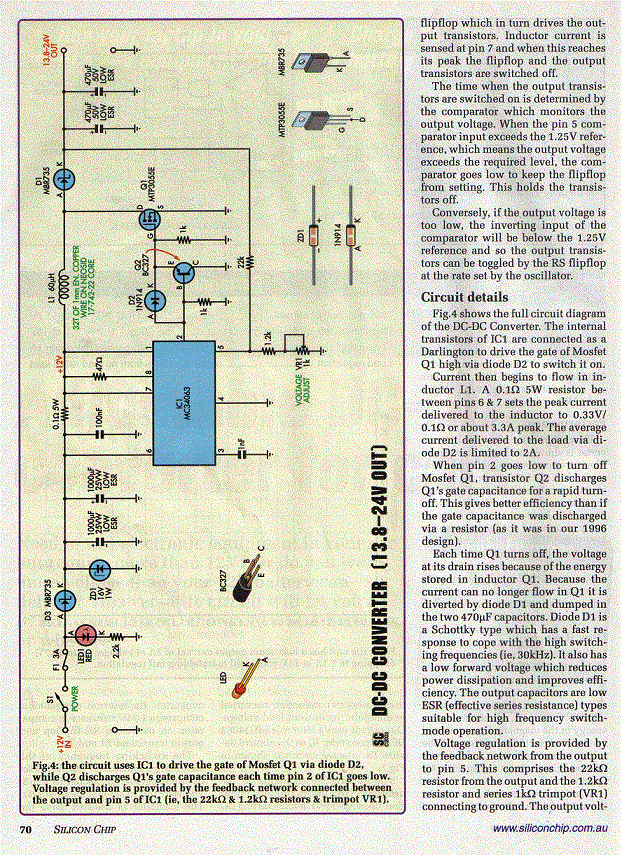

Jasper,

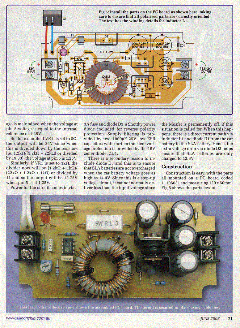

I have attached below the scans of part of a Silicon Chip article of a DC to DC Converter.
This can deliver a lot more power than you need, but that would not matter.
This will allow us to operate the Op Amp at a much higher voltage, eg. 25 ~ 30 Volt.
The advantages of this are:-
1. The thresholds you want for the Schmitt triggers would now be within the common mode range of the Op Amp.
Therefore, we don’t need the attenuation so the Schmitt trigger would be designed for a hysteresis of 100 mV. This would provide a better margin for error.
2. Changes (due to temperature & device selection – See Tony’s post) to the high level output from the Op Amp, Voh, would be less significant since Vcc – Voh will be a smaller proportion Vcc.
3. The Op Amp may be faster. But see my comment below.

You could change the voltage supplied to the Op Amps in the simulation to 30 volt & see if the transitions are sharper.
You certainly want the Op Amp outputs driving your MOSFETs to have short rise and fall times otherwise they are likely to overheat.
Do you have an oscilloscope?
