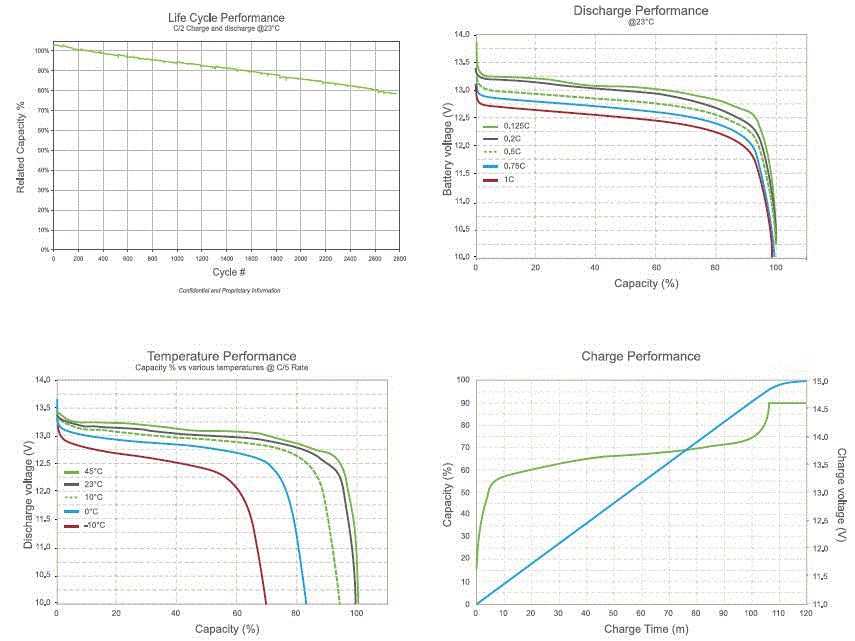

OK, I have finally worked out what has been nagging at me.
The thundersky battery pack has a very flat voltage vs state of charge curve while the Lead acid batteries do not.
Will the Lead Acid batteries contribute anything to the load while both banks are connected together?
I have this feeling in my bones that the the LiFePO4 battery bank will contribute most of the cycling and the lead acid bank almost nothing. Not sure I can back this up with a logical argument, short of visiting Klaus with an arm-full of clamp meters
Any thoughts?

Yahoo2, you are 100% correct, although this can work to ones advantage too.
The Lithium will discharge to around 70% before the lead acid starts to contrubite, but where the advantage is Lithiums dont handle going below 70% very well and doing so shortens the cycle life from around 5000 cycles to 3000 cycles, so to have the lead acid pickup the bottom end and reduce the drop/demand on the Lithiums going greatly below 70% extends the life of the Lithium cells.
In general daily use the lead acids will not be used but in the case of a few dull days and extra daily consumption where the Lithium might be drawn below 70% then having the lead acid pick up the slack is a great advantage.
If you have a lead acid bank thats getting near replacement and to use lithium for the replacement, then there is big advantages of not throwing the lead acid out and using it for assisting the lithiums and protecting them.
Think of it as a reserve fuel tank.

All gets a bit tricky Klaus,
I was given to understand that the typical voltage slope for a LiFePO4 was between 3 to 5 mV per 1% SOC (24 mV to 40mV for the 8 battery pack)so if we start at 90% the voltage should drop between 1.9 and 3.2 volts by 10% SOC. I would look at your 1.2 volt drop as showing a decrease in the SOC of between 29.5% and 48% overnight.
roughly 1.5 to 2.5 Kw would that be in the ballpark?
BUT given how much that temperature, load, chemistry, etc, affects voltage, getting a true resting voltage reading may not be easy.(even more so with some lead acid batteries in the mix as well)
3.35 volts seems like a correct RESTING volts for a thundersky that is charged over 60% SOC. The only way I can think of to pinpoint the starting SOC accurately, is to charge until the voltage starts to rise at a higher rate as you get close to 100% charge. I agree with Pete, 26.8V seems way too low for a charging or float voltage?? I'm guessing that's not what you meant.
I have to admit I am a little gun-shy of parallel banks, took me 10 call-outs over 7 months to find two faulty cells in a system with 5 banks. On the plus side, it really sharpened up my diagnostic skills

Hi Klaus,
I have had a chat with a couple of people that have some experience with winston LYP battery packs.
They both commented that with low charge and discharge rates it is possible to hit 100% state of charge and get within a few % of total discharge with conservative voltage settings.
I asked " How do I tell when the battery bank is full?"
Answer I Got, "Any voltage above 3.5 volts per cell at C/100 Amps charge current is fully charged." (that is 1% of bank capacity in amps)
Given that your upper charging limit is 7% capacity it is possible that you could get very close to 100% by the time your charger switches to float at 3.6125 Volts per cell.
They thought that getting this close to 100% full would not reduce battery cycles because it is a very slow charge, provided the pack is balanced and not held for long periods over 3.5 volts by the controller.( I guess that is determined by what amps the float stage is triggered on).
They both thought your float at 3.35volts a cell was spot on the money.
The area that they raised some concern was at the bottom end. Their view was that for intermittent and low discharge rates 3.0 volts per cell in some circumstances could be within 2 or 3 % of flat. That is not much of a safety margin if the Low Voltage Disconnect is measuring the pack total voltage and not individual cells.
It is possible for the batteries to get to 5% SOC and still be at 3.15 Volts at discharge rates under 0.1C.

Been pondering Norcold's comments about how his LiPo's are running pretty sweet, I think a big part of that is just the number of cells. Statistically the chances of an out of balance cell in an 8 cell pack is 840 times higher than a 3 cell pack.
I dug this graph up from somewhere a while ago, its from a 90Ah LYP 4 cell bank. Hope you can read it, it is pretty grainy, the low discharge rate and temperature curves are interesting.
Edited by yahoo2 2012-08-29

Each and every time the Lipo`s are charged they are also balanced, the chargers (that I have) will not charge or even detect a Li battery if the balance leads are not connected. These charges charge NiCd NiMH Pb as well as the Li families. They auto detect cell count etc. That LiPo go so low with their charge and still prove to be reliable shows how important balancing is also it seems to be a feature of the Li family of batteries. We use 2,3,4,6 cell batteries normally with some rcers using 12 or more in their large scale models.
Li batteries have advanced the use of electric motors in RC, battery and motor combos are now well below the weight of comparable glow motors and fuel.
Impatiently waiting for Li family to do this for our RE system, thus my interest and bit off subject input to this thread.
