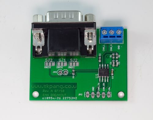

I keep seeing the MCP2551 listed for the hardware.
You might want to do a little searching on this since the PIC32 is 3.3v and MCP2551 is 5v based.
Here is one thread where someone when through the numbers.
http://www.microchip.com/forums/m621312-print.aspx
If you need a simple board to test this out, here is one I've found:
I've also seen mention of the Arduino CAN shield that uses the MCP2515 -MCP2551.
CAN shield
This is typically for devices that don't have a CAN peripheral like Arduino.
The 2515 handles all the hard stuff.
This just needs a SPI connection using the D10-D13 Arduino pins.
Since MMBASIC can drive SPI on these pins has anybody tried to run CAN with this shield?
I'm not sure I see the advantage to using the CAN peripheral on the PIC32 vs this external 2515 CAN chip option. Seems like the MMBASIC software will get more complicated and use up more memory to implement something rarely used.
While a software implementation using SPI is an optional add-on routine for those that need it.
What is the advantage to all this tear-up?
Seems like SPI to CAN could be implemented now with a CAN shield.
This is one of the reasons I pushed early on for Arduino Shield compatibilty. It allows the Maximite to expand with simple plug in shields but keeps the core Maximite simple to build and lower cost.
What am I missing?
