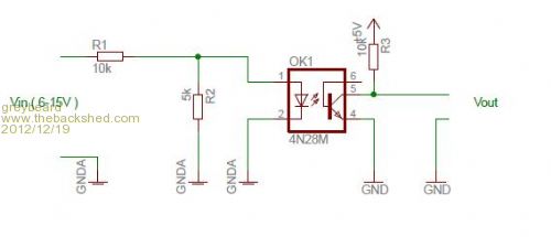

[quote] Never considered them linear enough over a big enough range to be of use in that department. [/quote]
That is true for a broad scale window of range, but they are quite accurate for a narrow window with the circuit adjusted to suit the desired range.
The problem with thermal drift becomes more of a problem with current draw rather than ambient temp, so a voltage divider at a millvolt level should pose little thermal drift.
Pete.

I built the following cct
Without spending to much time optimising values I basically tried for a reasonable o/p range ( 1-4V ) for relevant input range ( ~6-15V )
I used two different opto's to get an idea of repeatability. Input voltage left constant and opto swapped out to reduce variation.
As expected there was variation with temperature. The temperature variation was very roughly done. Basically a flat bladed screwdriver was cooled down in the freezer and then applied to the optocoupler and the variation in o/p voltage from ambient was noted. For heat a specially warmed finger was used. Not very scientific and pretty hard to repeat I know, however it gives an indication of temperature variation. Definitely a cheap option if someone uses a calibration curve,compensates for temperature and adjusts for a specific measurement range.
I'll stick with using a picaxe at each measurement point and optocouple the serial coms. ymmv
