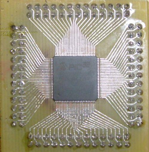

I know all this has been done a year or so ago, but I want to see if I can make all the boards and bits in my "back shed".
The PIC32 chips arrived from Portugal and I have soldered one on the break out board I made in earlier post this thread. It all looks nicely lined up thanks to a nifty little smd holding tool downwind made for me a couple of years ago. I had used it on 8 pin smd, but this time it was really in its element with the 100 pin PIC32.
The headers are fitted, now just have to make up a 3.3v power supply. Everything I have done to date has been 5vdc or higher. So here goes the next step.
Still have to make up a programming cable to go from the PICkit3 to the PIC32.
David M.

Don't forget the decoupling caps!
They need to be as close to the pins as possible.
The PIC32 is really sensitive for this especially at higher speeds.
It might work if you solder them direct to the pins of the connector (smd's should fit) as most of the ground and vcc pins are next to each other.
Edited by TZAdvantage 2013-01-26

  TZA said  Don't forget the decoupling caps!
No, I certainly won't. For years playing with TTL at around 1MHz I only used them when I absolutely had to and got away with it fairly well. However, recently I turned a PIC16F88 into an I2C 7 channel ADC and the system kept randomly locking up on me. Couldn't find any hiccup in the firmware so in desperation put on a 104 decoupler and Voila! problem solved.
Thanks for the reminder as I might have got impatient and tried it without the caps, though the PIC32 programming PDF Doc is very pointed about power supply conditioning.

@ MOBI - I am really impressed with your carrier board. I would have thought that 0.5mm pin spacing was really too fine for home-brew boards, and expected that you really would have to get a professional one like at Futurelec, as your printout or film neg or pos would not be able to get enough accurate resolution to define the tracks without shorting them out. Great work. It has made me re-think if I need to get my MM clone prototype PCB made at a factory, or for the prototype, perhaps I can home-brew mine too. Also, on the 6502 CPU - what a beast for it's time. That processor was in just about all the popular home computers, including my much loved Atari 8-bit machines,a nd the Commodore 64. Not sure what the Spectrum and TRS80 had in them - perhaps someone(or even yourself) can enlighten me. ZX81 was a Z80 processor from memory...
