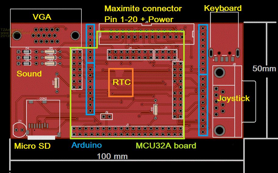

I have made some progress for the carrier board.
It measures 50x100mm. Still to be placed are the rtc, sound and a power connector and a 7805 or better regulator. If space permits i can but some support circuitry for 1-wire, CAN and RS-232/245 on the board.
The joystick is not wired yet, as i am not sure what kind of joystick it will be. I put in a 9-pin dsub as a placeholder for a Atari style joystick.
The routing is done by an autorouter, just to see if the placement of the parts is ok. The board will be fully routed by hand as that gives the best results, especially with ground planes and other sensitive lines like the i2C and SPI.
Here is a render of the board until now.
I found a nice solution for the arduino connector.
I placed it on the bottom side of the board. This will allow easy access to both sides and keeps the 'Maximite' and 'Arduino' separate.Edited by TZAdvantage 2013-02-02

Hi TZ,
That is workable,
It has the advantage that it wont foul with any connectors (VGA etc) but it makes the VGA sockets upside down if access is needed to say an LCD or switches on the ARduino,
Not too bad a compromise and keeps the PCB still small.

The challenge will be to have a good enclosure that allows it to be used in two ways.
I am designing one that has a center ring like piece of around 3-4 cm high and goes all around.
Then a bottom and cover that can interchange. The ring can then be extended when necerssary by stacking on another one, i will make them 1, 2, 3, and 4 cm. So any hieght can be made. Only one "ring" will have the necessary cutouts. The others are solid and can be used to put in your own mounting holes.

I am considering dropping the VGA connector as it is huge.
A small header in its place will save a lot of pcb area and will lower costs.
Would this be acceptable or is it a complete no-no?
I was thinking if you need a connector, you just mount it where you want and connect a few wires. It would be easy enough to solder as the header will be on a 0.1" grid and the connector is also not too small.
Thoughts?

  TZAdvantage said   I am considering dropping the VGA connector as it is huge.
Personally I think it would be a mistake, many people cant solder very well and to a DB15-HD connector it would be difficult for them.
You could always make a pinout to suit an existing cable like used to be supplied with PC m/b for VGA before they started mounting it on the rear panel. or you can save a lot more space by designing an I/O board similar to this Dontronics/Olimex module which gives all of the PC type I/O on the one PCB, (ie. VGA, Composite, Audio & K/B) You could make the header compatible with this board but the CMM is Stereo AUDIO and this is designed as MONO I/O so you may wish to do a redesign.

VGA connector must stay.
The Maximite market needs a ready made "plug-n-play" and ready to go design.
This will attract people who are not skilled with an iron or can put together electronic kits.
It will attract people who are programmers and those wanting to learn programming and this means more software. More software is the key to success else you're making another niche product for a smaller market share.
It will allow those learning about electronics to get straight into experimenting with electronics without having to know about electronics assembly to build the computer in the first place.
I'd like to see a CMM with the minimum components required to get it up and running and offer a plug in daughter board that includes all the extras for "pro" use.
The important criteria is low cost and pre-assembled... like the Rasberry Pi.

I was actually trying to find ways to lower costs.
The pcb can be smaller which will lower price because more of the same layout can be fit on a standard size board. This will also minimize cost when you need to assemble. You can wave solder or reflow more of them in one time.
Cables with connectors can be ordered for good prices, so no hand soldering is needed.
You can have connectors on top of each other instead of all of them next to each other. This will again make the pcb smaller, it will also enable putting all the connector on the back, allowing a nicer enclosure design.
This then will make the enclosure small which can make a huge difference in the final price. It is not uncommon for small series that the enclosure is as expensive as the electronics. It will be the first place to start looking for cost savings.
When you choose to make enclosures using a cnc, 3d printer or lasercutter you would minimize time to make them and for assembly.
It is not so much the material costs, but the time needed to make it.
With injection molding prices are significantly higher for larger molds, so much so that injection molds only start to get interesting when you order 100.000 pieces or more!
Using existing boxes will make it ugly and unsaleable.
Only if it is in kit form people have to solder.
Otherwise it is just a ready to use products.
