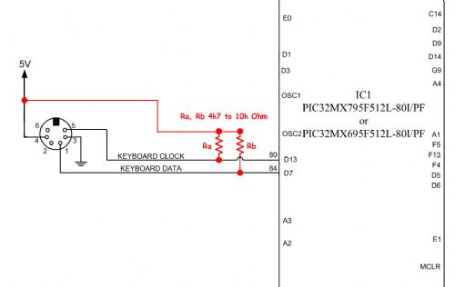

I suspect this problem is two fold.
Firstly, we have `weak internal Pull-ups'. I looked through the PIC32 data and could not find the value of these weak pullups.. I suspect they may be in the order of 40k or 50k Ohm.
And Secondly, these will be pulled up to only 3.3V not 5V.
We are interfacing a 5V logic k/b to a 3.3V logic MCU.
As the keyboard is open collector it requires pull-up resistors to guarantee a strong drive output.
I propose a mod like the following (at least to those who experience a problem)
4k7 to 10k OHM resistors added from 5V to the CLK and DATA lines of the PS2 socket.
Raros
Joined: 06/02/2012
Location: Italy
Posts: 55
Posted: 06:11pm 16 Mar 2013
I had the same problem as well with the maximite BW and I solved in part (not 100%) with 2 resistors of 4K7 OHM as he explained Mick.
Regards, Raros

BobD
Joined: 07/12/2011
Posts: 935
Posted: 11:39pm 16 Mar 2013
Graeme
There are a couple of resistors R10 & R11 near the keyboard socket which look like they could be pull up resistors. See P195 of Beginning Maximite V1.4. Check them out before you do anything rash. CG may be able to comment on this.
Bob
Oooops, I was looking at a picture of CGColorMax2 and you must have a version 1. There still seems to be a couple of something in the same place on version 1 but the photo is not good enough to see what they are.Edited by BobD 2013-03-18
BobD
Joined: 07/12/2011
Posts: 935
Posted: 11:52pm 16 Mar 2013
OK, I have confirmed that all of the CGColorMax1 & 2 have keyboard pullup resistors. See here and a quote from that page.
The PS/2 data signals are open-collector signals. When you connect the GCKEYCHIP1 to a CGCOLORMAX1 there are pull up resistors already on the ColorMax. When you connect to a CGMMSTICK1 and CGVGAKBD1 combination, the CGVGAKBD1 board already has pull up resistors in place for the two PS/2 lines. No additional resistors are needed in this case.
Although the version 1 is specifically mentioned I believe this also applies to version 2 of the CGColorMax.
Posts: 10091
Posted: 11:48am 17 Mar 2013
Yes, I spotted those resistors on my CGCOLORMAX1 board, so I asked CG in another thread if they are KB_DTA and KB_CLK pull-ups, and he has confirmed that they are, so I don't need to touch the pullup idea.
...but it was a nice idea while it lasted...
