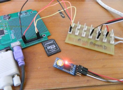

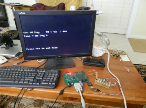

I use the Circuitgizmo's CGCOLORMAX1 with I2C sda on the sea of holes I/o socket 12 (pin6) and scl socket 13 (pin 8). Ov and +5 (3.3) self explanatory.
The setup works with external pullups fitted or not.
Are you using the MM I2C commands correctly?
I haven't checked the device you are using but is it a 7 bit address or 10bit?

MOBI
Joined: 02/12/2012
Posts: 819
Posted: 04:50pm 29 May 2013
Here's a pic of my set up.
