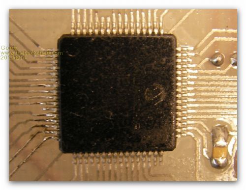

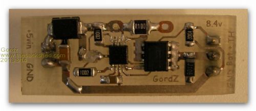

Posted: 11:40am 14 Aug 2013
I have found that the Press 'n' Peel stuff works very well. Cut a piece bigger than the pcb you are doing and use cheap laser stickers to anchor it to a sheet of paper and you get a lot of boards per page. I have used it for single and double sided boards but of course plate throughs are an issue. For QFD packs I use 'Chipquik" and heat the board on the same iron I apply the Press 'n' peel with.For the plating I got some stuff from RS which last for ages. With this system you can get very good results on smd.

Posted: 11:56am 14 Aug 2013
Here are a few examples

Posted: 11:57am 14 Aug 2013
and this

Yes, I must admit they do look good for homebake boards.
I am still not a fan of those clothes-iron based methods such as press-n-peel or toner-transfer, as they torture the copper laminate with the heat from the iron, and it can de-laminate if overheated. I guess it is all in your "Iron technique" and is OK, if you can make it work, and you only need a couple or a prototype. I have tried the toner-transfer method myself, but I was never able to make it work - the pattern never transferred, and all I ended up with was super heated, de-laminated(and useless) PCB, and an equally high temperature anger! I was using Brother toner, which I found out subsequently, does not work as they have no plastic component or something like that, that other brands of toner do, so it probably would have worked with a different brand of printer. What printer brand are you using, out of interest? I still prefer UV exposure/develop/rinse/etch and films of the artwork for homebake boards.

Posted: 12:48pm 14 Aug 2013
I use a cheap Epson laser printer because I have one :) but I have used many others too with no problem. You can get amazing results with this process and I have never had an issue with delamination etc. My iron is set between nylon and polyester. Once you try this method you won't go back to photo resist.
