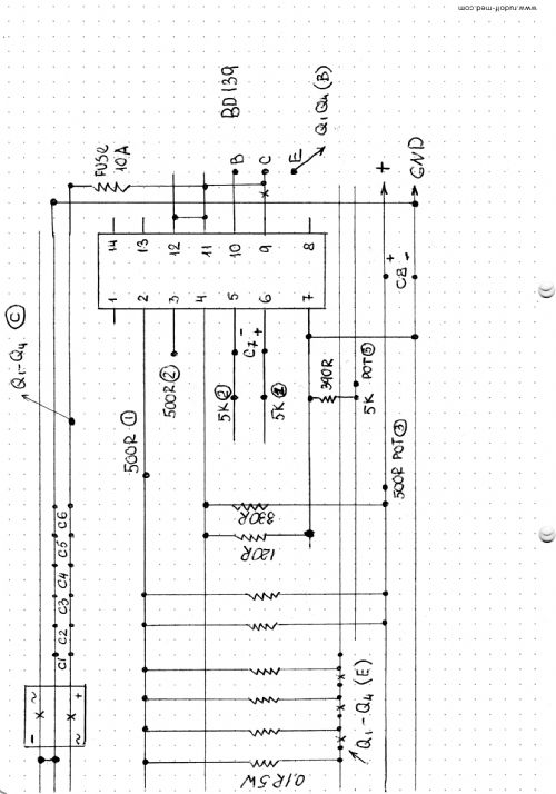

Hello,maybe we can find an error on this figure ))))
Downwind
Joined: 09/09/2009
Posts: 2333
Posted: 03:03am 13 Dec 2013
Your schematic is not that easy to follow, but its a good attempt to help solve the problem, and i think i can understand it.
From what i think you have done according to your schematic, is you have Collector and Emitter reversed in the circuit for Q1-Q4 (3055), the collector (C) should be wired to the voltage supply in, and the Emitter (E) should be wired to the 0.1R resistors, please double check your circuit to see if you have these wired backwards.
Pete.

  Downwind said   Your schematic is not that easy to follow, but its a good attempt to help solve the problem, and i think i can understand it.
Pete.
Pete i dont understand you -i have collectors on common + after bridge and emitters to each of 1om 5w resistors.whats the problem you see.

Posted: 06:14am 13 Dec 2013
Your schematic is a little Chinese in the method of how you have drawn it, and i had misunderstood it, it do look like you have it correct.
Its late here and bed time now, so i will have another look tomorrow and see if i can spot a problem.

dear Pete -honestly do not understand how a potentiometer can affect the current through the transistor., I come to the conclusion that this scheme provides a basic mistake and work can not in principle.look at this please
http://www.diagram.com.ua/list/power/power487.shtml
but pots are good Edited by novosyst 2013-12-16

In many ways it is almost the same circuit design, other than its a fixed voltage supply and the voltage can not be adjusted.
The simple fact the circuit design i posted do work and there is many people who has built it and it work for them, the owner of this forum Gizmo, built it to the posted circuit design and it worked for him to.
That tells me you have a fault in your circuit build, or perhaps a component has failed like a Pot.
The pots are used as voltage dividers to set a trip point to control the output voltage or the current limit.
If for some reason the pot has a fault or been damaged then output voltage can not be adjusted.
This is why i say test the pots, its a simple resistance test with a multimeter.
Pete.
