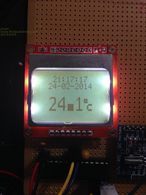

Can anyone confirm if the four backlight LEDs on the 5110 actually show as bright 'spots' (i.e. uneven backlight as appearing in each picture in this post) - or is it more evenly backlit (and the photos not doing it true justice)
Thanks for any replies!
Frank N. Furter
Joined: 28/05/2012
Posts: 1185
Posted: 08:54pm 23 Feb 2014
Hi WhiteWizzard,
the backlight is really very uneven on the 5110 but you can modify it!
There are only 4 LEDs (without resistor) on the PCB. There is enough space between PCB and LCD to assemble any diffusor (or to use other LEDs or a electroluminescence-foil).
It is very easy to dissasemble the LCD from the PCB for modifying it...
Frank

Ok I modified the code a little so now it does this
The attached code contains 3 files.
BigThermo.bas standard version
BigThermoEE.bas This version reads the fonts from a 24c32 EEprom
WriteEE.bas this will write the fonts to a 24c32 EEprom
The EEprom version will dimension the Font array to the correct size
saved in the EEprom (Last 2 address's are used for this)
Hope this helps
Jman

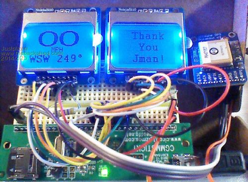

This thread took off just about the same time I got my 5110's working. With the help of a the Liberty BASIC conforum users I was able to scan and and convert Windows fonts into font files I could use. If I get the Liberty BASIC program smoothed out, I'll post it here for others.
When i finish my little project, I hope to have a Speedometer that shows direction of travel on one display, along with altitude, in vehicle and outside temperatures on the other.
Thanks Jman! Your posts on the 3110 really helped move this little project along.
--Curtis

Posted: 08:40am 25 Feb 2014
Hi Curtis
--Curtis
If you could share your Liberty Basic App to scan fonts that would be FANTASTIC
And you are more than welcome. I like the use of two screens well done
