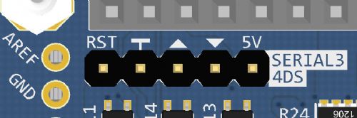

I would agree, a label like that can only mean what you are supposed to connect that to the console's TX signal. I'm so confused now I don't know if that's how the uM is labelled or not :)
Forget DCEs and DTEs, the terms have no meaning when say connecting an Arduino to a Mite. Think of it this way, have you EVER seen a chip's data sheet with say the transmitter output labelled "Rx" because that pin should be connected to the receiving pin of another device. No. You label a device according to the function a signal has relative to THAT device, not some possible thing you may plug in one day.
That said I agree that this is a confusing area at times, I always add arrows to the screen print so the data direction is clear.
In this case there was no room for Tx/Rx labels, but if you add graphics they are not required anyway.

  graynomad said
That isn't any clearer, honestly. It can still be confusing. Does the arrow that points to a pin mean data is transmitted out that pin from that board, or does it mean data should be transmitted TO that pin?
I personally believe that pins should be labelled as to their function, not the function of things that connect to them.
graynomad
Joined: 21/07/2010
Posts: 122
Posted: 03:58am 20 Mar 2014
Man we all see things differently eh? An arrow pointing to a pin means that data travels to the pin.
So in the above case, the left arrow indicates that the data is coming out of the pin, the right arrow means data is travelling into the pin.
I see it as totally unambiguous, just goes to show.
  Quote  I personally believe that pins should be labelled as to their function, not the function of things that connect to them.
Yep.Edited by graynomad 2014-03-21

Posted: 05:38am 20 Mar 2014
  graynomad said   Hah, you got us there. Maybe we have to qualify this to not include power supply signals...this is too hard.
But wait.... Your connector image above could be a connection to supply 5V to something else via a connector just as easily as to accept 5V to power that board.
Is that a reset signal to reset the microcontroller on board the device, or is that a reset signal meant to reset the device that plugs in to that header?
It isn't clear at all.
What Geoff is doing - labeling the pin FUNCTION is clear.
"That is the transmit pin. It transmits serial data."
Makes a lot more sense than:
"That is the transmit pin. It receives data from the transmit pin on the PC."
